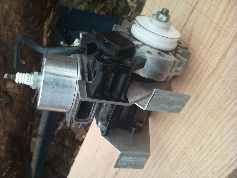

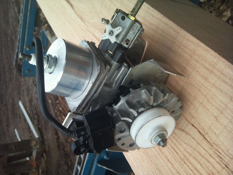

Spent the other day working on my 28cc. I machined a billet aluminum water jacket. Turned the fins off the flywheel. Made a new coil mount. Im not real happy with the mounts. Need to make some sort of exhaust adapter. Ridgerunner sugested a wa 167 carb, what about a wt 257. Im going to get it running first then do some port work.
Thanks

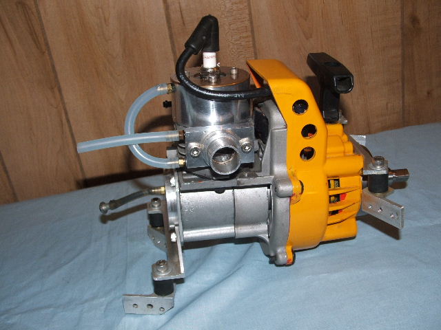

I have a modded 30cc Homelite with a carb that has the same venturi as the WT 257 and it runs great.I don't know if it would on a stock engie ,but you could try it.
Does your Mac have the kind of muffler that attaches with springs ? If it does you could buy or make a manifold simular to the one on Major Smackdown's site that's shown as a Mac CNC Exhaust under McCulloch items.I had an old McCulloch 28cc trimmer that had the kind with the springs,but a newer 32cc has a bolt on muffler.You could make you manifold water cooled like the one on the Homelite engine above.There's supposed to be water fittings and water line on the right side of the manifold,but I didn't have any in it when the pic was taken.
