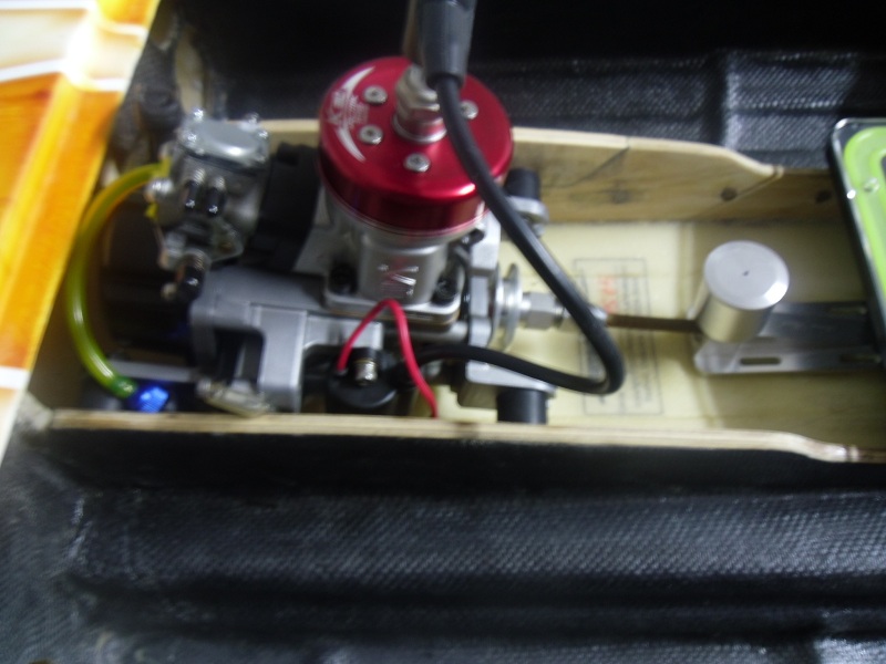

[attachment:1]C:\fakepath\P1010679.JPG[/attachment]
Gday guys just needing some help with a RCMK starter issue? i set up and bench run the motor with no problems for 8-10 tanks of fuel? i transfered the exact same run in motor in Seaducer Crackerbox and have broken 2 starters in 2 days :angry: and had the motor run in the boat (unchanged it was running sweet on the bench?) for all of about 1 minute?? if i didnt walk off i had considered torching it!! :P this boat has some sort of Voodoo as it has been a real nightmare from no set up info sent to Australia with boat all i got was a pic of the transom for setup?? :angry: and has been close to a year building it :angry: i was told buy a Zanoah ezy start? or a speedmaster Geezer pulley? any one know were to buy the later? as it seems to be a hot item as its sold out everywere
