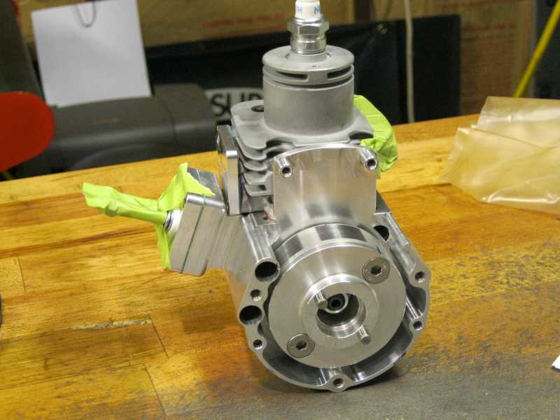

earthsurfer replied the topic: ESP 30.5cc sets new 1/4 oval timed record. But that is not saying much at this p
Since Donnie's 30.5 ran pretty good as a piston port (which will be for sale at DDM soon), I built him a reed case version, and this reed case long block for Dave Horsley to test out for racing. We have had some problems in the Florida heat and humidity with my previous set up, and Dave noticed the carb getting hot with the reed case which could cause some other problems. I hope we have both problems fixed with this new set up. Here is a pic of the reed case 30.5cc long block. It has higher compression than what we have been using, more correct port timing for the 2mm crank, a 1.5mm thick Teflon gasket between the carb and cases to help prevent heat transfer into the carb, a RCMK piston (longer skirts) to stop the bottom of the piston skirt from opening the bottom of the exhaust port at TDC (a no no for reed engines), a full circle Zenoah 2mm stroked crank from the air cooled engines (reeds like tighter crank case volume), a third bearing to help stabilize the crank a bit (which does fit the air cooled crank shafts perfectly), and a special flywheel to be able to use the shorter shaft air cooled crank. We will use the 771 carb, and of course, the QD hot pipes. This is a G290 air cooled cylinder I modified to make a PUM just before Zen came out with the PUM version, and it will look like a sleeper with the G260 Black water cap.
I expect this larger build to have very tough to beat power in the corners, and keep accelerating to the next corner (easy over 18,000rpm), and I hope the bad air quality in the Florida summer will not hurt much. We will see. Have fun Donnie and Dave.
If anybody out there has a set of TS PUM reed cases, I would be happy to build you one of these (with the bigger cap 36mm bore PUM top end kit though---of course).
Thanks for reading.
Doug @ ESP
