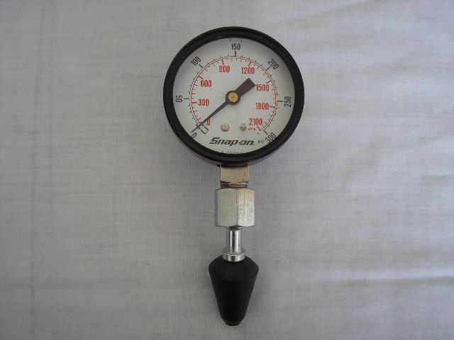

I use the tools shown in the photos to determine how good the piston ring is sealing. The Sullivan Mariner S-650 starter & the 19.2 volt Lithium-Ion Die Hard battery will turn any 30 cc size engine at approximately 4,000 RPM. A standard Snap-On compression gauge with a cone-type spark plug hole adaptor will tell you if the piston ring is doing it's job. Typical readings between 140 & 170 psi can be expected after running the engine at WOT for a period of time. I usually do this at the lake after a test session. The typical reading will be possible even though the standard ring gap for stock rings is well beyond the recommended amount of .0045" per inch of bore diameter for normally aspirated engines.
