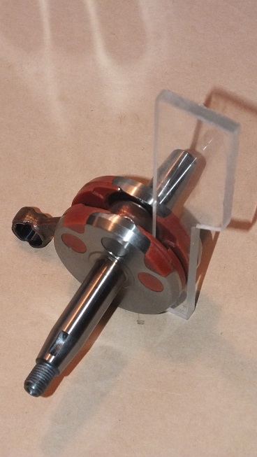

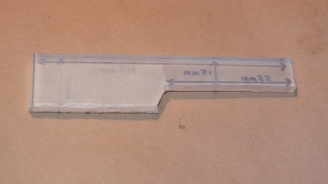

Numerous objects have been suggested for inserting into engine crankcases
for the purpose of binding the shaft and allowing the rotor nut to be installed
or removed with no risk of twisting the crankshaft.
I've seen more than one instance where random workbench objects have been
identified and used with good results. My efforts to find something acceptable

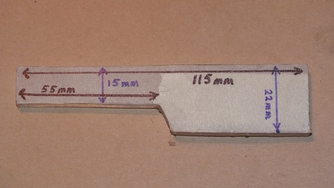

kept failing. Out of frustration, I knew a 3/16 inch thick piece of some sheet
material could allow a shim (aka stopper) to be made. The only 3/16 thick plastic
I had around was some Lexan so I started sawing away on a scrap and the pics show
the results.
- can be used to shim between the rod and the case from either side
- leaves no particles inside the crankcase like leather or fabrics can
- cannot scratch or mar any internal surface(s)
- does not crack when torque pressure is applied to the crankshaft spindle(s)
To display the sizing, I applied masking tape to one side and marked the four widths
involved. Only takes a few minutes to make with a saw. The cut edges can be buffed
with sand paper or squeegee to remove all the plastic fragments sticking to the
cuts. Could also be made just as well from other materials beside Lexan - just did
not have anything else on hand that I liked as well as the Lexan.
Since similar tools are preferred by many over the infamous "Piston Stoppers",
maybe this one should be called the "Crankshaft Stopper"???

danielplace1962 replied the topic: Crankshaft Shim
You are best to only be on the rear porkchop without touching the rod.
I use a 1/4" strip of aluminum with some extra heavy gauge industrial heat shrink of it.

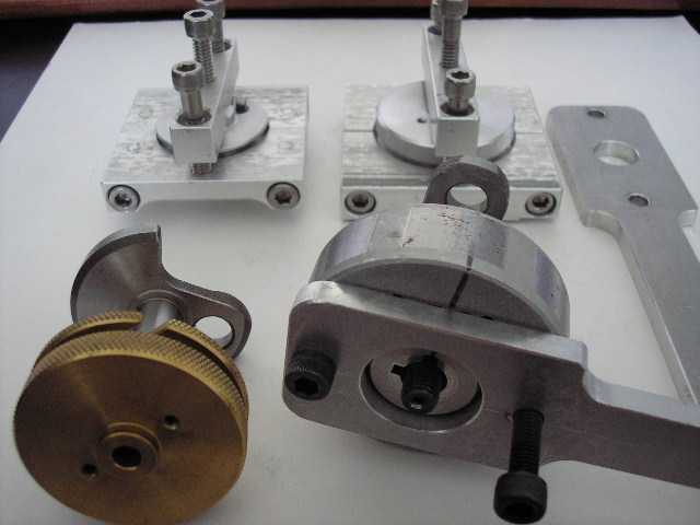

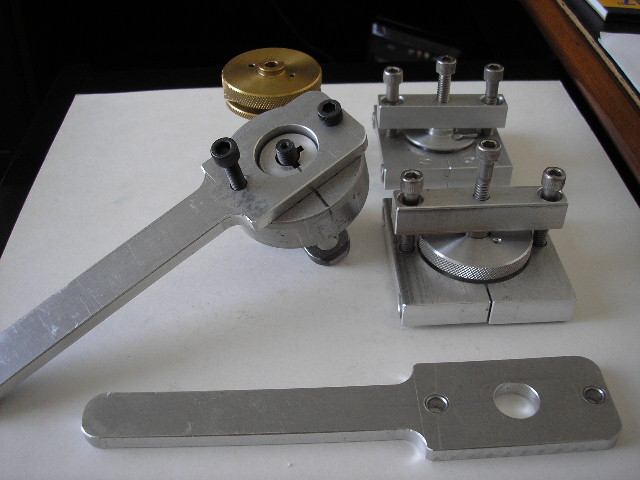

I DO NOT place anything inside the engine to tighten or loosen hardware mounted securely on tapers. The tools shown in the photos can remove & install hardware without stressing other engine parts. The split collar pullers can use the wrench type handles seen in the photos mounted to the puller when tightening bolts or nuts. Since I use Loctite & a torque wrench to install screws & nuts, piston stops or other types of devises would not be advisable.

Cool tools, JA! I will modify one end of my rotor puller and try it your way. There
is a lot to be said for never pushing on the crankshaft pressfits.

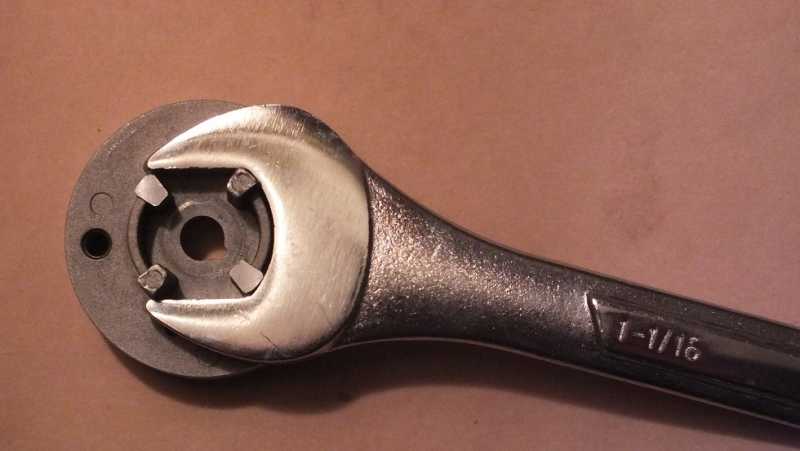

whitefish replied the topic: Crankshaft Shim

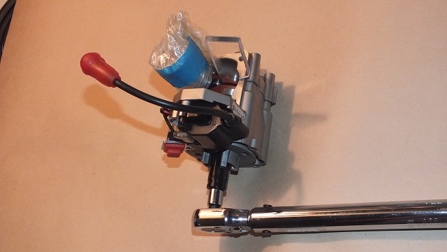

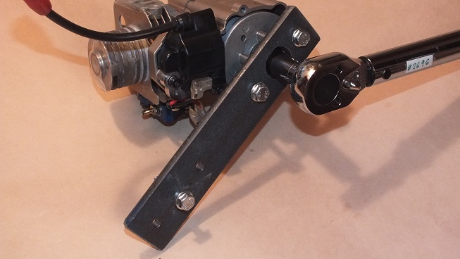

Since all forms of shimming crankshafts is questionable (especially for cranks constructed
using three pressfits) here are two more methods for stabilizing the rotor while not stressing
the cranks pressfits. These two methods are being demonstrated on the CY style rotors.
The first shows how a 1 & 1/16in. open end wrench can fit the CY's aluminum starter tangs
to secure the rotor. Works OK but a little cumbersome holding such a large wrench on a
tiny rotor. One of those "Plumber's Spanner Wrenches" could work just as well.
The second uses two machine screws passing thru a bar tool (a length of 3/16" X 1&1/2" steel
flat) and engaging the threaded holes in the rotor. By far, the more convenient method of the
two. Really makes the various shim ideas look inferior - specially since the same tool bar can
remove using one end and install using the other.
A torque wrench is used to apply 112 in/lbs to tighten the rotor nut.
