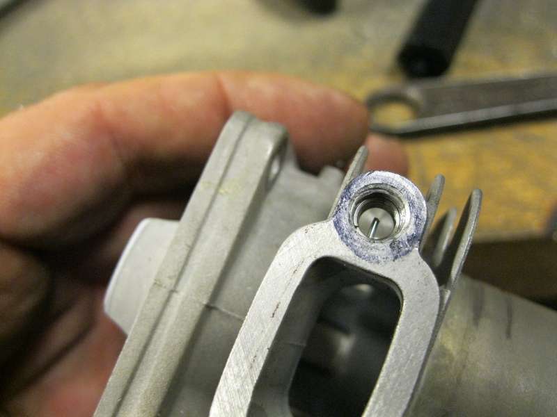

I screwed this coil in a bit too far (but will still work). The coil is suppose to be just under flush with your gasket surface.

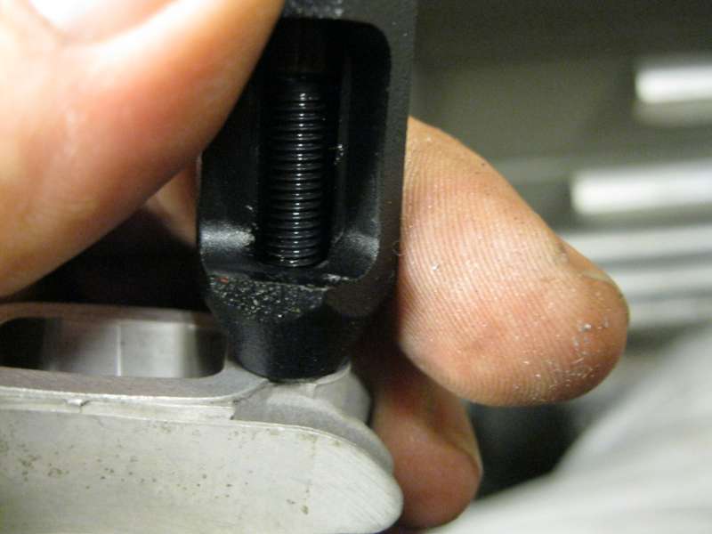

earthsurfer replied the topic: How to fix a stripped internal thread (Heli-Coil)
5) now we use the provided punch to break off that coil tab you see. It just takes a light tap on the punch to break off the tab.
#22256
Now your done, and can use the stock screw. This thread is actually stronger than the original thread. In a aero space shop I worked at (twice), all aluminum threads were heli-coiled. This sure beats buying a new cylinder.
