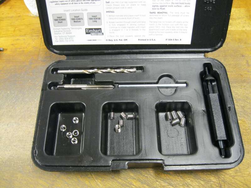

earthsurfer replied the topic: How to fix a stripped internal thread (Heli-Coil)

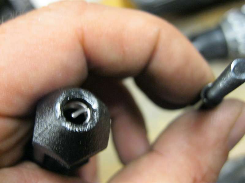

There are a couple of ways to fix a internal thread. But many times we don't have a lot of structural material around the hole, and a Heli-Coil uses a smaller drill bit than a solid insert method, to leave as much material around the hole as possible. I picked up this kit on line. It comes with 5mm X .8mm coils (made of stainless steel, so you don't have to worry about corrosion) of different lengths, a STI tap (all STI taps are heli-coli taps), the proper drill for the STI tap, a installation tool, and a coil tab punch.

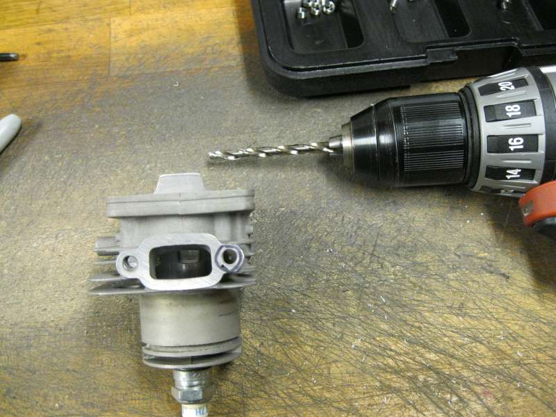

1) Use the drill bit to drill out the old threads, and make the hole the proper diameter for the coil. A drill press or a drill bushing can help keep the drill bit straight, but I did this one by hand, looking at the drill bit for perpendicularity to the surface from 2 angles 90 degrees apart.

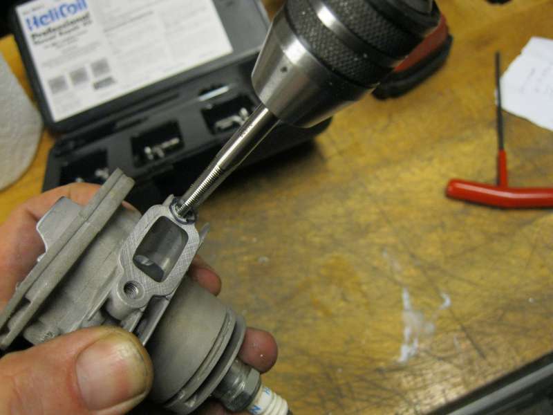

2) next, I tap by hand (same method as drilling) with a bit of cutting oil on the end of the tap.

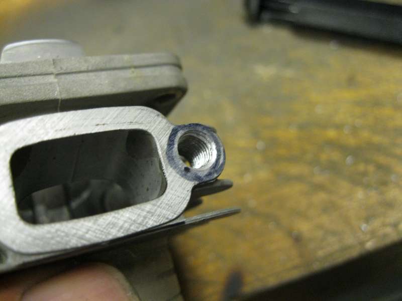

3) now I use a chamfer tool to put a bit of a chamfer at the edge of the hole, to help guide the heli-coil.

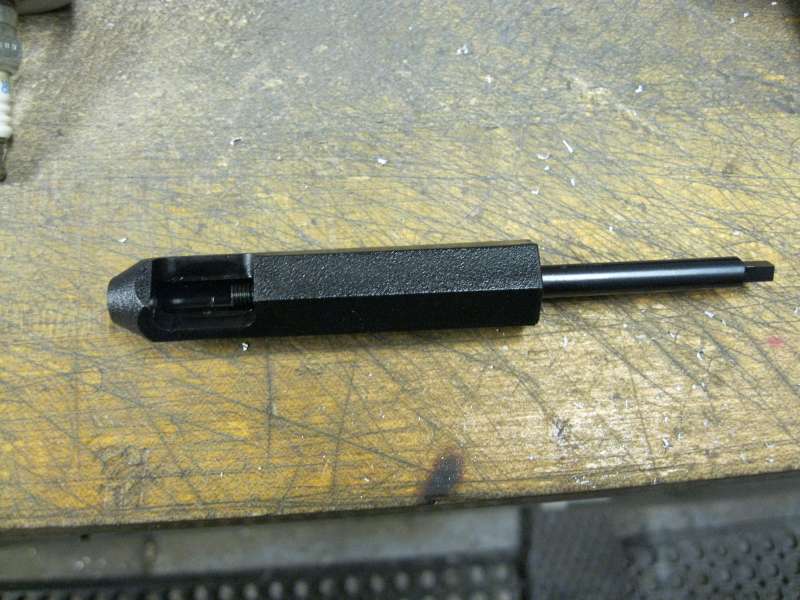

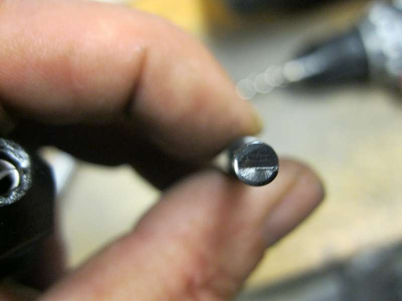

4) now I am ready to load the installation tool with my selected length coil, place it over the hole, and screw in the coil with a small wrench.
