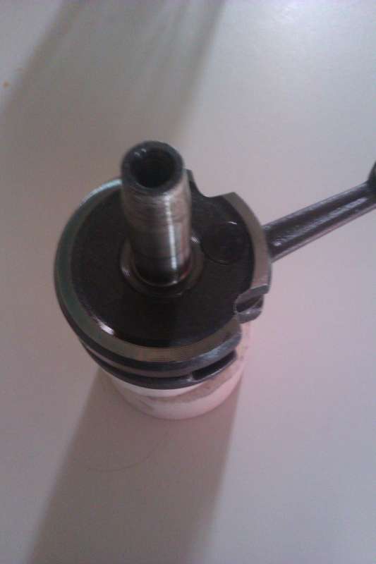

My zenoah enforcer has a full circle crank. I have read about how the "lamb chop" cranks are modded how would a full circle crank be modded?
Gordon
EDIT:
EDIT #2

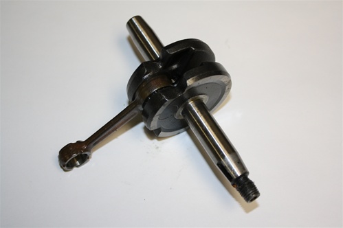

This picture is a WHH full circle crank.
Removed the air cooled crank pictures. How or can the WHH crank be modified?

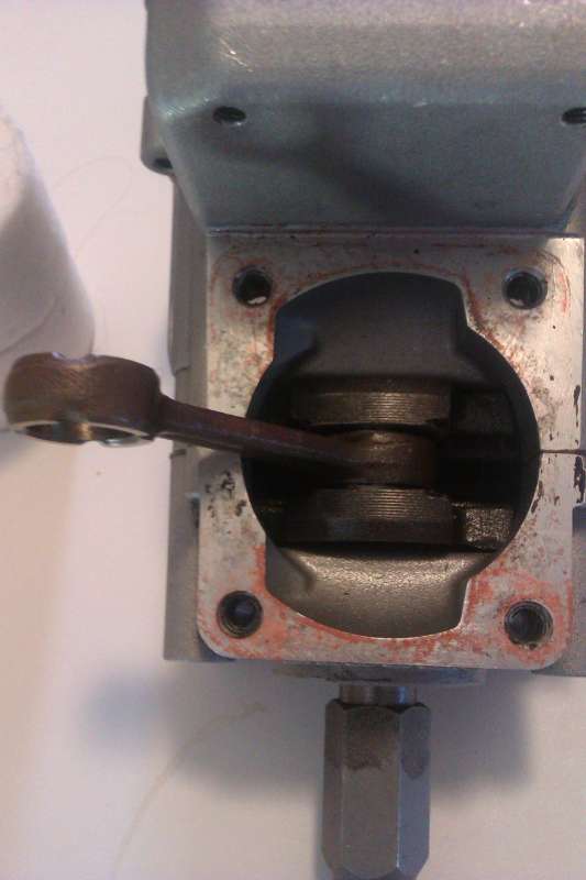

None of the engine builders waste time modifying crankshafts. If it runs true that's all you need. Any rewards would be tiny compared to the benefits. Spend time on pipes and porting. By the way, we've played with full circle versus dog bone cranks and can't find any performance difference we can measure. The only issue was when the clearances in the crankcase were reduced as much as possible. That change reduced power despite increasing crankcase compression. I believe that was mostly due to an increase in viscous drag.

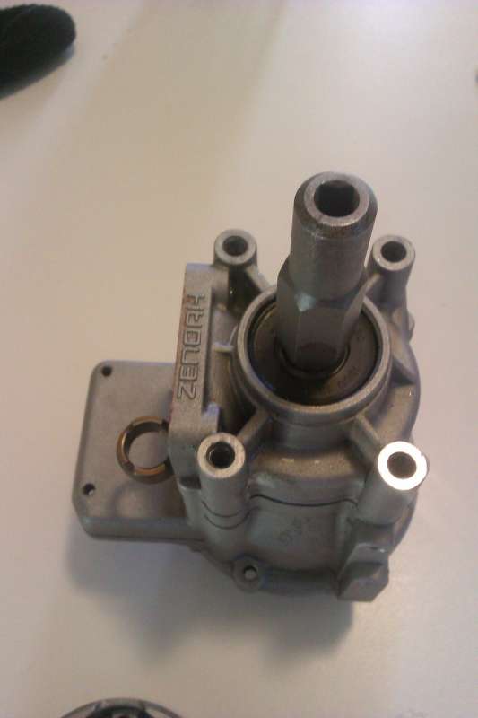

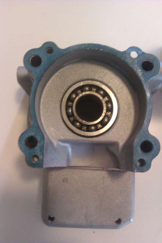

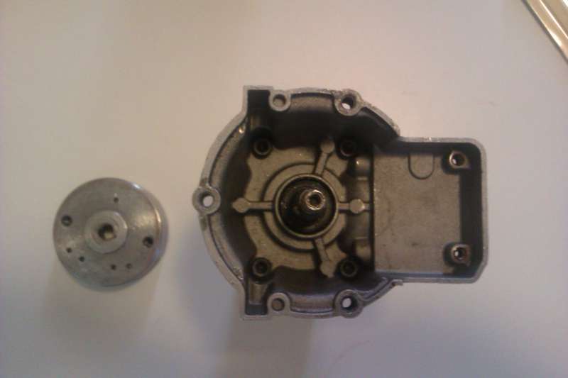

Here are pictures of my case with crank installed

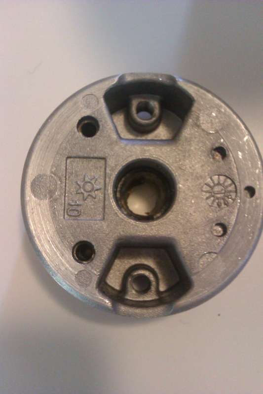

front of engine case flywheel removed
back side of flywheel

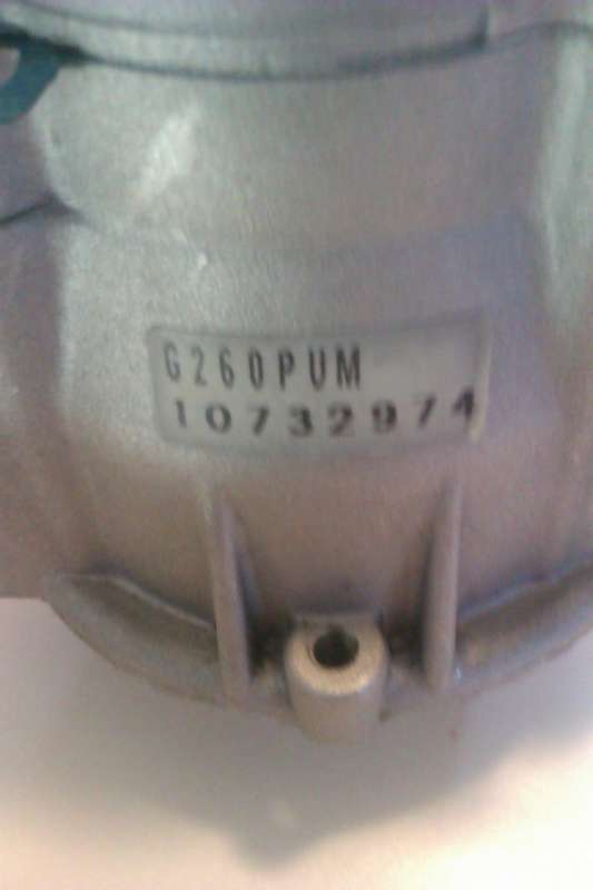

Zenoah serial number on case
My crank is identical to the one in the first post.
rear of case with flex adapter
looking down into my case showing crank and transfers
My crank is identical to the picture in the first post.

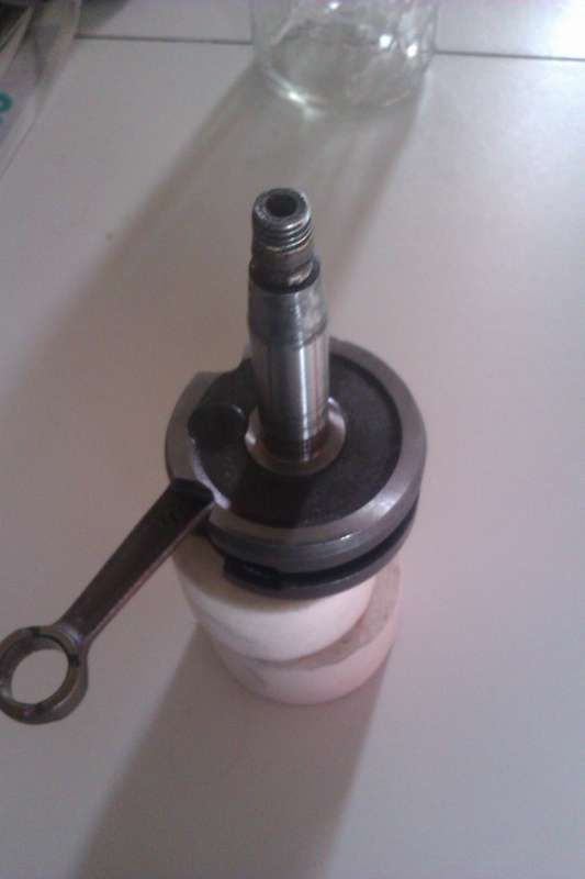

tootalltechie replied the topic: modding a Zenoah with full circle crank

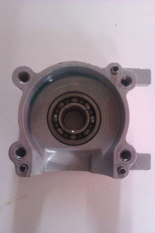

my case split into halves
my crank removed no shims
I'm guessing at this because I have not talked to Tony C, but I think one of the reasons that he used the full circle cranks is so that he did not have to use special Zenoah bearings.
