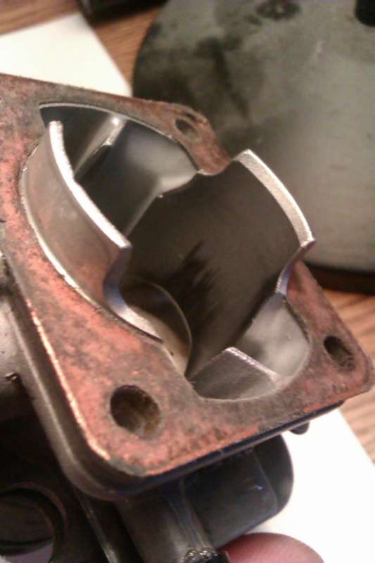

For a guy on a budget I was wondering if this cylinder is toast and use it to practice porting or should port it then use it?

I would say if there are no marks above the intake or exhaust ports, then go for it.

As Steve said, check/debur the rest of the cyld., port it and enjoy your work.
Make sure to use 8 to 10 oz./gal of quality oil.

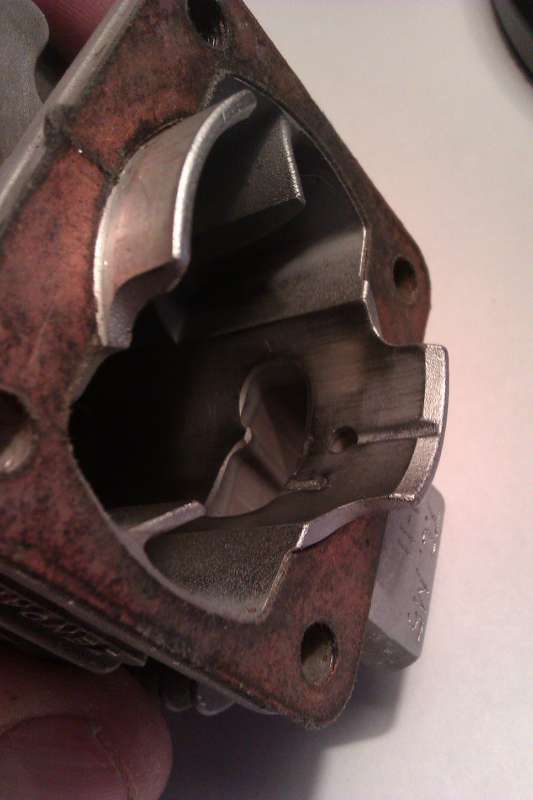

Well I did some work on my cylinder. It was easy to tell when i was through the plating. I was hard to keep a steady hand at the edge of the plating. I also did my case....found out what was too much. Cleaned my case with MEK , table spoon of JB weld on the outside and I have a backup case.

Squish currently .89mm (.035") with out gasket.
