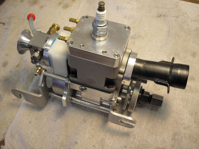

strictlybusiness1 replied the topic: What's the best gas motor for the money?
I have seven OD's in my possession. All have been carefully checked for alignment of the four bearings in their crankcases; square-ness of the cylinders bore to it's machined bottom surface & square-ness of the crankcase's machined top surface to the crankshafts axis. There is no gasket used between the crankcase sections. Also, 1/8" dowel pins are used in place of roll pins to align the crankcase haves & the cylinder to the crankcase. A properly designed exhaust nozzle & head pipe can only be found on this engine.
