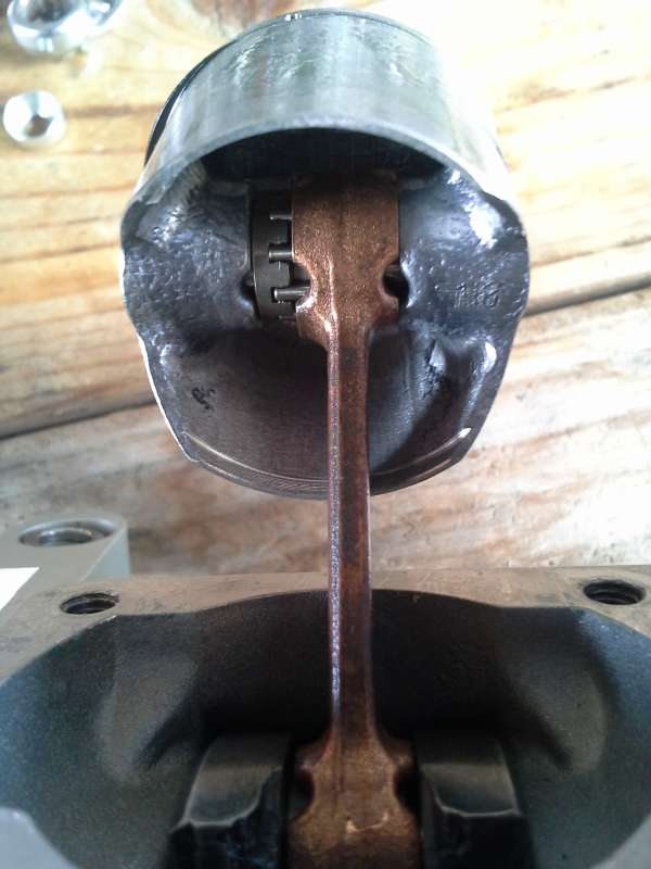

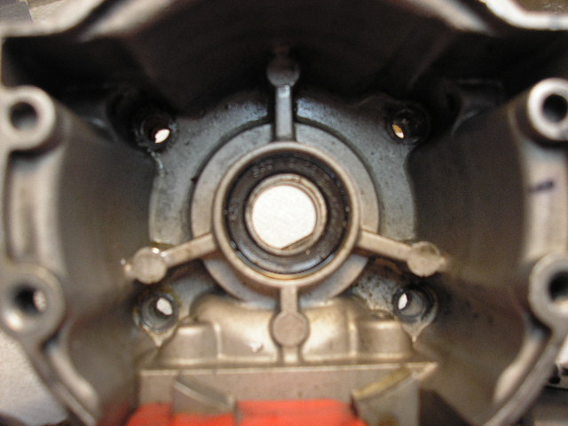

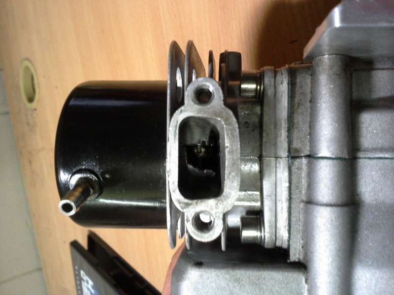

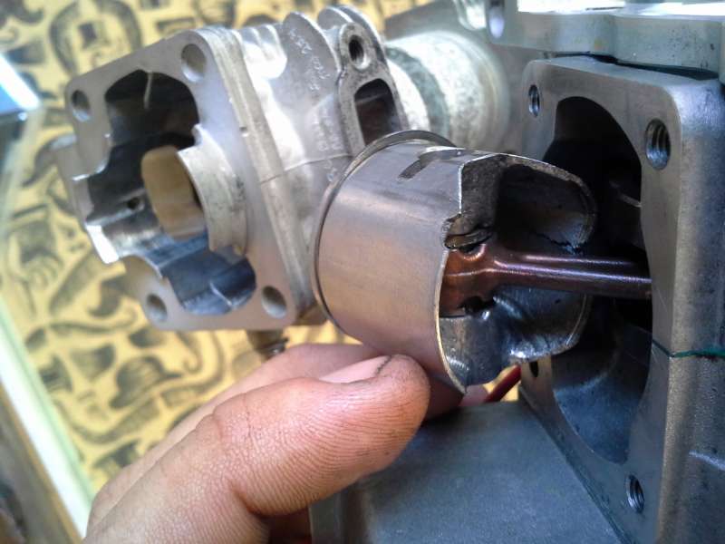

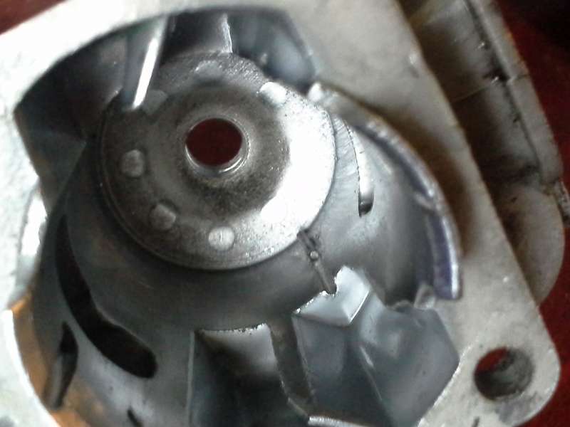

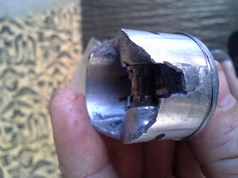

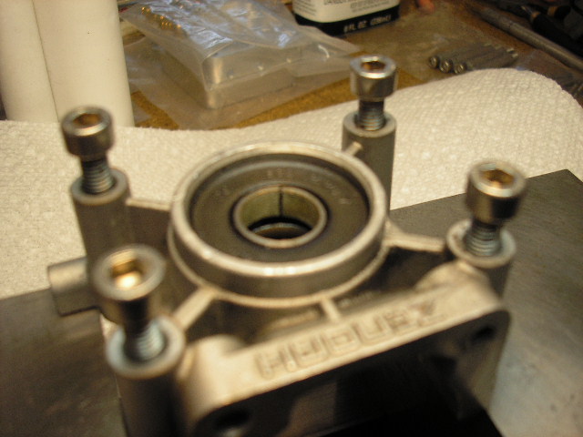

i brought 3 26cc pro mod motors, 2 stock 26cc motors,
2 modded and 1 stock, all of which failed within .5 - 1.5 litres of there life (still breaking them in),
broken cons, broken pistons, scored barrels. (all of the motors had failed bearings and no pin washers)
all of which i have had the answer back from builder was, wrong oil, water in engine.... over heating, all of which was just on one of the motors, nothing but "customer is wrong" additude.
All 5 motors were built in my opinion sub standard,
so, after all this i decided to pull apart the last of the pro mod engines before running it can anyone spot anything wrong.

I think the missing thrust washers are typical of some of the work being done by so called engine modifiers. To be an engine builder means you have built the engine from scratch. One of the surprising things is people are putting there names on very sloppy work such as what is shown in the two photos. It's a shame that people are giving their money for work that does not come close to being correctly done. This is why I believe in many instances it 's better to learn how to do you own modifications.

And for this crap they charge $595.00. I have decided to learn to do my own. Then if it doesn't hold up, it's my fault.
Your so called well known builder pays around $200.00 for an engine, then he will spend 2 to 3 hours doing what he does and then add $400.00 for that. I don't care how good he is, he's not worth $100.00 per hour.
