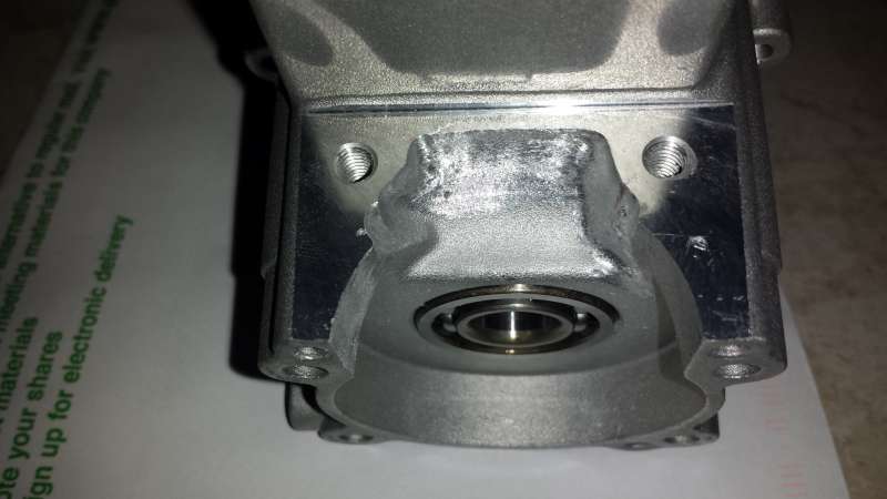

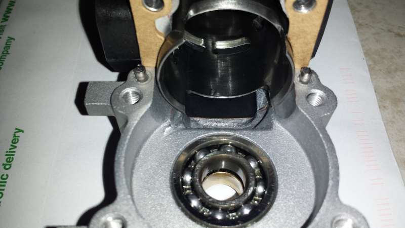

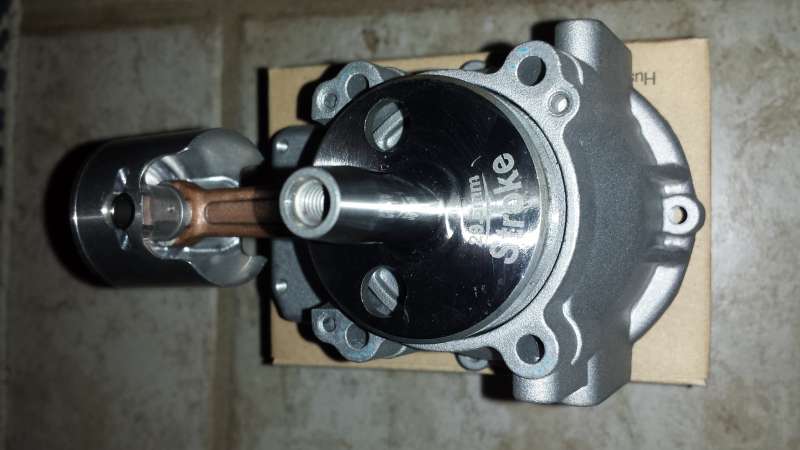

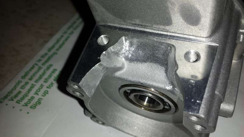

Lets see if I can pull this one off....
All done with my faithful friend the Dremel.

Rysquedases replied the topic: TK -Zenoah hybrid tease
Do you have any pics with the cylinder attached to half case with the crank and piston and sleeve installed to check rod rotation clearance and alignment. Check the widths of both cranks to figure the end play. Compare the clearance bearing to bearing in both types of engine cases also. Looks good but it's very easy to mis it's potential because of minimal misalignment and balance. Verify if rod is straight when piston is at TDC and crank is at 0 degrees.

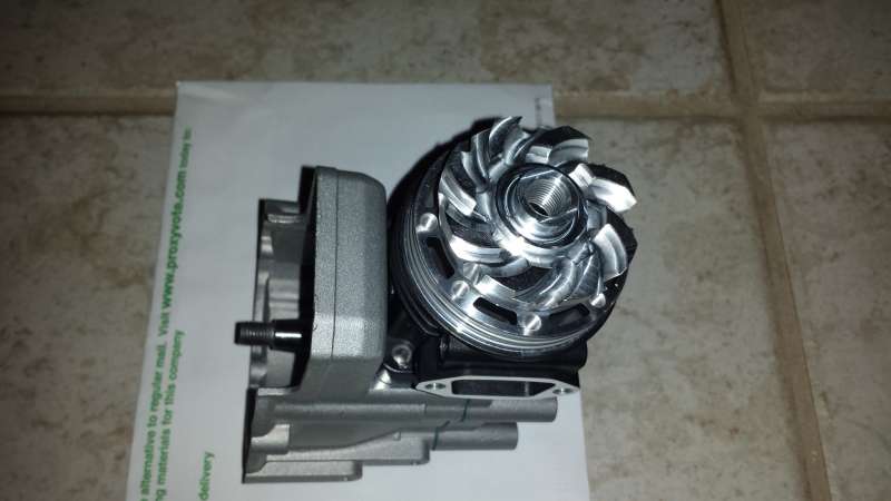

Performance Unlimited replied the topic: TK -Zenoah hybrid tease
Hiram- Are you just doing those mods as shown?
By the way where did you get that cool looking cylinder head....lol :evil:

coppo65 replied the topic: TK -Zenoah hybrid tease
looks fantastic Hiram you have done a great job

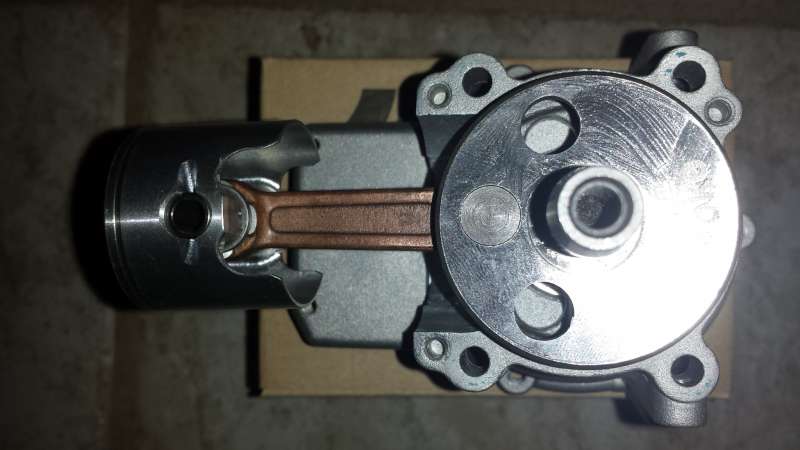

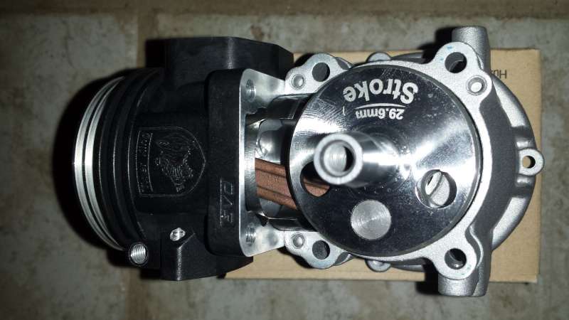

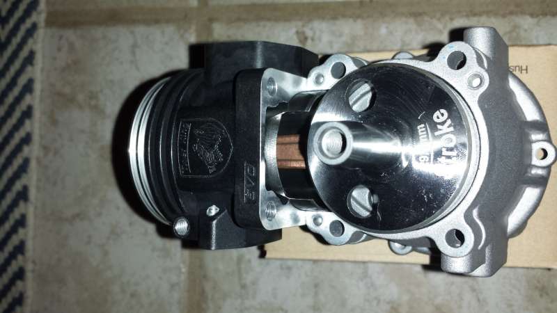

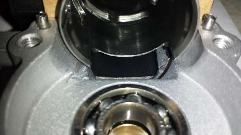

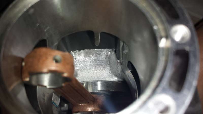

htrab1973 replied the topic: TK -Zenoah hybrid tease
Update....
#23826
looks like it needs to go a little over to the intake side or is it an illusion? you are a brave soul and thanks for sharing your build by the way. B)
