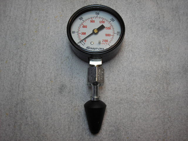

No. There is no compression until there is enough pressure behind the piston ring to push it against the cylinder wall. This has nothing to do with raising the exhaust roof. If you tested the compression for an exhaust timed at 175* compared to 195* at the same engine RPM, the numbers would be the same, providing the ring is good in both cases. I raised the exhaust only to increase the time area number necessary for high RPM power. It is easy to look a various compression numbers as the exhaust timing is raised & as the head button's volume is decreased by using a standard compression gage. At approximately 3500+ RPM the reading should be 165 to 185 PSI. Excessive lubricant can raise the reading. I usually check this after 14 to 20 full throttle runs on the engine.
