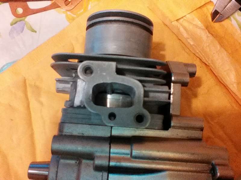

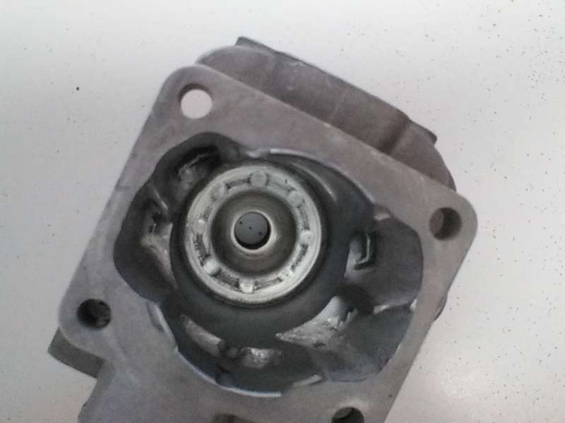

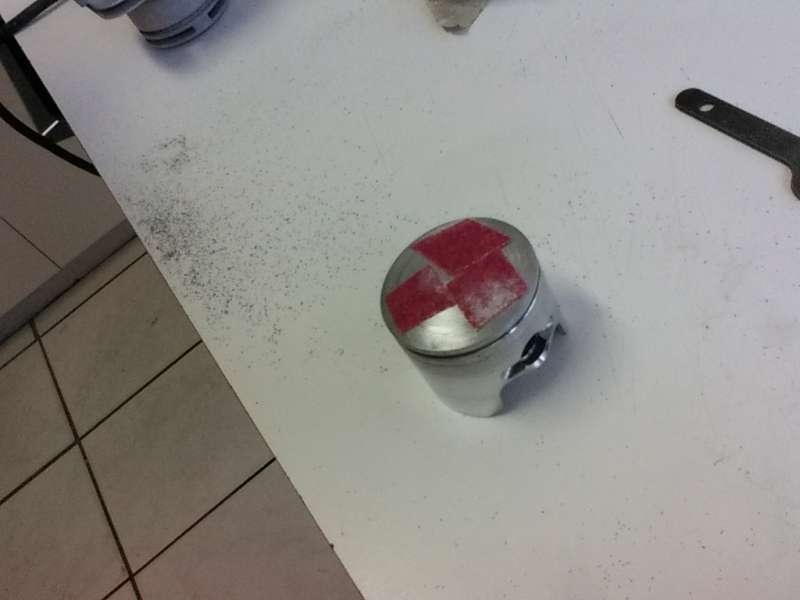

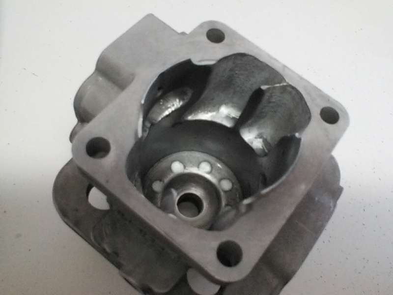

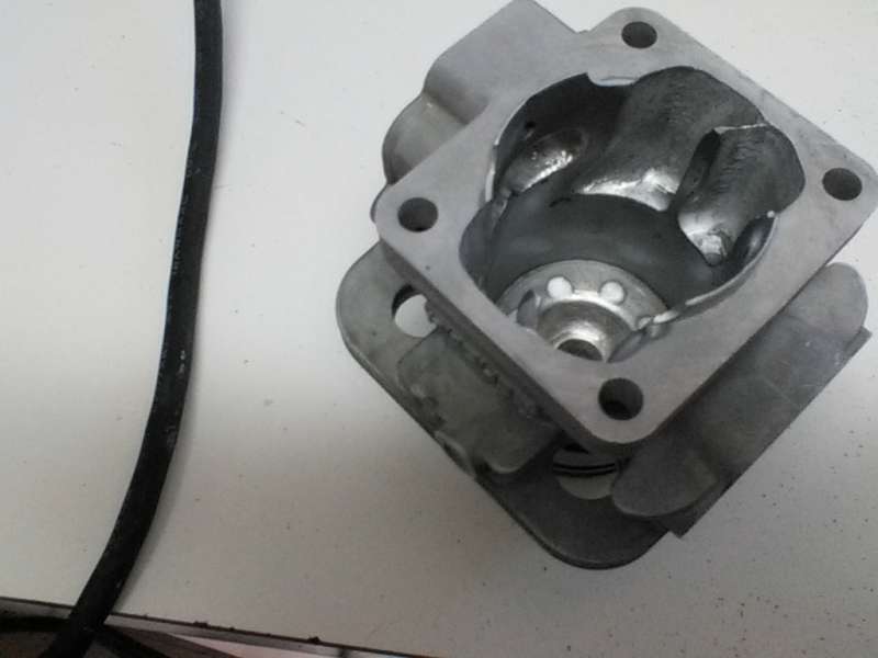

When I was in the process of adjusting the squish on a rev 28.5 using solder on both ends it was not even around the squish at all and the shape of the chamber was not uniform . After I matted / lapped the piston to the squish and and tweaked the shape is when I finally got it to its best performance to date, (using stick on sand paper, press and twist method).

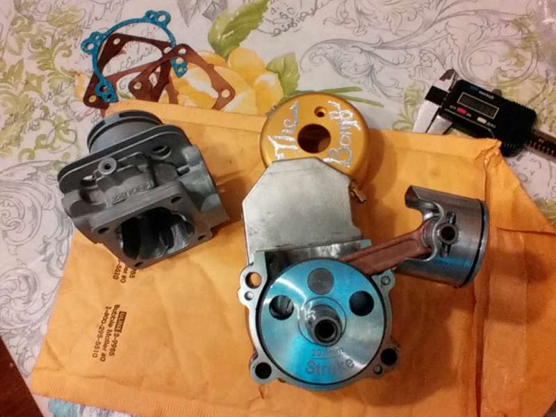

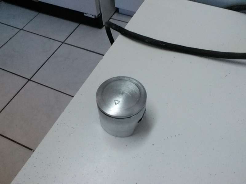

Now I'm building a Zen cylinder and it has a more uniform chamber and matched squish band. I rounded the walls of the chamber a little and increased the volume so my questions are did I increase compression ? other question is if I added more volume should I go higher on the timming or keep it stock and tweak it ? I will be using a TK 1.6 crank and a 36mm rev piston. I sanded the top of the piston cause it comes with a rough finish and matted it to the sqiush band, this will give me a little more clearance up top so I can keep the cylinder base lower and piston ring ends on the intake nub .
I assume I can keep the exhaust roof timming stock in order to keep a greater compression distance since I increased the size of the combustion chamber and get a bigger bang!

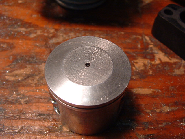

If you want to run squish clearances less than .010" (2.5 mm) you need to machine the combustion chamber and the piston. I cut a 12 degree angle on both and take the minimum amount off each to just clean them up. I also machine a flat area on the piston. You will need to take a lot off the cylinder base to compensate. The combustion chamber volume ends up around 2.4 cc. That's a pretty low compression ratio, but I don't know how to reduce it in a legal NAMBA G class engine. If you have a head button engine you can run a lot more interesting compression ratio. Years ago we ran a 1.8 cc volume chamber with .002" (.5 mm) squish clearance in a Quickdraw. Jim's toroidal heads can go even smaller.

Zen cylinder with no base cut using a using a CY bottom with no base gasket the cylinder will ride the piston about .006. I added about .014 gasket and piston ring seems like it is in a safe position but I plan on using a Zen bottom. I will shoot for .012 min and .015 max on the squish.
Would I be better off keeping the stock compression distance since I made more volume to be compresed ?
