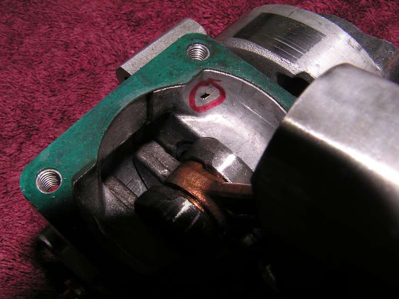

lohring replied the topic: New carb, new case new pipe. Won't run?
Be sure there aren't any air leaks in the crankcase. We once found an engine (not RCMK or other well known brand) with the casting like the picture below.
Lohring Miller
