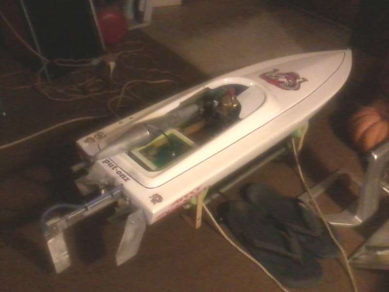

high-tech replied the topic: Wrist Pin Retainer Clips coming off
Hi Bob, I was running a Y6 G2 Mono w a gizmo top end and hanging with the big boys here in District 19 :)
