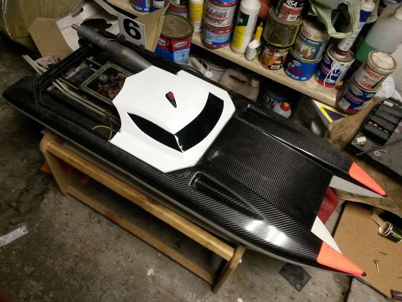

SRI Motorsports replied the topic: Re:Stock G260PUM issues
Possible that with a hatch on there is not enough venting for the eng to cool and have the carb in clean air? When the air heats up in the hull the eng runs hot and will drop off in power. Do you have pics of the setup? That would be a good start to help you out.

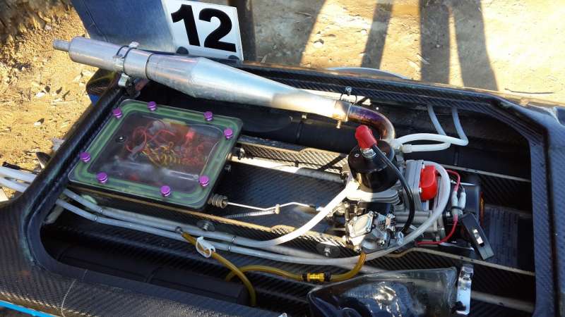

Hot Rods replied the topic: Re:Stock G260PUM issues
By doing the math ( converting to inches ), your pipe looks to be good. You could try it without the silencer to see if it's developing too much back pressure. Most 257 carbs like 2 1/4 to 2 1/2 on the low needle, and 7/8 to 1 on the high ( given good air quality ). Check the carb diaphram for wrinkling. The stock intake isolators are infamous for warping and causing slight air leaks with increased temps. You may have to flat sand it. Make sure your water "IN" is low, and water "OUT" is high, to eliminate air pockets inside the cap.
And a few pics would be helpful.

SamCro replied the topic: Stock G260PUM issues
Some pics for those who've asked.

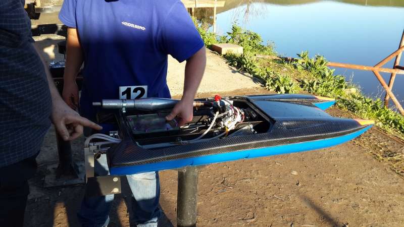

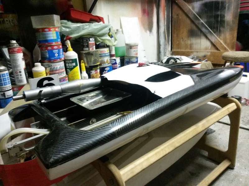

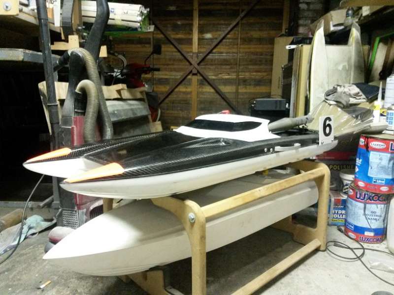

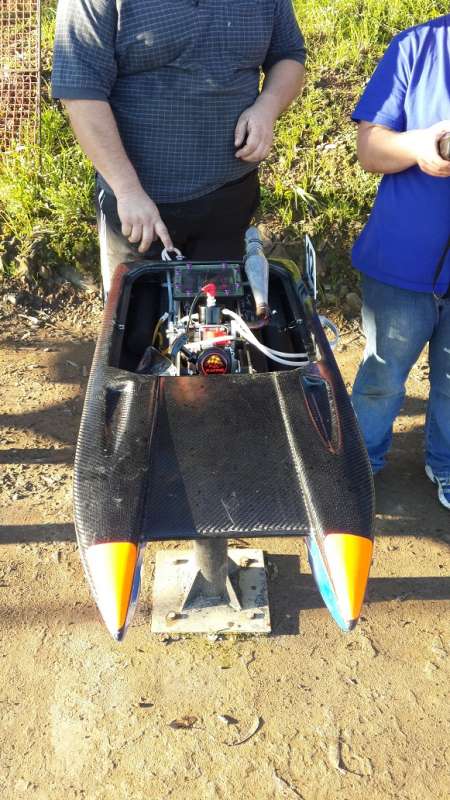

Some more pics.
