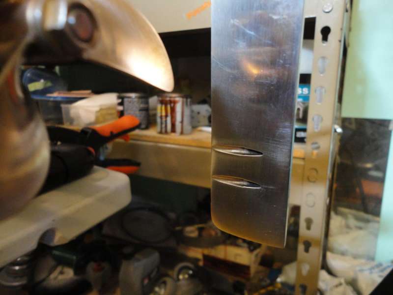

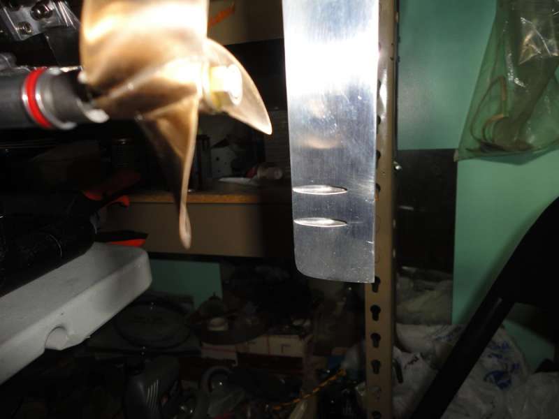

Also checked the water channels in the rudder...they're not blocked, but did find a white residue inside them. Maybe the aluminium that's corroding a bit? Also found that the holes where the water enters the rudder is also only 2mm, the ones running up to the barb fittings are 3mm. Gonna drill those out as well.

Like Les said - I drill out all the stock fittings --- I use XL water line - and on the rudder I open it (and holes) up some - I don't use the XL water outlet because I like to 'see' the spray when it comes by so I use Pro Boat stainless out fittings (not too big but gives good flow and I can see the flow) some of the XL outlets are so big water `dribbles` out and hard to see at a distance
If any of my stuff starts to show any major corrosion (white residue) - I simply replace it.
Here is a rudder blade on mine
Here is a rudder
