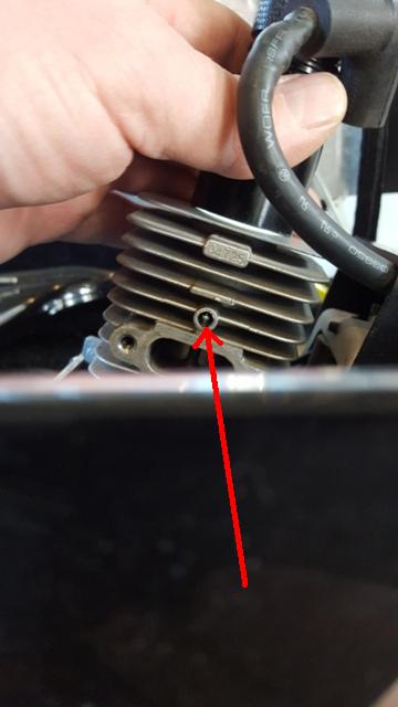

OK I needed a new primer bulb so while I was there I picked up a carb rebuild kit. I took it apart and to my surprise it was completely clean and new looking inside, but I cleaned and replaced everything while I was in there. I think one of my problems was the pulse hole not lined up properly with the intake plate/carb gasket so I raised it a little while tightening it back down.

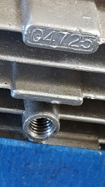

As for the exhaust recirc pinhole I was talking about no one seemed to know anything about it so I tapped the outer portion of the head with an 8/32 and installed a set screw, also recut a gasket to cover it as well. doing this raised my compression from 90 to 100. I checked with wide open throttle as done on V8s not sure if that is correct for these little motors but that's the way I did it. I then set Lo to 1-1/2 and Hi to 1 as I've seen recommended here and it started on the second pull. I tried tuning it a bit but I couldn't get it to idle properly once I changed from the initial settings. It idles great at initial but bogs out with throttle response. Once I got a smooth transition to WOT it wouldn't idle. Every time I set it back to initial it idles great. I've had it idling now for about 30 minutes (with an occasional rev to make sure it backs down good) and have been reading some more on tuning. took some pics and gonna do a little editing and post them shortly.

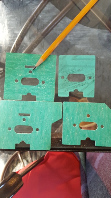

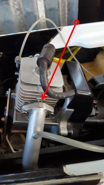

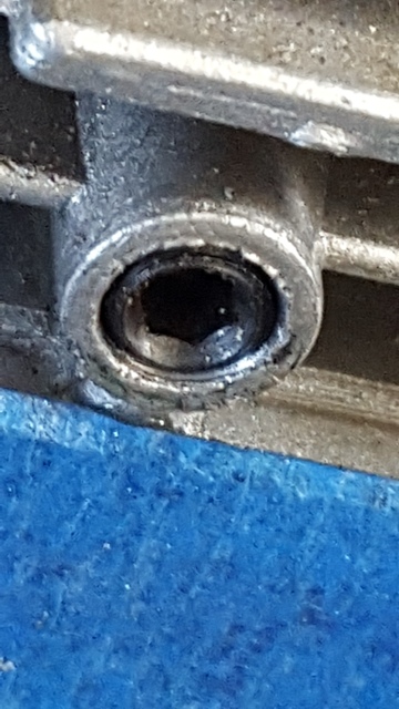

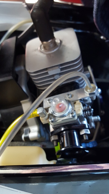

Canalbreath replied the topic: Exhaust recirc port & Walbro positioning
Here's some pics, I high lighted the port I mentioned and the fix(?) You can see the pin hole with my flashlight shining in the plug hole. Also noticed that the rebuild kit had gaskets to line up with that port as shown. And a few others as asked for to aid in support. Not positive but maybe you can verify it's a 26cc ?
Hmmm just heard it stall, hopefully my tank is empty, had to have been about 45 minutes by now.
Please let me know if I didnt add the pics properly.

marc replied the topic: Exhaust recirc port & Walbro positioning
I would have blocked off that hole also. Im not sure what it was initially for but certainly was not meant to be left open.

gordie replied the topic: Exhaust recirc port & Walbro positioning
The divider in the exhaust port tells you its a 25cc, the hole above the exhaust made it easier to start when it was a trimmer motor, tapping and plugging the hole was the thing to do. Looks like it has a metal cover that reduces the crankcase volume(stuffed). The 167a walbro is the carb everyone used and I still have one, I did have a lot of success with a wa813, my homelite liked the extra fuel but you have to open up the isolator block to fit the larger diameter. Needles 1.25 high and low to start and tune from there, wouldn't be surprised if that is the source of your problem as they are getting pretty old and methanol fuel ruins the membranes inside the carb, you can rebuild it cheap though. You can find a lot of info about homeys at modlepowerboat.com, hop up a homelite, have fun, they are a blast!

Bob DeCortin replied the topic: Exhaust recirc port & Walbro positioning
Yup its a compression release.
Compression is a on the low side.
