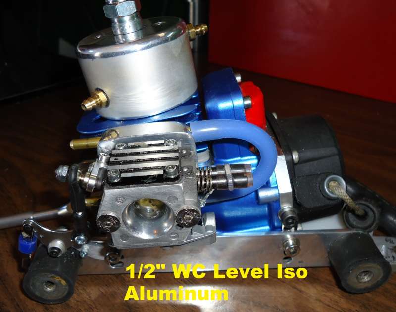

Doing a build right now where I need carb to sit flatter - needles not poking or angled up. I make my own Iso for 'just playing' - I make a 3/8 & 1/2 Alum and 1/2 & 3/4 "Delrin". **
Any way this is what I did for latest .. and showed some others (Iso's) for comparison
I don't like 'special carbs' with shortened needles etc. and like all to be same (one spare then) and thought maybe other guys might get ideas from what I did / do with these.
** The material comes from local shop that uses this for commercial kitchen counters - he said *Delrin $$ **
* I don't sell 'em I just make odd one for personal boats *

This is how I make the *Delrin ones - the alum are much the same but way more hand grinding as they are so thin and I can't drill them as deep with 'step ' bits
Hope it helps gives guys Ideas - I'm welcome to any suggestions too ... eh
** Couple of first pics are one I 'whipped up ' for pics - so not exactly 'precise' but gives you general idea what I do **

One of the fellows asked me for a aluminum 3/8" "Level" Iso -- so I'll send next week
#25762
Canadian Hot Rod RC Boats replied the topic: Rotated Carb Isolator for Clearance
Couple more 1/2" & 3/8" Aluminum
