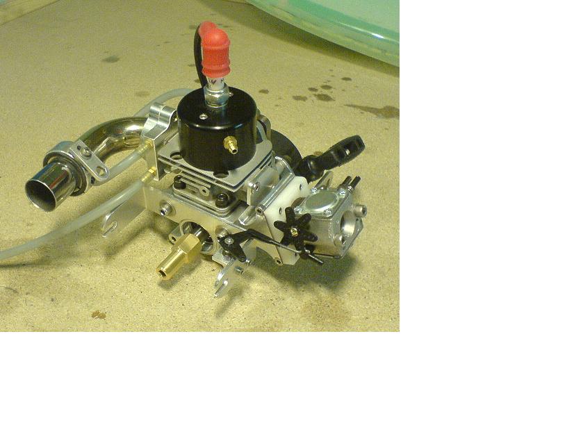

This would be an ideal case where PIPE dimensions or a set tuned length could be used as an RPM governor.
#3232
patriktegelberg replied the topic: Re:Patrik Tegelberg's billet engine project
That is an idea I'd try if I could get Carlo to sell me another 100 deg 1 inch header, he don't want to sell one seperately. I use a CC 2 inch band pipe and cut the header 1 inch shorter upon receival, no science just a gut feeling chance cut. I do not know the length of it now but it is longer than the one on the pictures of Scott's rigger and if I recall correctly in the upper regions of the recommended lengths I read in the forums.
Both times the crank warped I was dry revving it on land, not sustained rev but one second throttle snaps, usually only just out revs the tiny tach at 20k but if the carb is lean it will rev substantially more. I think of this as a minor problem. I am pleased to find that the myth about reed engines don't rev does'nt seem to apply to my design. But I have to do more testing, land rev is nothing, it's on the water that results are measured. Also I am pleased that my reed petals have lived longer than the very short life span reported from some setups.
I have worked more with the boat and hardware than with the engine. The engine just sits there and works. I have not had the opportunity to compare it with another engine yet. I have broken some rudder setups and spend time on developing a carbon fiber transom hardware configuration.
I look forward to be able to spend more time on the engine that that makes me smile every time It comes on the pipe, savage :)
