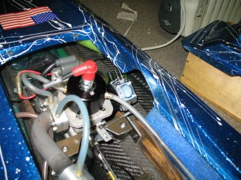

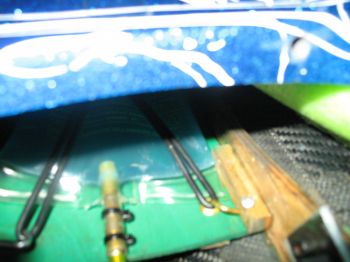

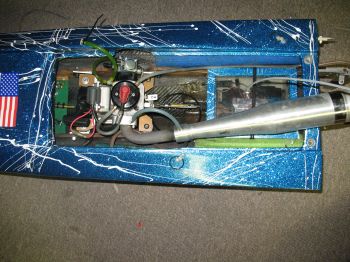

mitchesx replied the topic: Re:Zenoah stalling coming out of a corner
This is the first set of pics showing the setup of the boat. I have not changed much since I bought it.
#3911

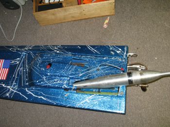

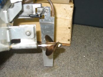

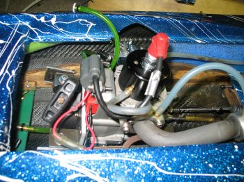

This is the second set of pics showing the setup. The prop is an Octura X472. The motor is 14 inches from the transom to the center of the plug, and the pipe is around 11 to 11.5 inches from the center of the water cooled flange to the beginning of the widest point of the pipe. Dave - thanks for any help you can give me; I'll also email you the pics and ask for a price on the prop at the same time. I do have a velocity stack that I can add to get the opening under the deck lip.

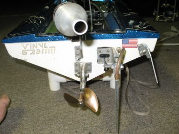

Last one!
