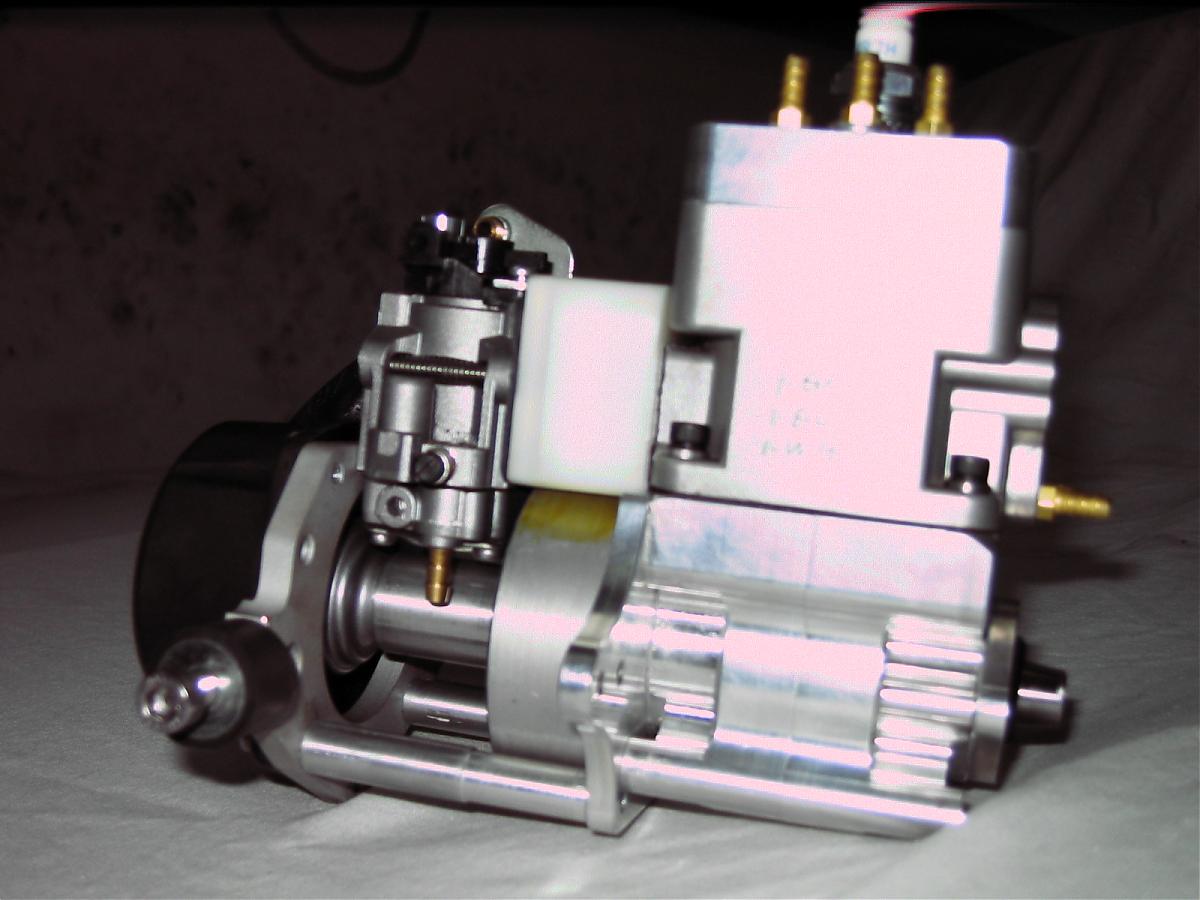

[file] Hell friends i am new with these engines i always had a zenoah on my other models now i bought.Iwish to know what type it is or ht or hr it has a number on the billet case 301, and on the cylinder have 1.BP, 1.BL,1-WH may be the b is 8 cause these are ingra
ved in the cyl. I someone knows pls let me know this is a rear ex with wk33 and have at the back a bronse flywheel from were it starts two inlet for water and three outlets.Thanks again guys :S

Karm, Your best bet is to send Mitch or Todd from Quickdraw an e-mail, let them know the serial number which would be 301. They should be able to tell you the configuration when it left them. Pull start adaptor has been made. Barrel probably says 1 Br, 1 Bl and 1 Wh which is the base gaskets used to get the correct squish. Br = Brown, Bl = Black and Wh = White. They are all different thickneses. The amount of gaskets leads me to think it is a High Rev Rear Exhaust. 301 is a low number.
QDRevenger.

Hi andrew yes exactly what you said ,gasket type every thing they told me.Now i am happy and i can put this engine in hull.I removed the flywheel cause i was afraid that i will bend the conrod when dunk in the water.So thanks and keep me informed with your results
