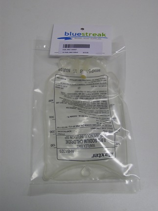

When I first started in boats I ran clunks in the tanks and I never had good luck with them. In my opinion a rigid piece of brass tubing going the bottom of the transom end/port side of the tank is the best setup. My favorite tank system is by far an IV bag though. No vents, no fill lines, no return lines. One line to the carburetor with a "T" fitting inline with it to be used for filling the bag. Very trouble-free.
I think what Ed is describing is using an IV bag on the end of the vent line. Start with a full tank and IV bag full of air. As the fuel is drawn from the tank, air for venting the tank will be drawn from the bag. When refilling the tank the air will be pushed back into the IV bag. Sounds like a good setup to me if you really want to keep the hard tank. This would provide a good venting method without allowing any water into the tank in the event of a blow over.

That's the system Marc , I still like a hard tank but I'm trying a IV bag at the present time in my Lazer 45. Jury is still out. The nice thing is that the vent bag can be placed anywhere in the hull with no balance problems and the hard tank keeps the fuel weight in a smaller footprint which does not move the balance point with fuel usage as much as a IV bag with a larger footprint does. Also I have the same amount of fuel in the hard tank each time I start a heat. This is not as critical on the Lazer as it was on the Hurricane. Be shure that the fuel line and the tank stopper are rated for GASOLINE and not silicone glow motor stuff.

thanks marc for all your info think im going to change to a bag setup ,have seen a IV bag advertised at my local boat hobby shop as im in australia ,where its summer now !!!,but there bags are intrevenous bags cleaned and flushed is this normal ??,where is site i can get from in us and what is normal size as IV seems small only 300 ml ,what sought of run time with a zenoah ,as im only sport baoter not racing THANKS
