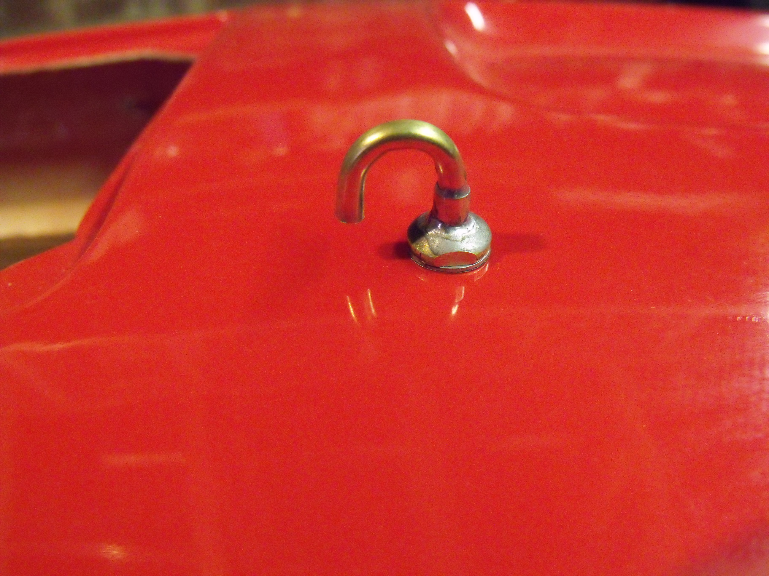

Pic hopefully included shows my vent pipe.

Welcome to MGB. That setup should work for you. Just some friendly advice though if I may. You can use a clunk, but sometimes when fuel is running low the can take in air causing missing issues. I know some guys use clunks that actually absorbs some of the gas to "make up" for when the clunk isn't actually in fuel. Most guys however will just run the brass tube inside the tank to the rear/port side for best optimal fuel pickup. When using hard tanks that's what I do also.
As for the vent, I know you've already done it now, but for future builds, I would recommend routing it out the side of the boat. With movement and vibration while the boat is running, some fuel is bound to escape via the vent...this just prevents getting fuel all over the top of your boat. :)

I like the suggestion of replacing the flexible inner tube with a brass one pointed to the bottom of the tank as it sounds simple and effective.
The vent I pictured does in fact have a secondary brass tube soldered inside the exterior pipe leading to a very small opening. However as you rightly said it does still allow a little spillage when the the tank is full.
