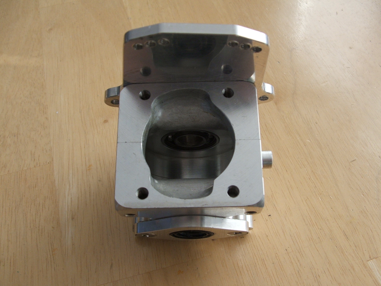

Looking for some motor expertise! I have acquired a J&G 4 bearing bottom end and I am looking to build a X class motor on the cheap. I have done four 260 zens following the tutorials by Scott S.(Thanks Scott!!) with better than expected results, and figured it would be fun to to an X class motor.
The rcmk top end has interested me however I am not sure if there is any advantage over a zen.
What do you guys think? Zen, rcmk, j&g etc?
Thanks!

Decided to go with the RCMK top end -based on nothing more than aesthetics alone.
Step 1 will be to open up and blend transfer ports.

That is one of our Zenoah top end four bearing cases. Looks like someone worked the cases by blending the transfers on the case.
Todd
