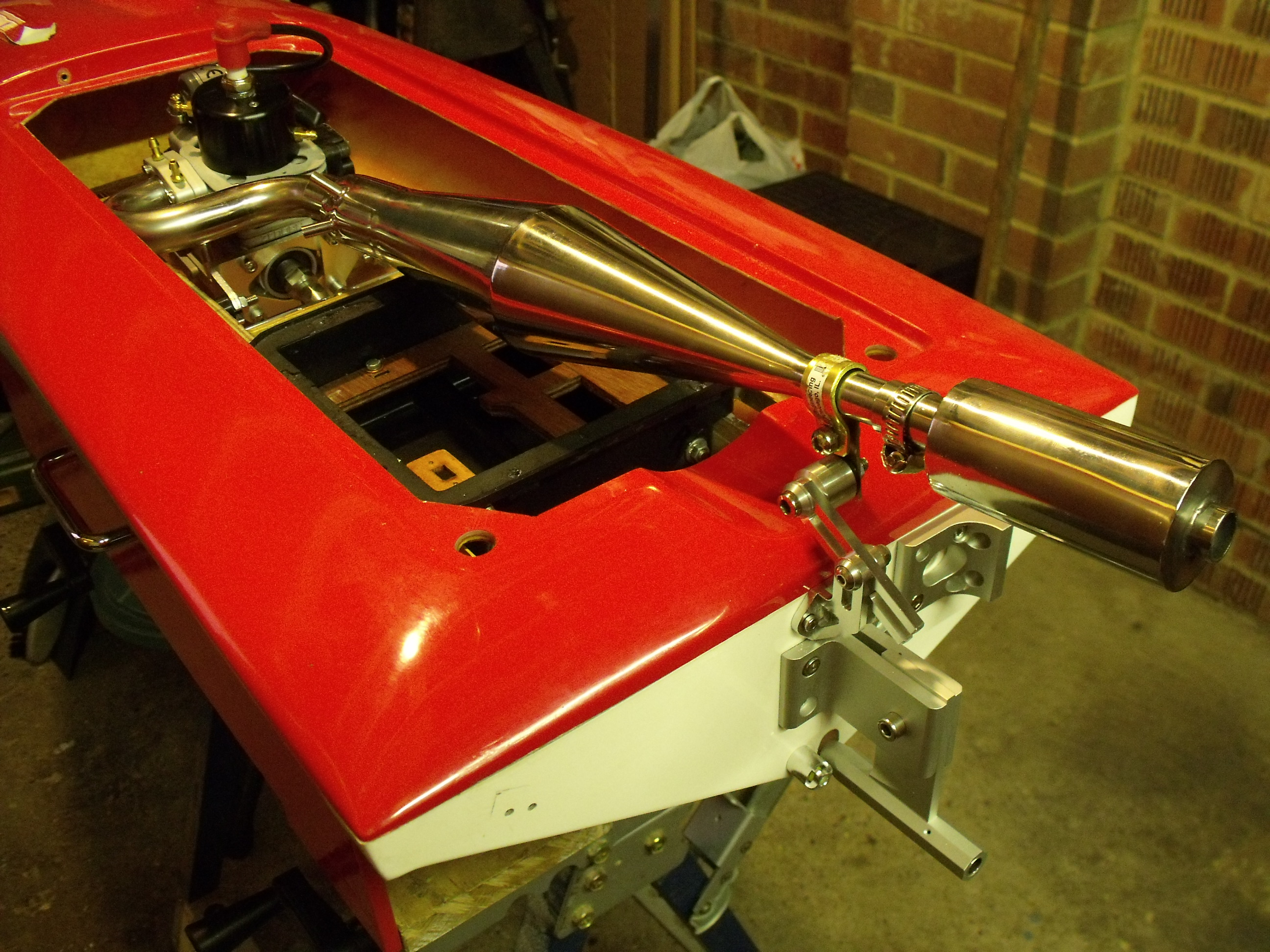

Craig Dickson replied the topic: Re:Constantly blowing o-rings >>> any tips?
I found this topic interesting because if an otherwise faultless boat has to stop because of blown O rings it is very frustrating.
I now only use the Viton O rings as I understand they can cope with higher temps than the silicon ones.
The thing I find critical is to ensure that the rings seat properly once the flange is tightened up. With some flanges it is very easy to crimp or trap the O ring upon tightening the flange bolts. And it can be difficult to spot.
One obvious test is to blow air into the water cooling jacket and ensure that it is air tight.
One other thing I do is to smear a little oil on the O rings prior to fitting them. I find that this helps them pop into their retaining grooves.
The point made previously about ensuring accurate exhaust alignment is I think especially important.
In the photo below my exhaust requires no movement in order to connect the single rubber mount (shielded with the horizontal alloy sleeve) to the support strut. I positioned & installed the support strut with the exhaust system all in situ to ensure that all components mated together naturally. So far this has given me zero failures (famous last words!).
