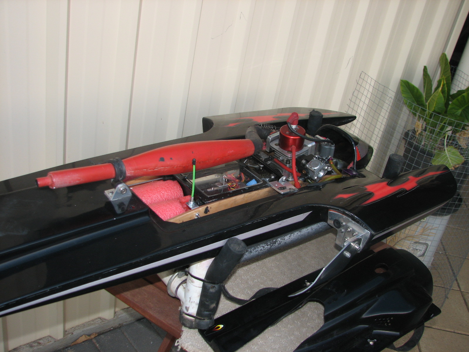

nimbus replied the topic: Re:Zenoah mod
Sory Scott
Dont know what I did, but that is what my pipe looks like.
Would an adjustable pipe be better?
I have taken a standard 644 Walbro filled the front with plastic steel and bored it out as explained in(modifying a carb)to get rid of all the bumps etc. It seems to work well.

Scott replied the topic: Re:Zenoah mod
Never found a WTC style pipe able to get short enough.
You will indeed find more RPM and power with a adjustable pipe able to go shorter than the WTC you now are using.

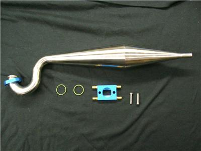

Dicko replied the topic: Re:Zenoah mod
Wrap to center pipes can work if designed right. here's one I have that is tapered from shortly after the manifold. It has had my sport hydro up to 125 kph with the previous owner, I've personally had it to 117 kph. I'll have to get a better picture, you can't quite see it well enough.
Most wrap to center pipes can't be adjusted short enough as Scott says. the one I have is no longer in production due to the high cost of manufacturing them. If I ever saw another one for sale I'd snap it up in a second.
