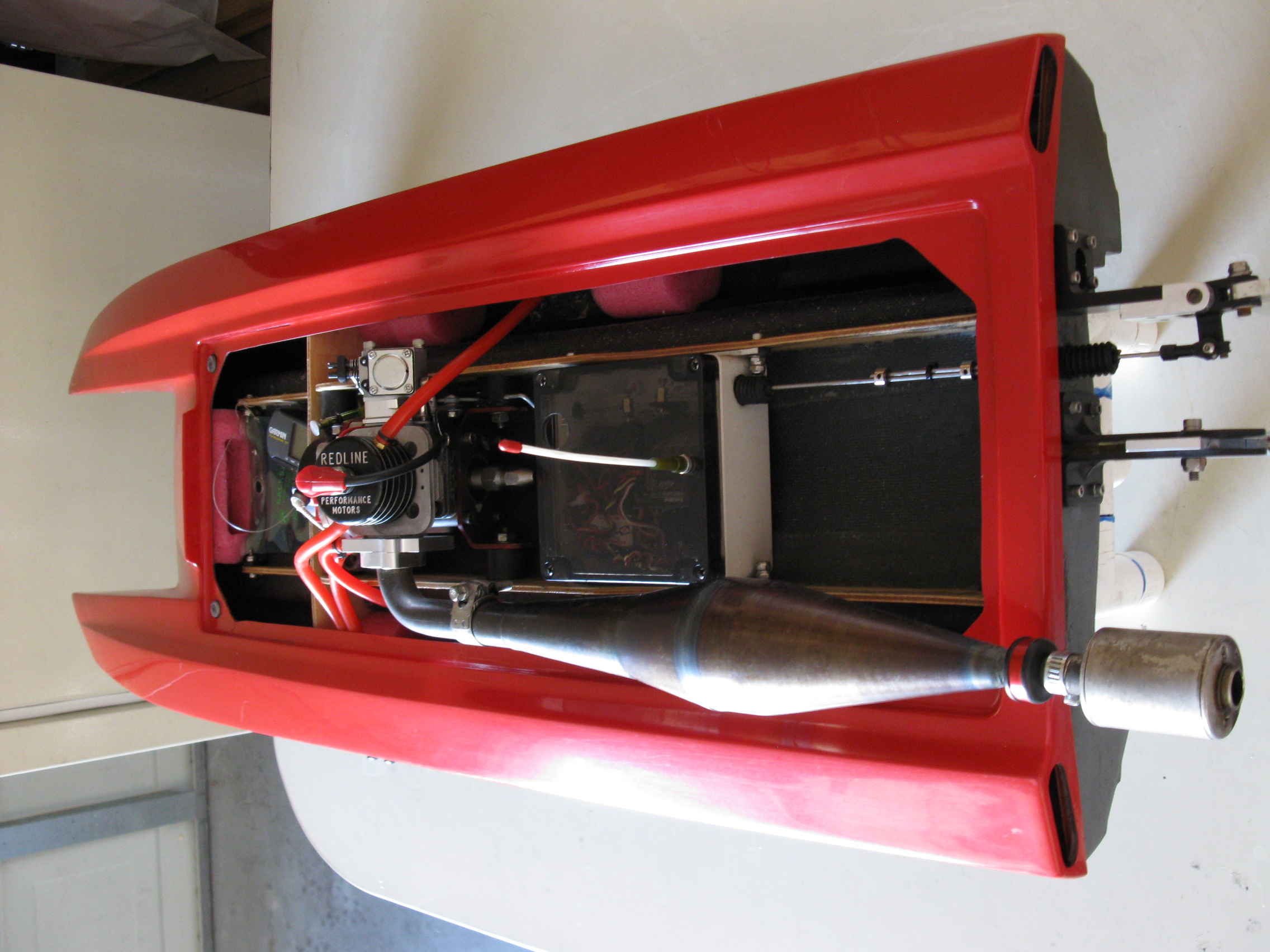

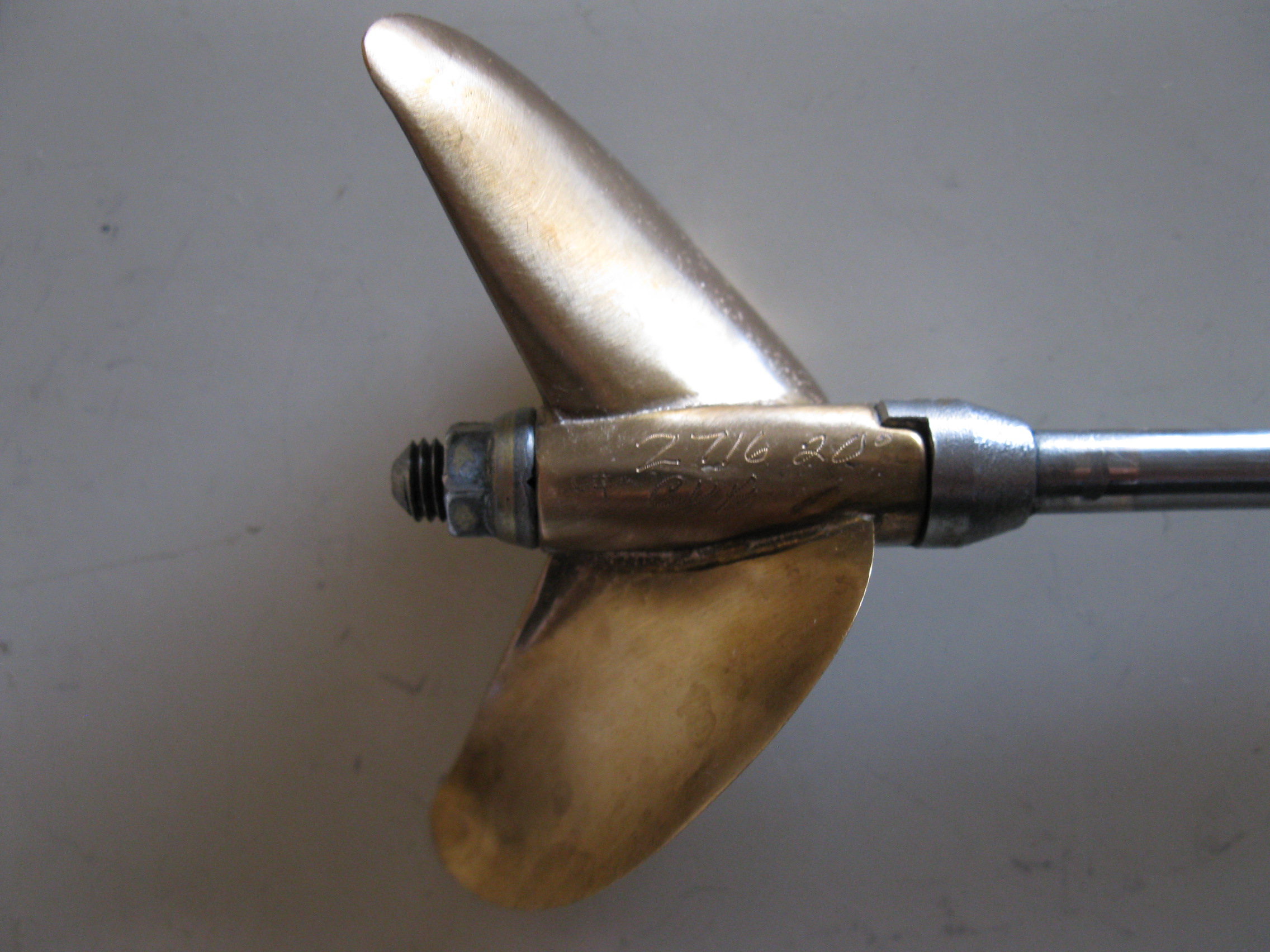

ken0276 replied the topic: Re:Zenoah mod
Here is my 90* Need For Speed 1" band steel pipe and 2716 prop on my Sprint, the motor was refreshed by Redline in June and I think Mike had put a turbo crank in it as he told me in the email..this thing was not slow, it went 73.5 mph.
#7261
More picture..
#7262
