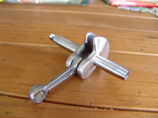

turbo crank mod
corban created the topic: turbo crank mod
onuce you have put the round on the crank do tou have to rebalance the crank cherrs
#7368
Scott replied the topic: Re:turbo crank mod
No, the weight removed is so minimal it is a non issue.
Along with a reduced weight piston it is smoother than stock ;)
#7371
Dempsey15 replied the topic: Re:turbo crank mod
How much of a difference do to you if you Turbo the crank. I have been giving some thought to doing this on some of my motors, just curious to some of the results.
#7424
corban replied the topic: Re:turbo crank mod
hi i have not run the motor in a boat yet only started on the bench so far
#7427
Todd,
The turbo mod is not a mod that shows more power, but one of how cleanly the engine runs. The mod keeps fuel from pooling in crankcases and with the added air movement created by it keeps the air/fuel better mixed while aiding in directing it towards the transfer passages.
Dempsey15 wrote:
#7428
INEEDSPOTS replied the topic: Re:turbo crank mod
Scott..what would you use to do the turbo cut if you didnt have a belt sander.
#7429
Awesome. Thanks Scott. I would be interested to know the answer to Will's question.
#7430
QDRevenger replied the topic: Re:turbo crank mod
Hey Will,
I use a pneumatic angle grinder. It uses 3" disks.
