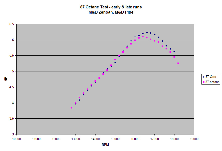

We don't worry too much about break in except to be sure the needles aren't too lean. We run our standard 8 oz of oil per gallon. A couple of dyno runs seats the ring, but the crankcase seals seem to take a while to break in. Low drag seals are the solution there. Break in does increase the power. In a series of recent dyno tests we saw the top end power increase significantly over a series of more than 50 runs. See the graph below.
Lohring Miller
