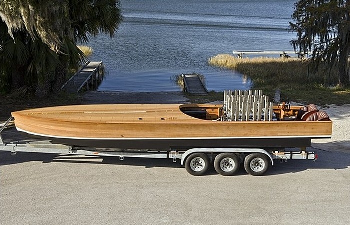

ridgerunner replied the topic: Re: 1:3 scale garwood speedster wooden boat build!
I've heard the Zipkits crackers are cheap,easy to build and handle well,but they don't have the lines that the Glen-L design has.The closest I've found to it is the Ivan Bourdier Hot Tub crackerbox.I've had good luck bending 1/8" plywood two directions on a hull by using a steam machine and bending both ways a little at a time and putting a twist in it.Here a pic of the Hot Tub style.

whitefish replied the topic: Re: 1:3 scale garwood speedster wooden boat build!
Nice looking boat! There is nothing like some tumblehome for a true
classic look.
It's great to read others are practicing compound curved plywood. It
has become one of the dying arts of wood boat construction.

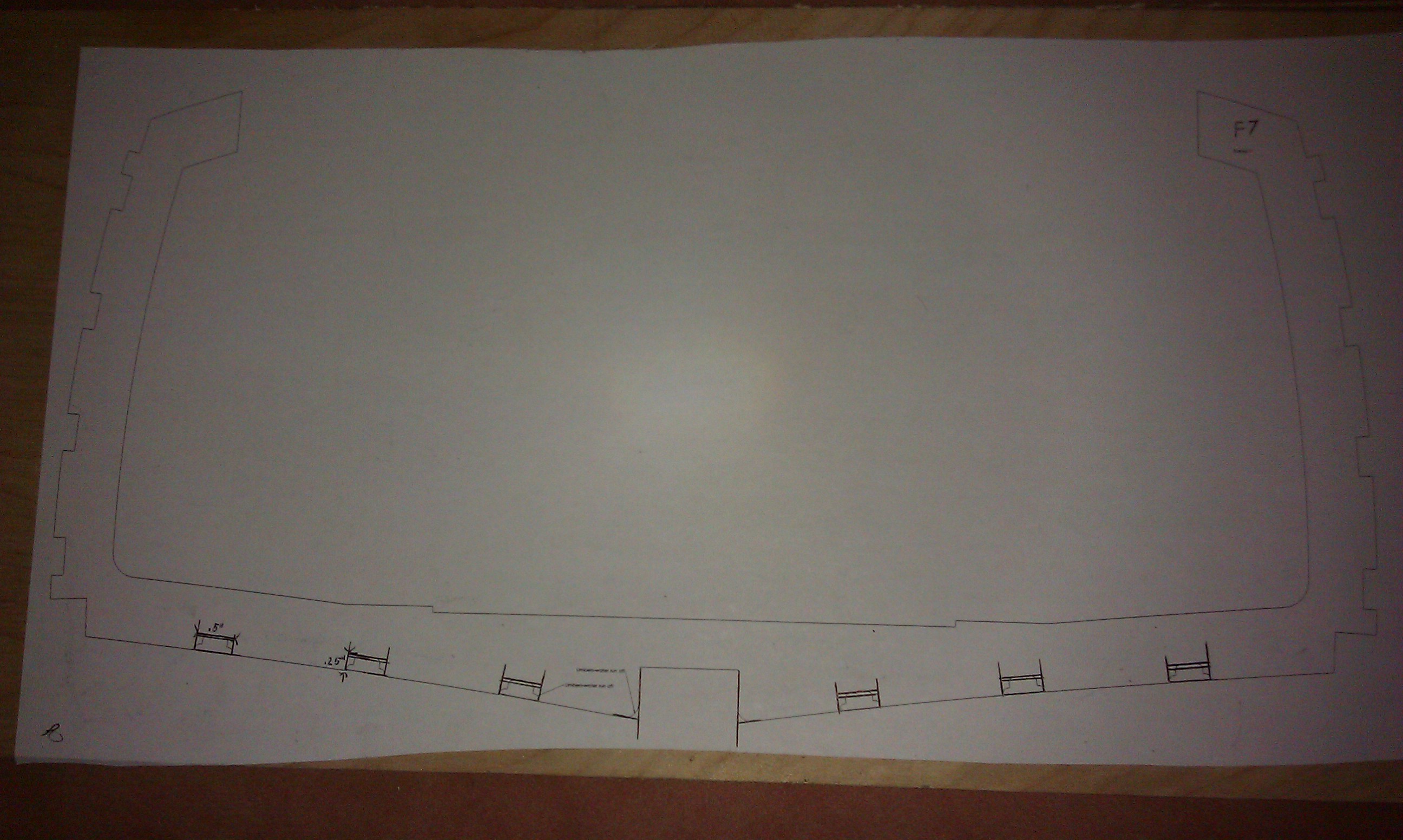

smokeater2005 replied the topic: Re: 1:3 scale garwood speedster wooden boat build!
I have made a small change to my 1/3 sale printed hull frame printouts! I have changed the stringer width and depth to 1/2" wide x just a hair under 1/4" deep on the bottom and the sides. This creates less of a headache in preparing stock and cutting frame stringers to the point of less waste and differences...
#19920
Pic of small changes to uniform stringer stock...
