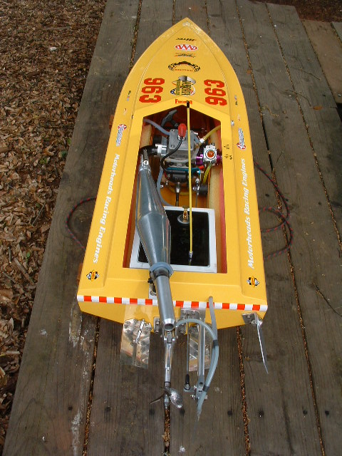

Anyways ... having raced smaller sizes of this exact hull back in the mid 1990's, they were top runners and solid performers. This hull the Big nitro/Gas version at 44" OAL. Hope it runs as well and have rigged it with a blend of mix & match hardware to duplicate close as modernly possible the rigging used 15 years ago.

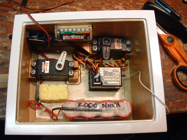

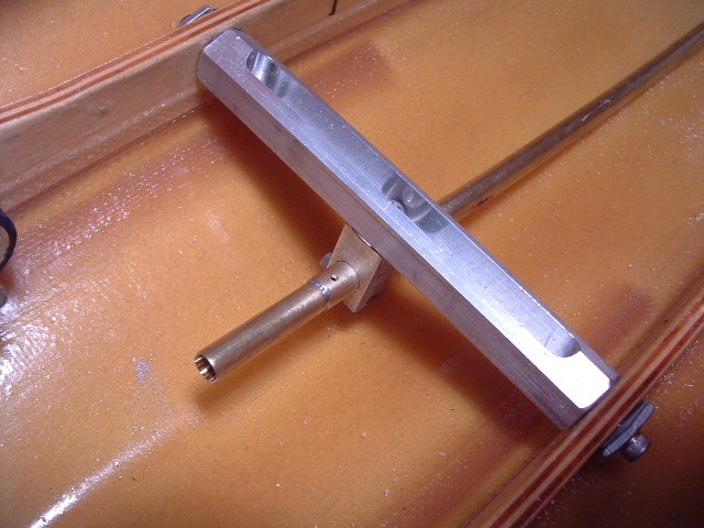

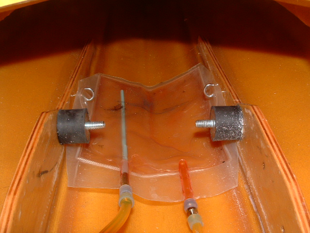

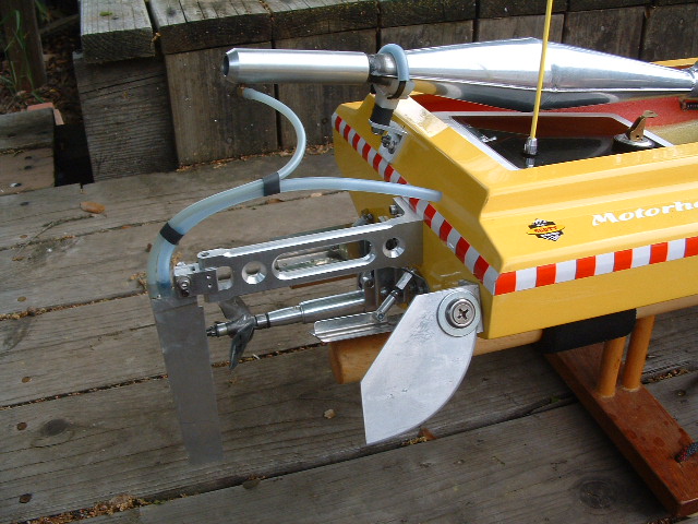

Powered by an RCMK Evo engine tho using a modified 1st generation cylinder, ceramic coat hot pipe combo. Long trim tabs, Top secret stinger drive & rudder, home made turn fin, CC t-bar & homemade wood radio box. Hi-tec servos with Futaba radio gear. Bucks bag I.V. fuel bladder attached to stringers forward of engine.

Gosh you see so many new designs, but then you have such a clean classic set up and it makes me want one. Where did you get that cool muuffler? Curious, with trim tabs, they are set up one farther from the center of the transom than the other that is tucked under the rudder support. Why?
#11634
Scott replied the topic: Re:Blast from my past ... NEW Cal Craft mono build
Tropheus wrote:
Muffler with water injection a self made custom ...
Tabs are evenly spaced, an optical delusion :blink:
Spacing of tabs is the same having an @ 2 3/4" gap for prop to find clean water.
Rudder @ 2 1/4" right of C/L ;)
