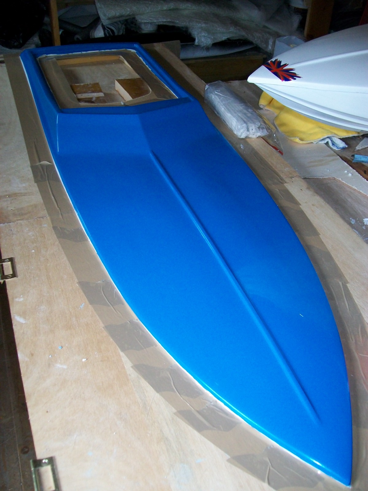

martno1fan replied the topic: Re:New Apache and Navaho hulls 57"

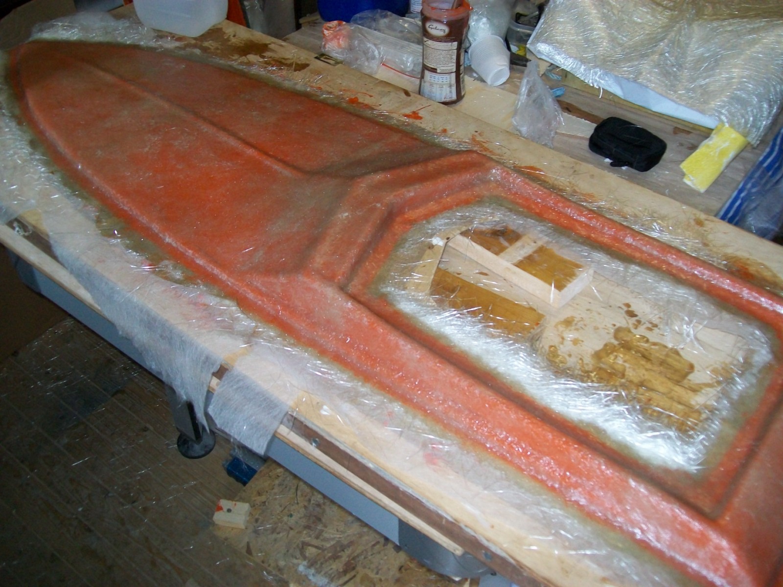

Been busy making a new plug for the newly designed top (Navaho).

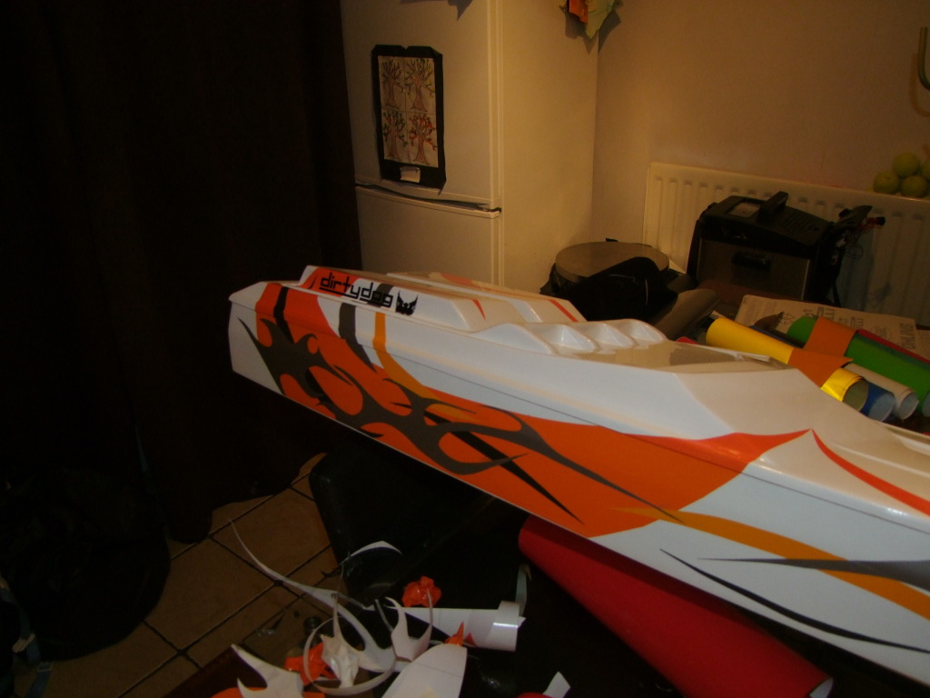

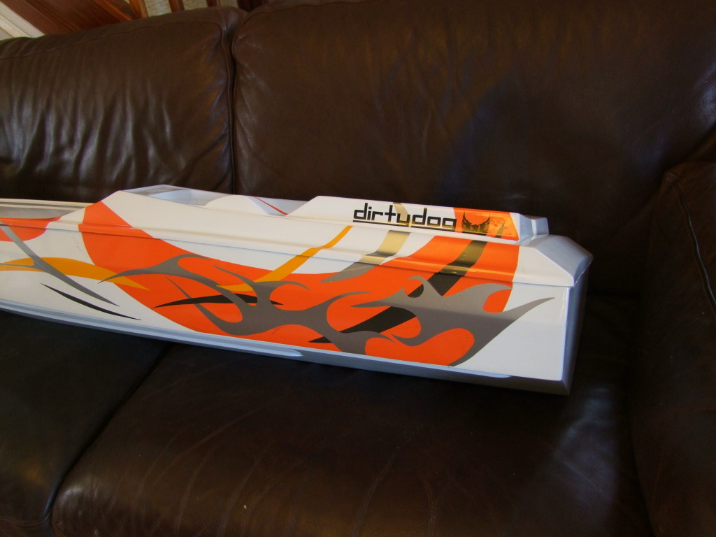

marc replied the topic: Re:New Apache and Navaho hulls 57"
The graphics look awesome!
#12057
Yea i think so too,he must have more patience than me thats for sure to do all that by hand.

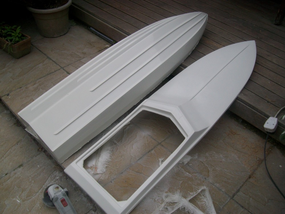

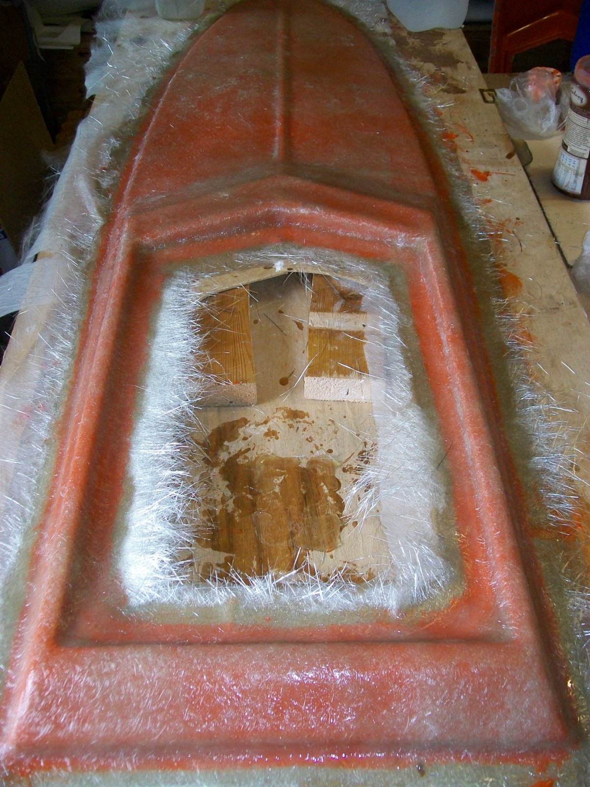

The moulds almost done,theres about 6 layers of glass on there which should be enough i just need to sort out some wooden frames so it stands flat for moulding the parts before i remove it off the board.

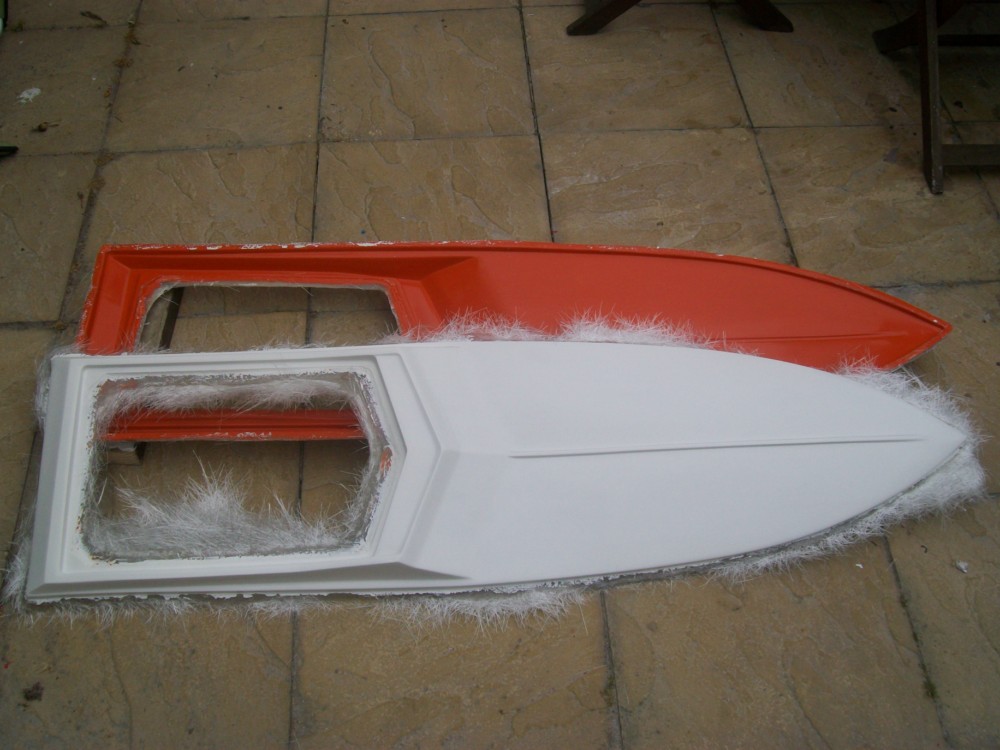

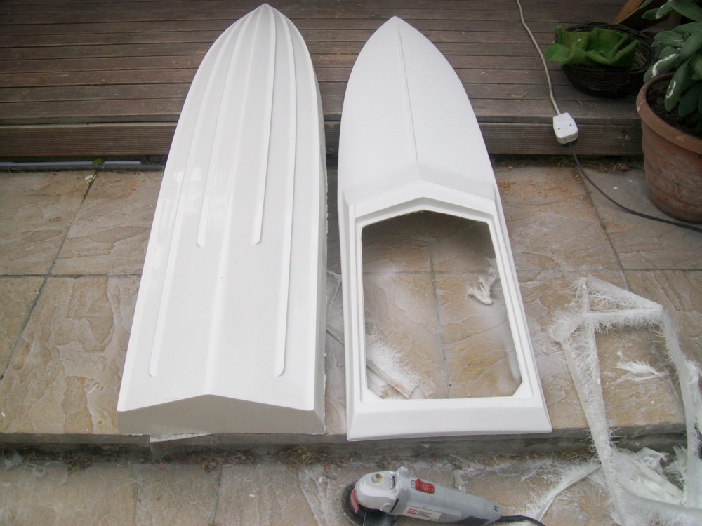

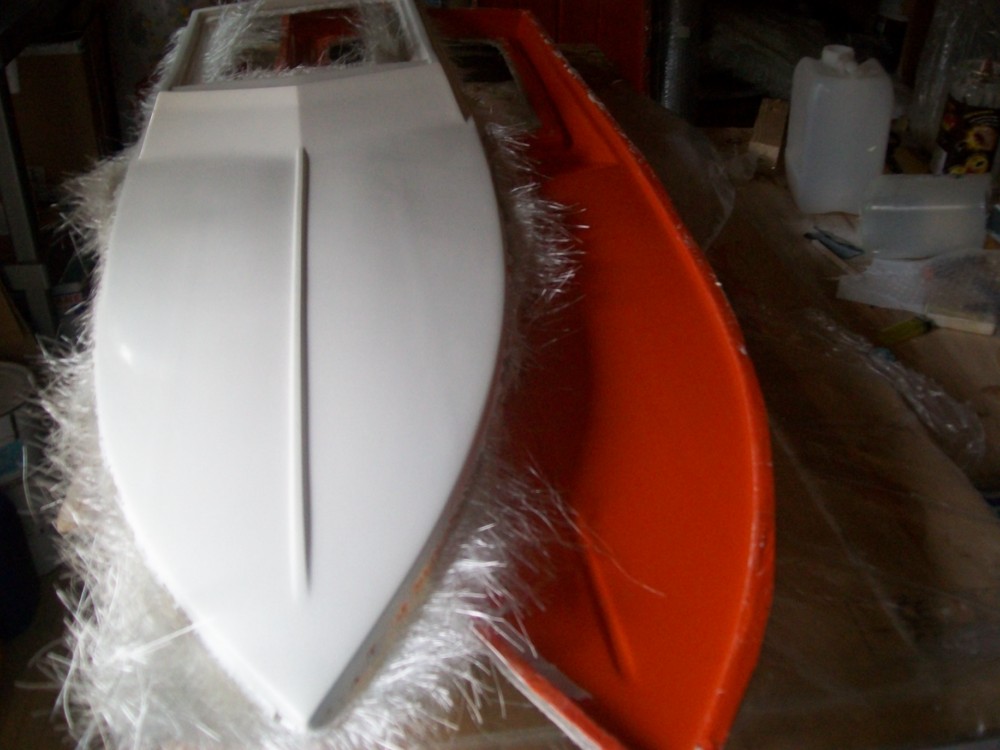

Well its out i also made the first part and it came out very nice.

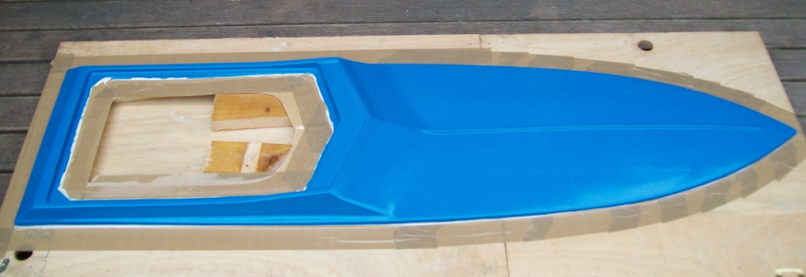

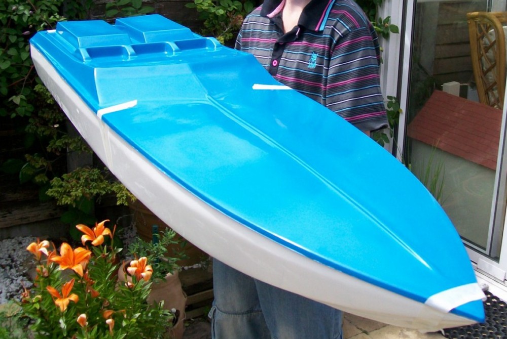

martno1fan replied the topic: Re:New Apache and Navaho hulls 58"
I took a cpl of pics of the latest one with my son Sam ,has a blue top on this one as you can see.Still needs the top fixing to the hull so just taped it together for the pics.
