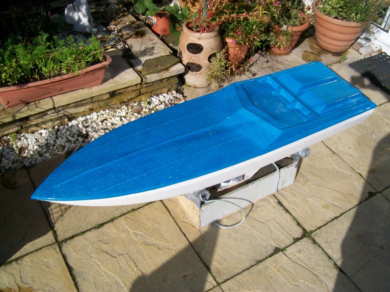

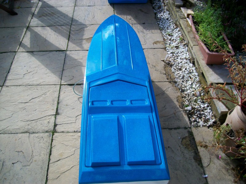

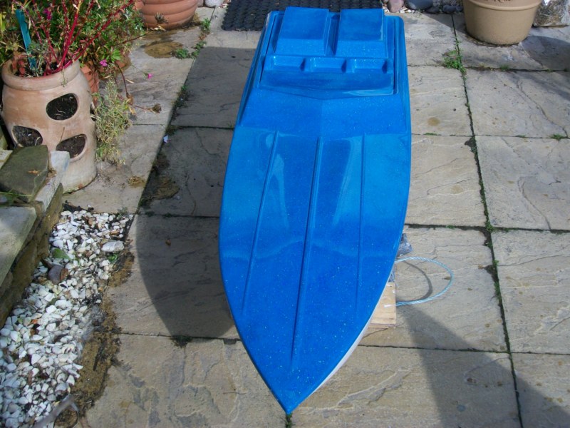

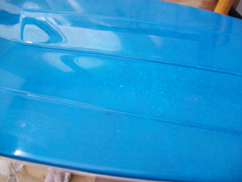

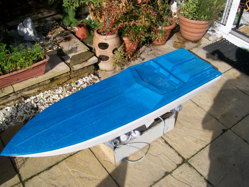

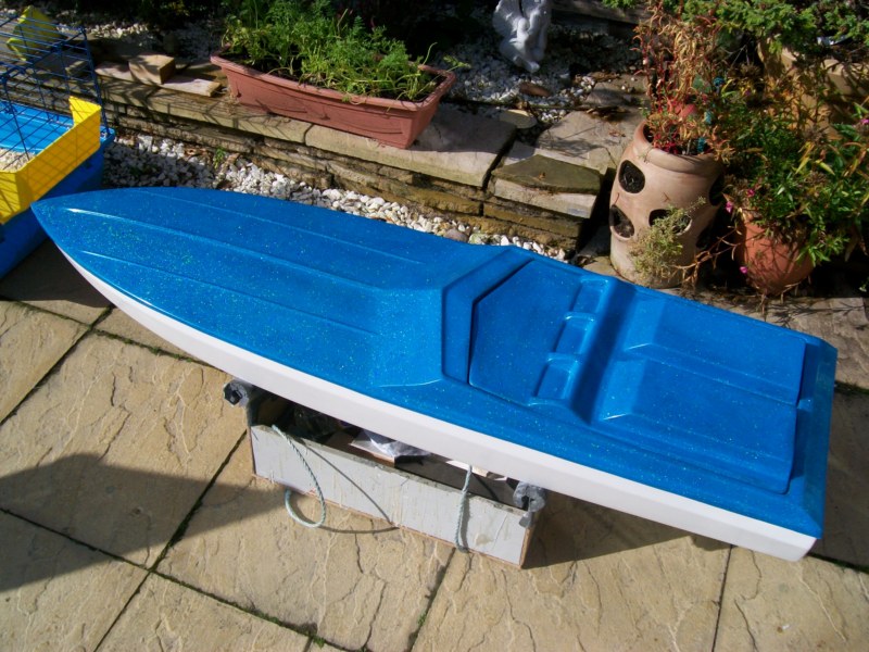

I decided to make one with a bit of sparkle :) ,this one has clear gel with holographic flakes in the mix backed up with blue gelcoat.No paint here just gelcoat ;) .Lots of work to get this right but its worth the effort i think ?.Also in the pics the top has just been pulled ,trimmed and wiped then sat on the hull for the pics,not even polished up yet so you can imagine what its going to shine like after been buffed using marine polishing compound.
