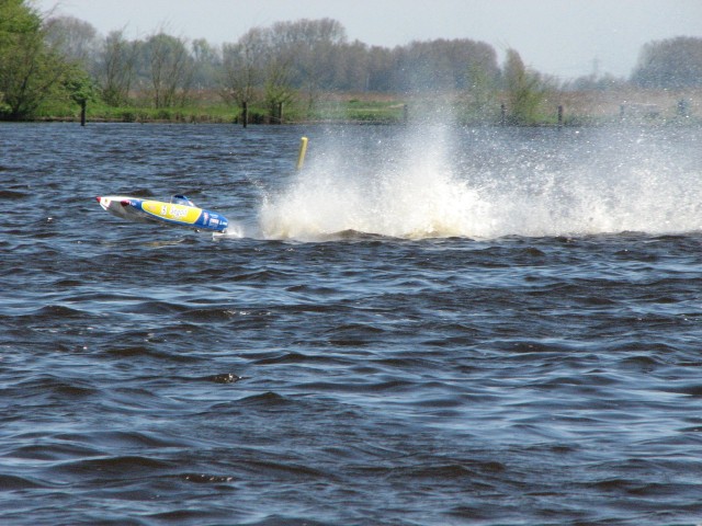

My CT.3 rebuild redy for the first run with diferent engine rotation !
Alpachino :)

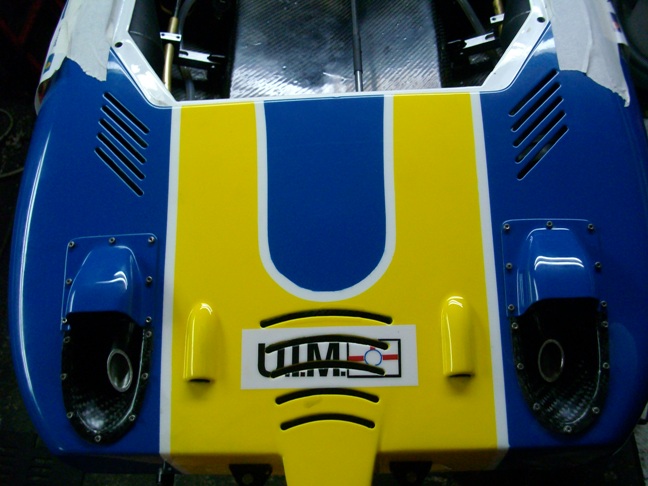

Woodie replied the topic: Re: CT 3 rebuild
Whooah!
Is all of the hull made of carbon, or is it just on the inside?
Anyway, it looks fantastic! I like the exhausts too. They are just cool! :)

~~~`Winston`~~~ replied the topic: Re: CT 3 rebuild
Hey Buddy :)
Yep, thats right, solid like a rock :laugh: LOL
Yes I made some changes in this Cat, hope if goes ok B)

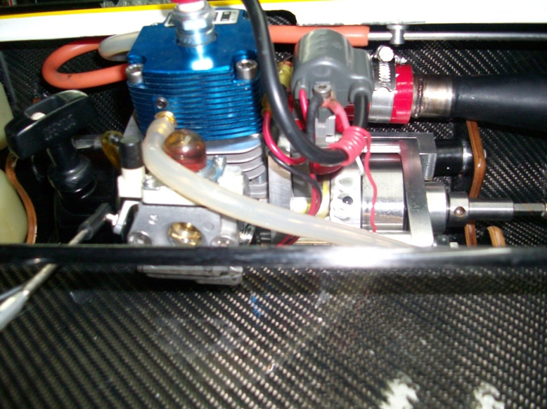

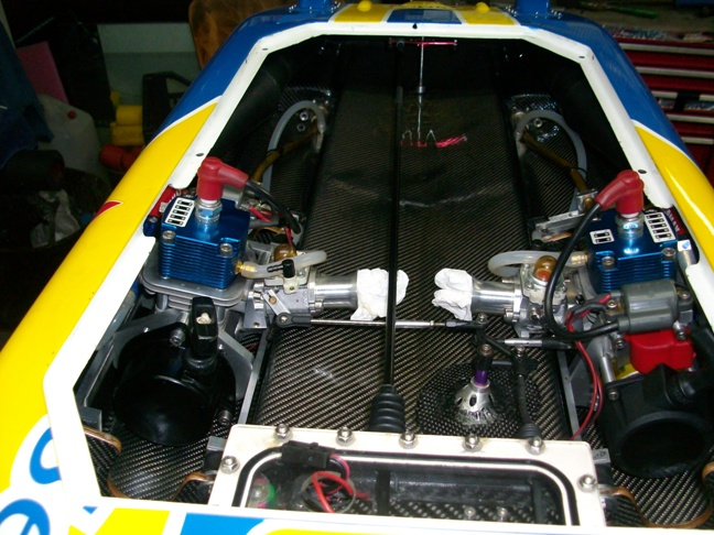

David McIntyre replied the topic: Re: CT 3 rebuild
What is the rotation now? and why did you change it?

isuzudude replied the topic: Re: CT 3 rebuild
Great Pic!! Need to submit that one for the front page B)
Hey Winston, what's the dimensions on your boat? And what kind of speeds are you hitting? Nice job again, That's a fine looking ride!!! B) 2 thumbs up!

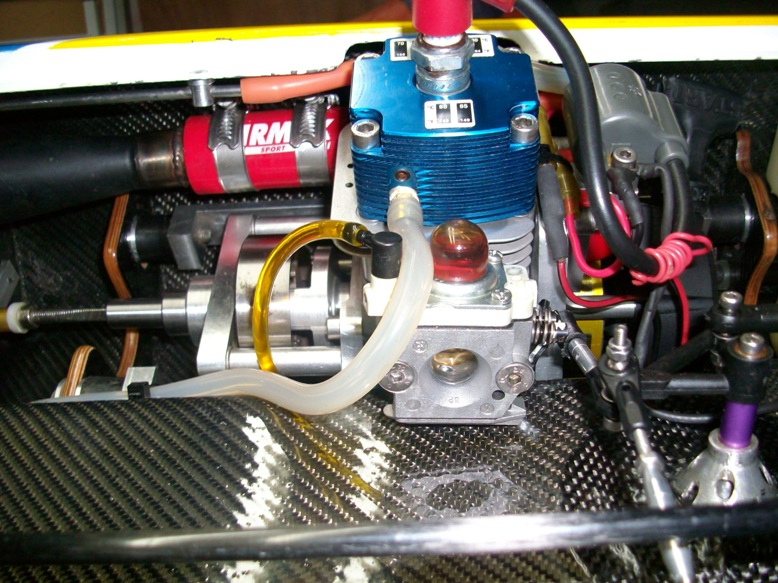

Kiwiboater wrote:Hi, Now the right side engine is turning clockwise, and viceversa !
I changed the rotation because of the carbs on the inside, and to much hassle to set them, plus that if you need to take the carbs out you have to take out the engins out :(
~~~`Winston`~~~
#13449
Hi, Speed with the old engine position was if I can remember well was 94kph, but now with the new engine positions should go faster in straight, but slower in cornerings.
Have to see, not sure yet.
The dimensions are 175 CM.
