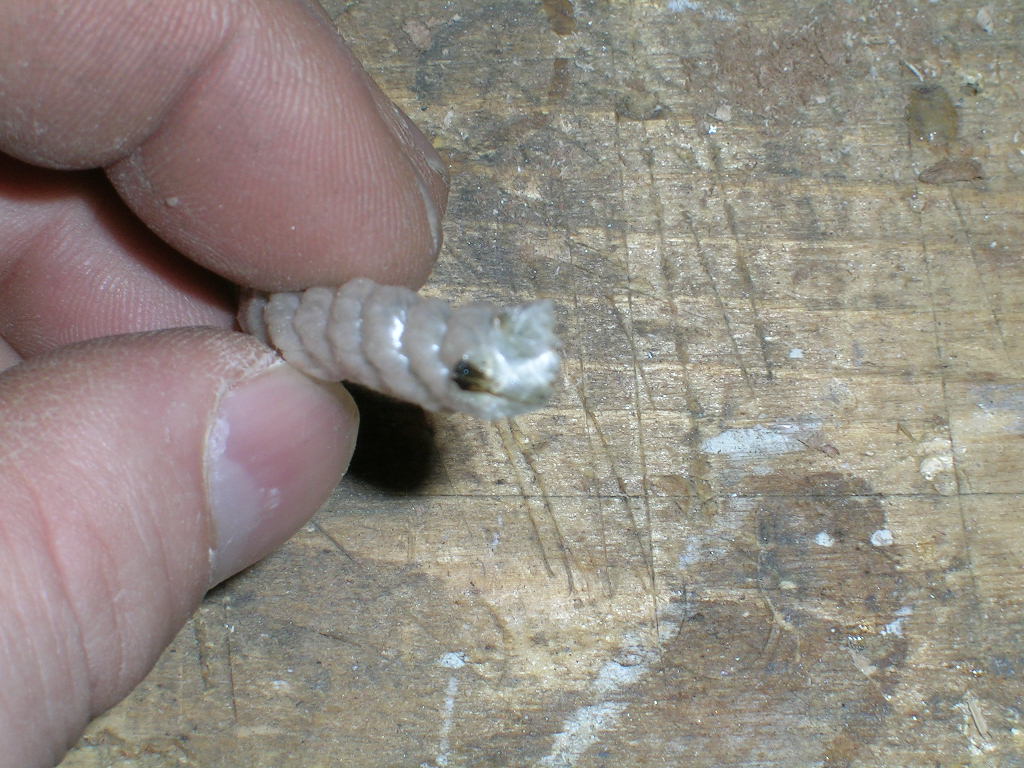

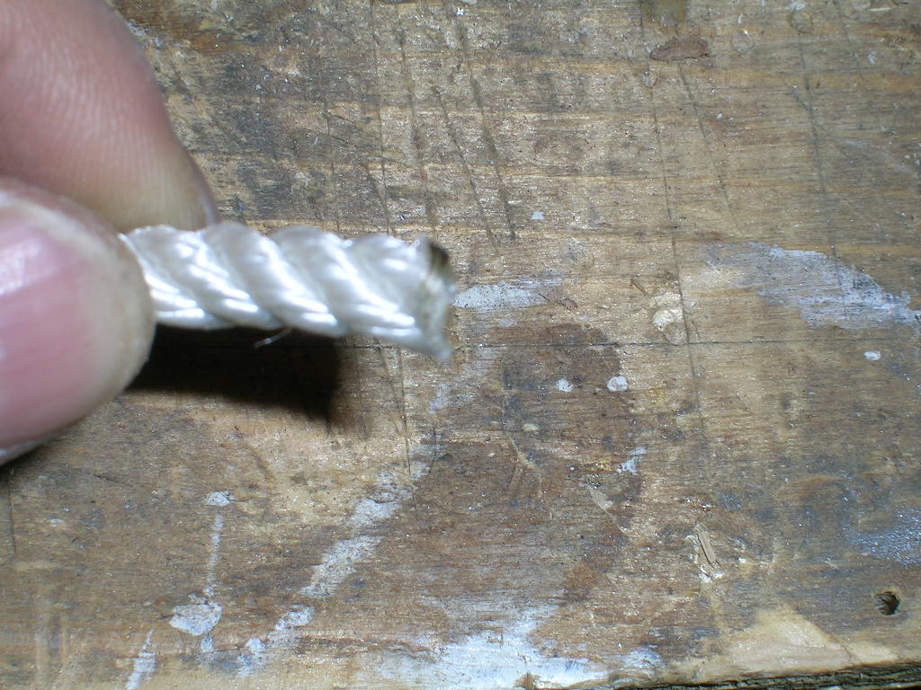

marc replied the topic: Re: Hot Wire Foam Cutter
Tried it with a piece of 3/8" nylon rope and it worked very well. Hard to get a good picture of the tip of the rope, but it lightly fused back together with the heat. It would probably need to be heated more on the tip to really fuse it together more before heavy use, but it worked well for making a nice clean cut. For this kind of application I think I would try a larger diameter cutter wire and more juice to get it hotter. Just my thoughts. Haven't tried it.

Woodie replied the topic: Re: Hot Wire Foam Cutter
Thanks for you efforts Marc, and thanks for the pics. It seems to work ok for this purpose - maybe better with some more juice and a thicker wire.
I will pass the word to my son. I'm sure he and I can make some fine tool on basis of your information.
