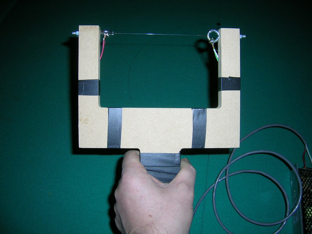

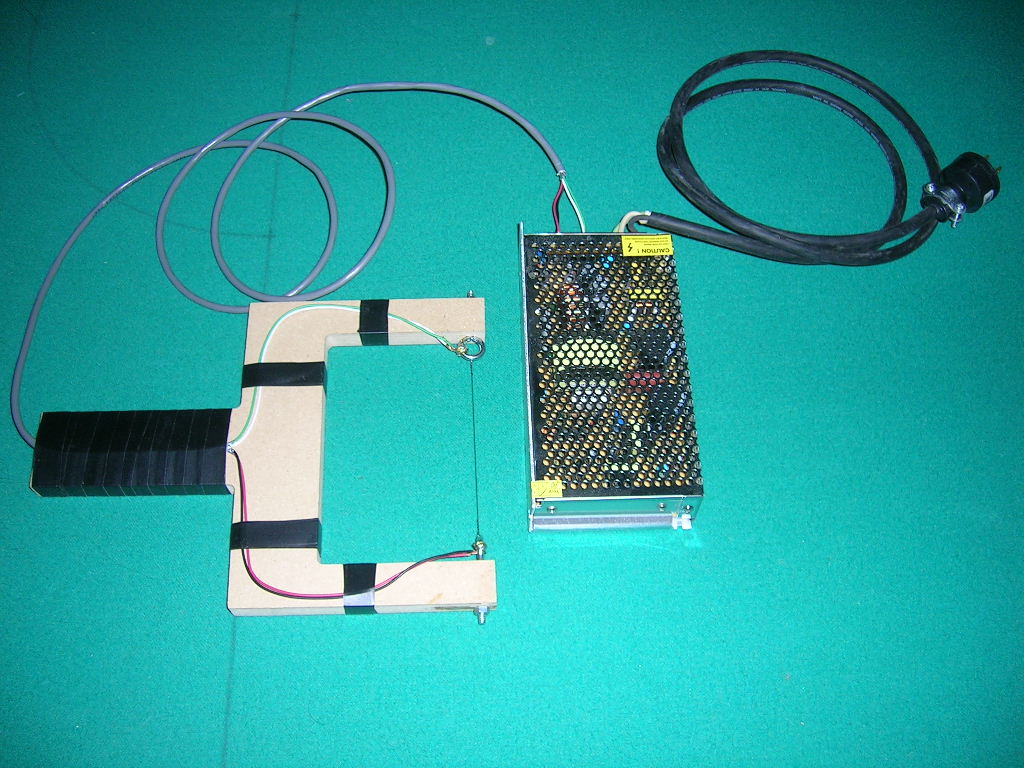

I was in need of a better way to cut foam along wood edges so I finally decided to make a small hand-held hot wire cutter. Here are a few pics. Works awesome and only cost a few bucks to make.

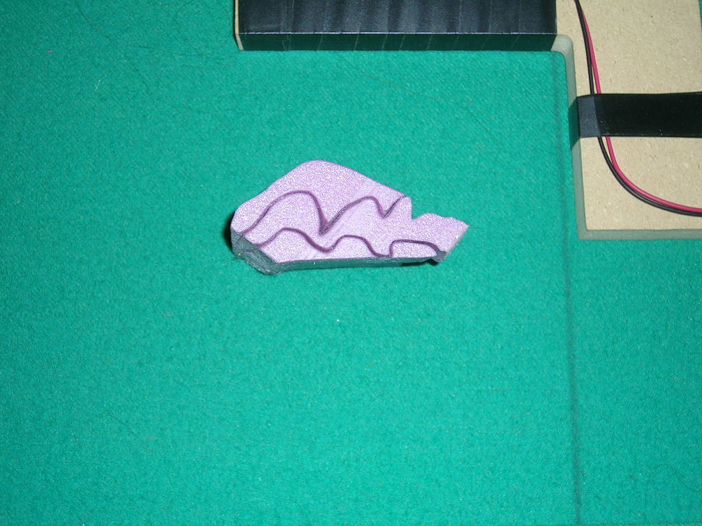

I made the frame out of wood...you can use just about anything non-conducting. A lot of guys use pvc pipe and fittings. The wire: seen a lot of different opinions on this, but I decided to try with stuff I had around the house. This one uses a guitar string quite simply! It's .009". A couple eye bolts, some 18ga electrical wire (I doubled the leads, only because it was 4 conductor cable so why not) and a 12 volt, 15A power supply I had laying around. You can get these on Ebay for cheap. The Power supply has a voltage adjustment screw...good thing cause at 12v the wire would burn up! I dropped it down and tuned the voltage to get a nice easy cut in 2" foam. Turns out 5v is about spot on for my application. Did a few quick test cuts as you can see in the pics. Cuts through it like butter and leaves a nice smooth finish! :laugh:

Do you have too worry about foam residue sticking on the wire causing problems ?
Pretty neat gadget you have built there Marc :woohoo:
#14375
marc replied the topic: Re: Hot Wire Foam Cutter
Not at all Scott, burns right off within a matter of seconds! It's a very thin wire...gets really hot real fast, and the nice thing about it is it also cools down just as fast...within 2-3 seconds of powering it down you can touch it no problem.

isuzudude replied the topic: Re: Hot Wire Foam Cutter
That's exactly how I did mine, but I use a regular car battery charger and it works great too!! B) Just flip the switch to jump start and you're good to go!!!!!
