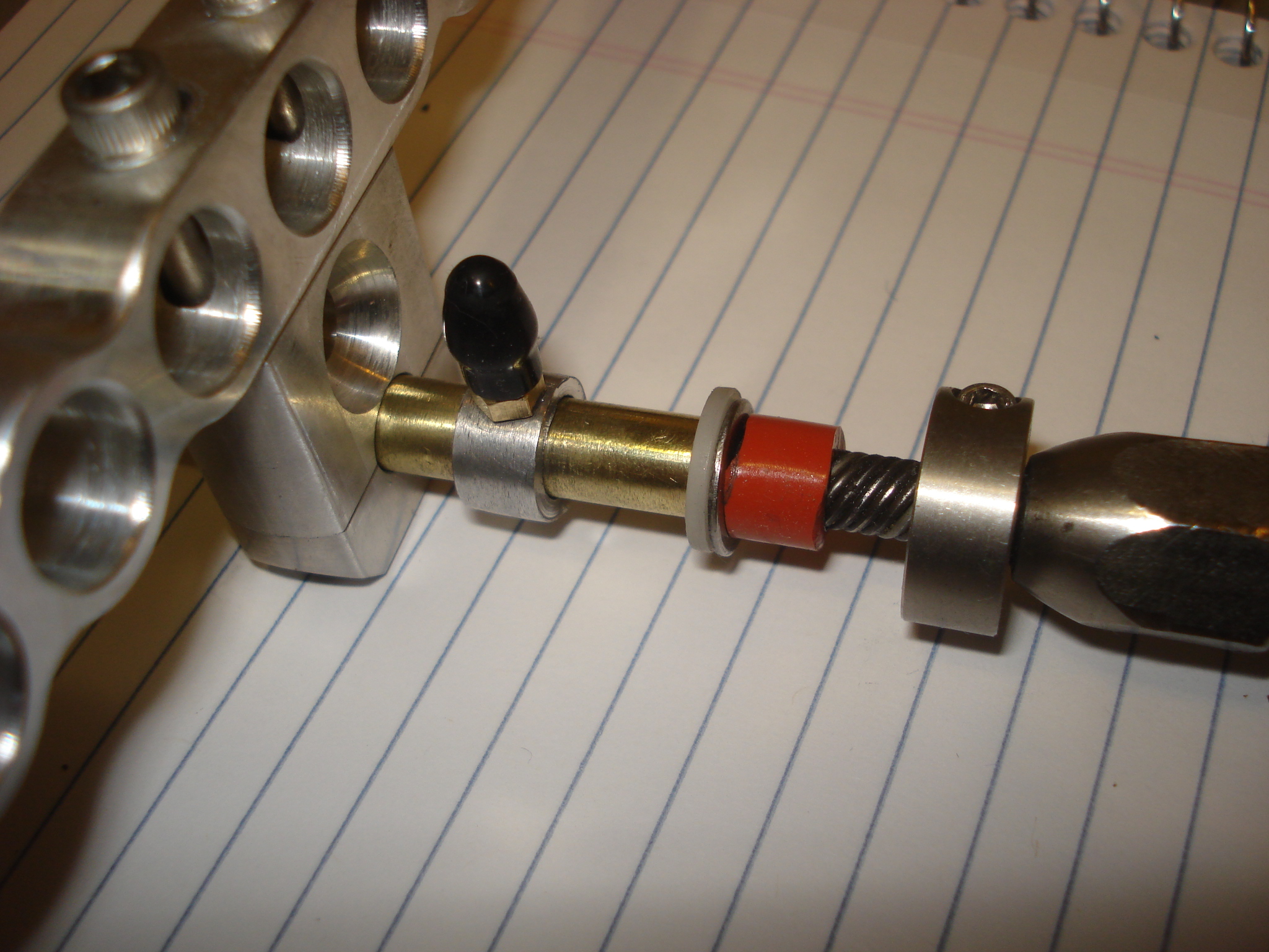

To make it even easier .... I noticed this in my tool box (old Arrow Shark shaft saver - alum )
cgi.ebay.ca/Arrow-Shark-Shaft-...=item518f747055
Already has one 1/4" center hole and a M4 side bolt/screw - mine's a used 1
opened it up (slowly ...) 1/4" to 5/16" [img] u could open up with files or hand grinder too ...... http://www.modelgasboats.com/media/kunena/attachments/legacy/images/DSC04151.JPG[/img]
to keep this simple I retaped (cleaned threads) hole to M4 and used a short M4 fitting - I taped 5/16" tubing with M4 too so fitting screws thru (need to deburr inside tube
no allen set screw on this one
I polished it and left one side Red so u could see the Arrow Shark one
simple and clean (I think........... :laugh:
later :laugh:
Oh and I use Red loctite on the fittings and set screw ( a touch of heat to take them off ..) and they seem to stay well

Canadian Hot Rod RC Boats replied the topic: Re: Simple Oiler or Greaser
I stop the oil or grease mess from inside by using a 1/4" nylon washer up against stuffing tube and usually put small pc hose or ziptie against washer to hold washer against tube
hose works better - but the nylon washer stops alot of the mess
I also only use .029 wall tubing so the M4 set screw on side of fitting barely makes a mark on tube - def does not 'dent' it
I use small containers so not a issue to drain it out
to grease just hold nylon washer against stuffing tube and with a needle tip (on grease gun I use) just pump it in ... then a antenna cap makes a good cover for nipple
