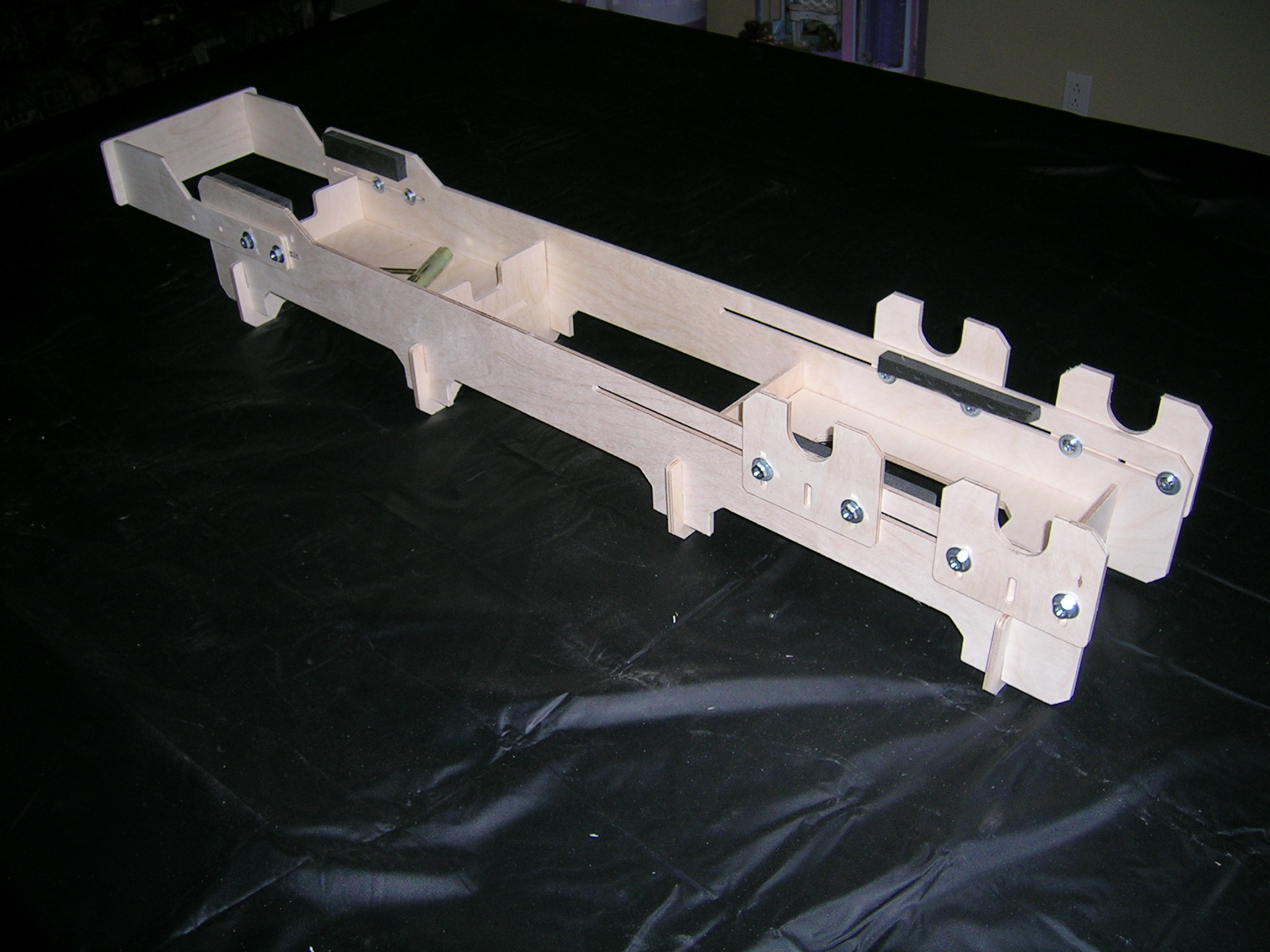

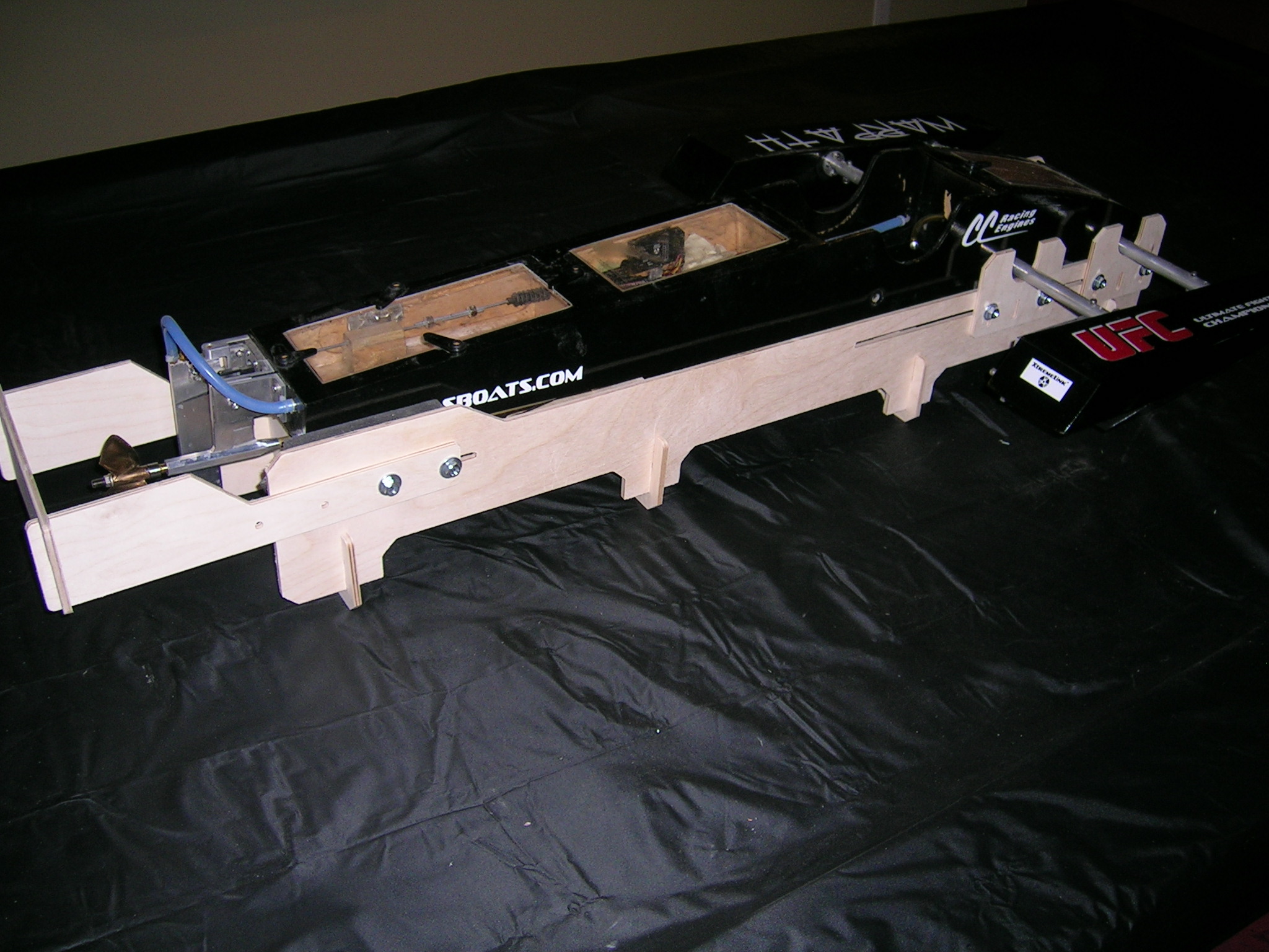

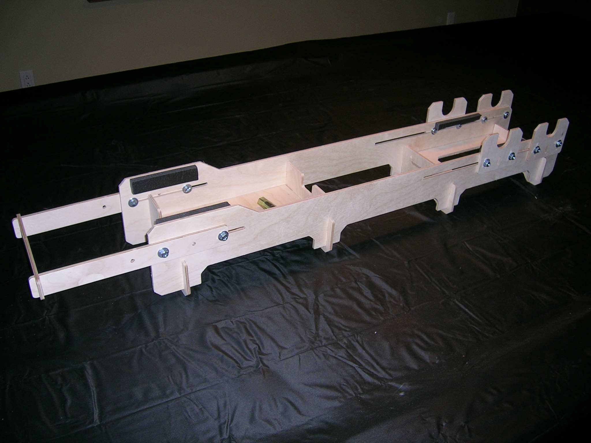

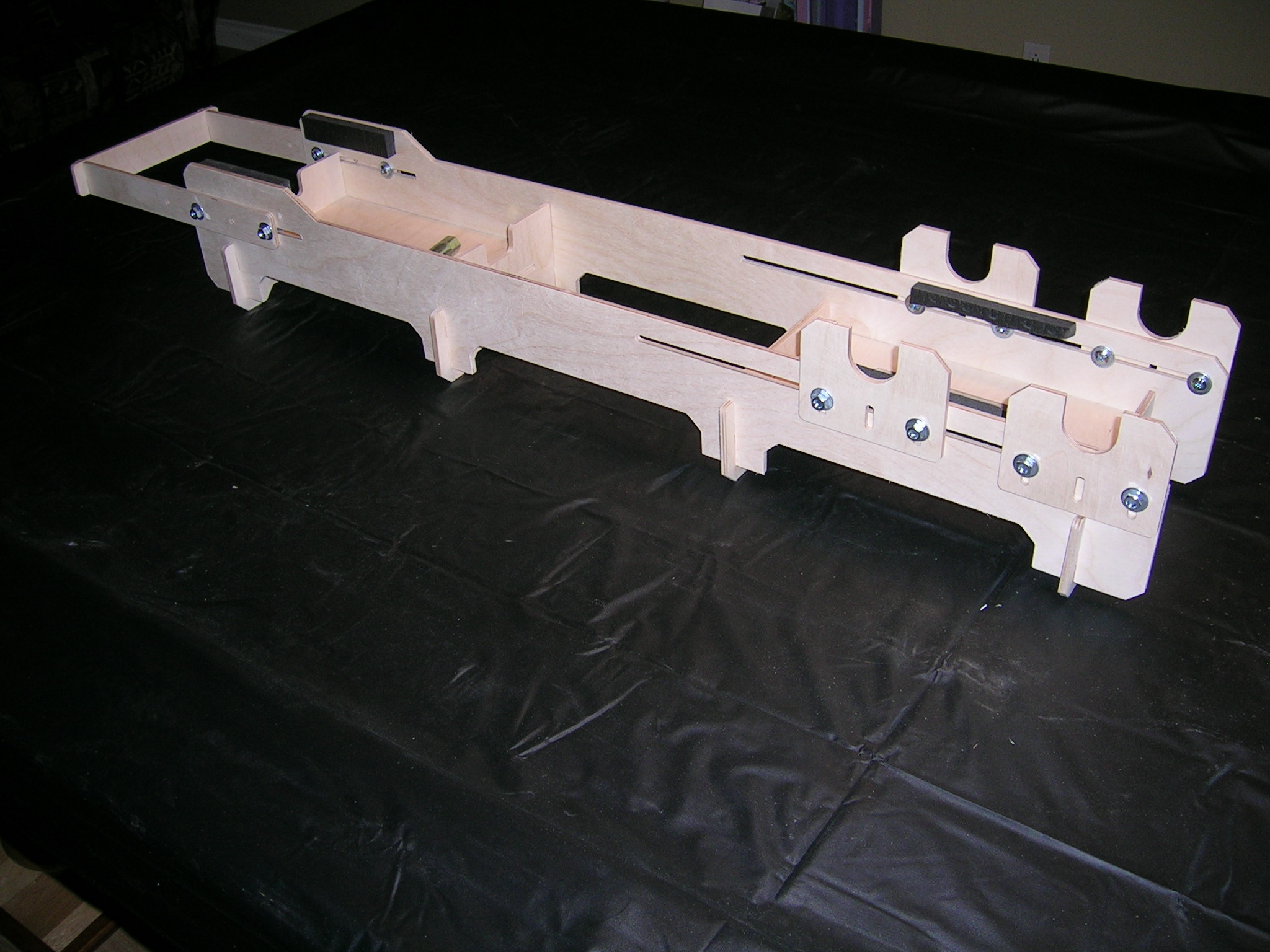

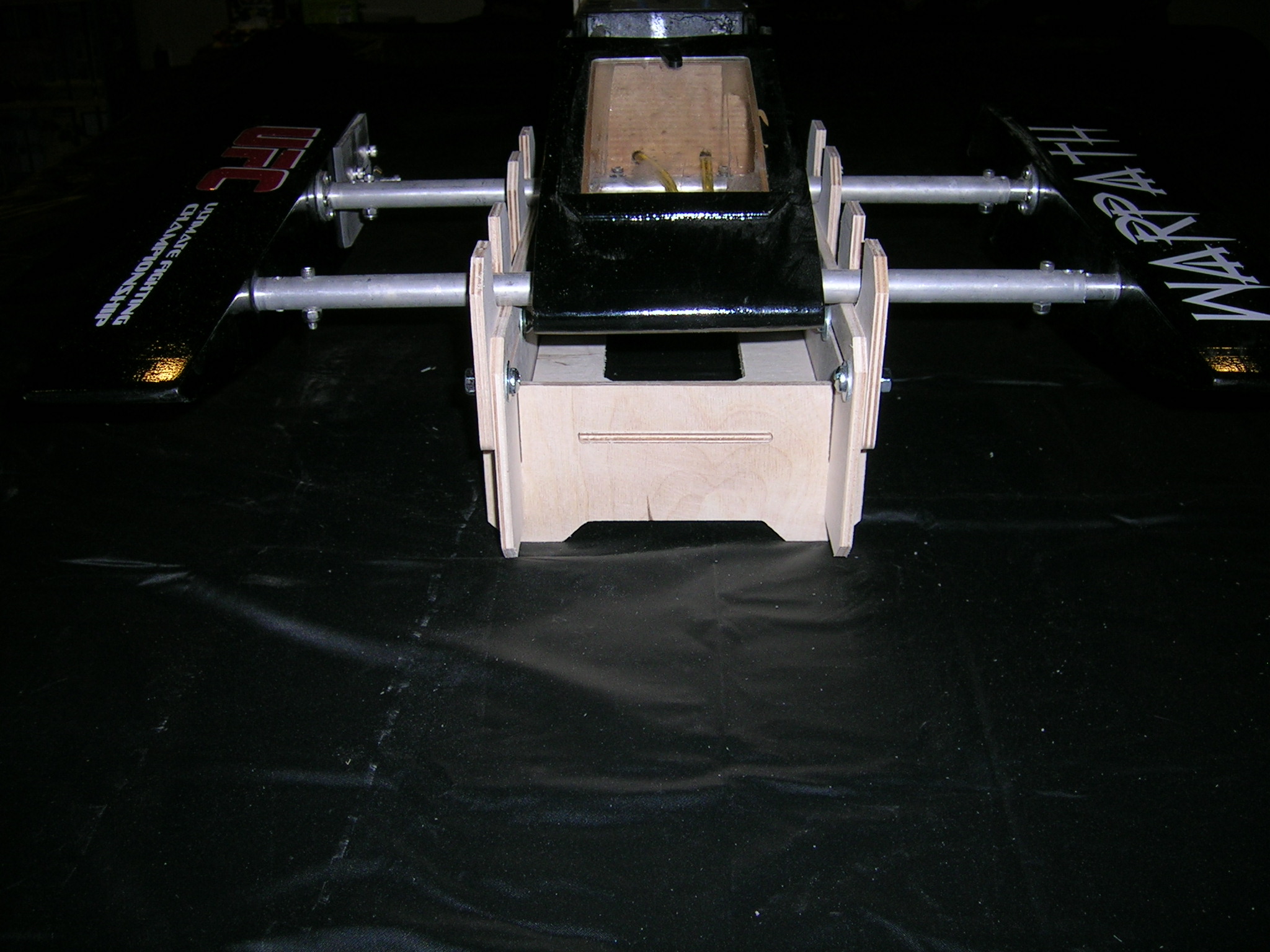

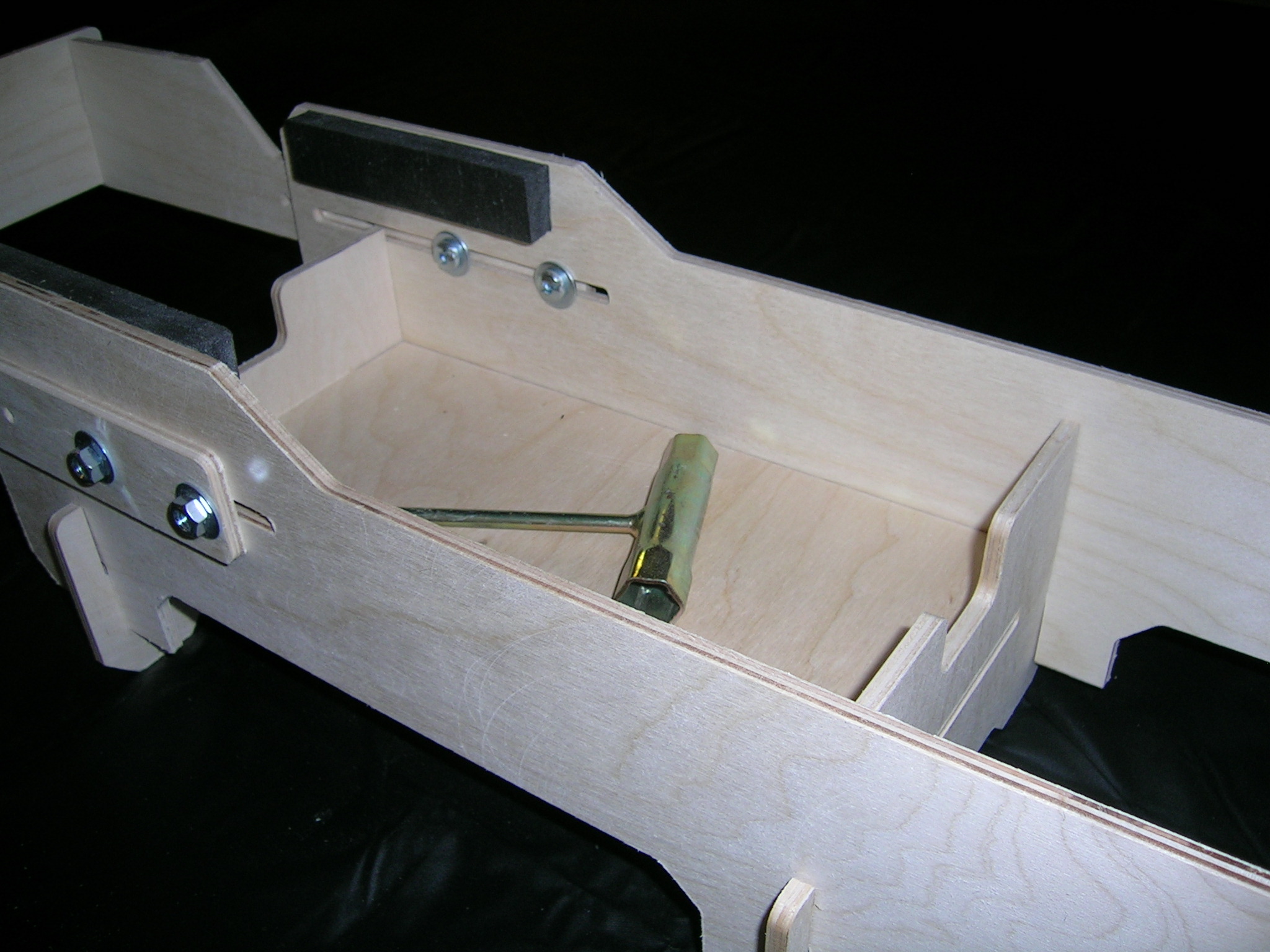

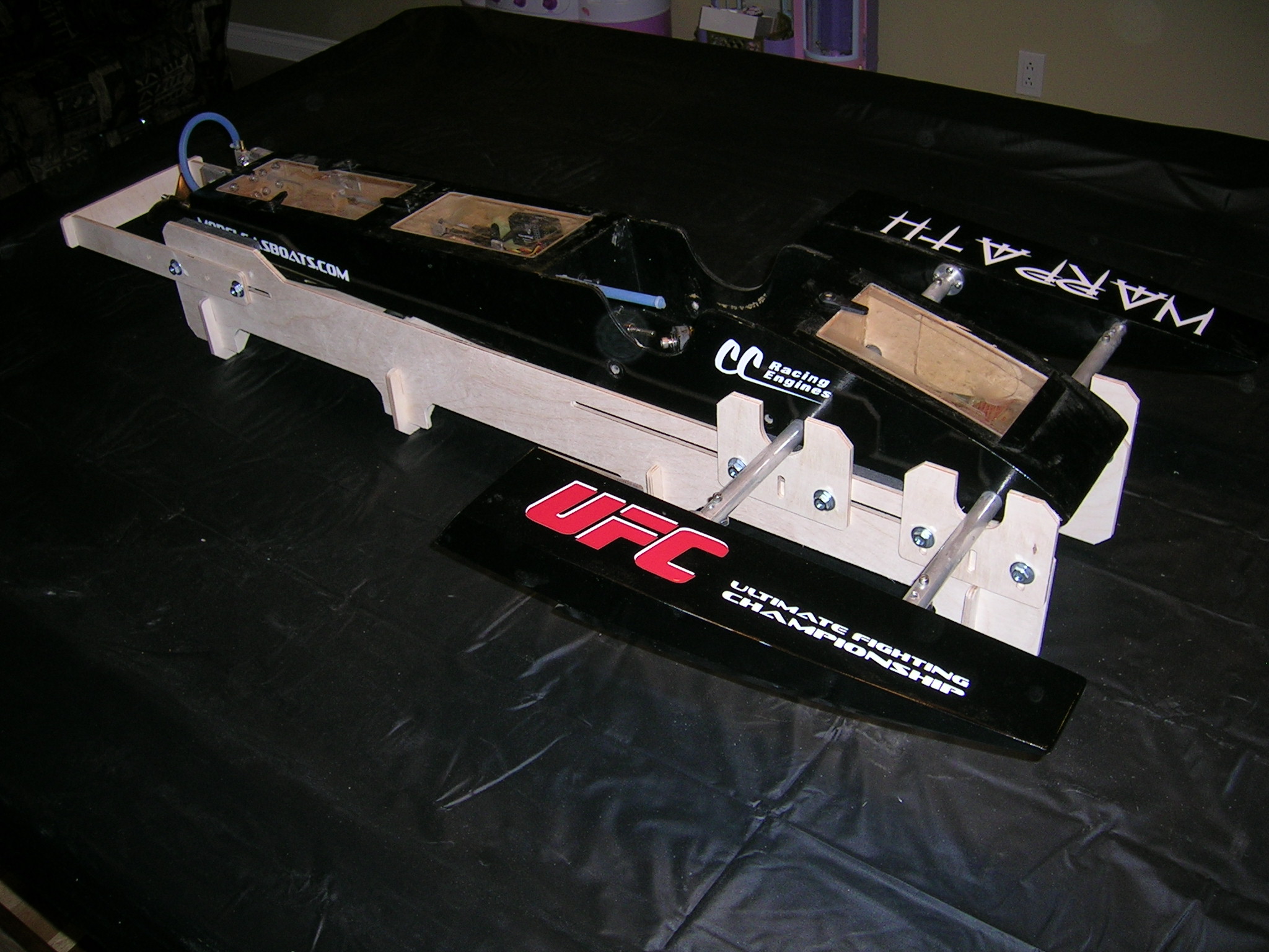

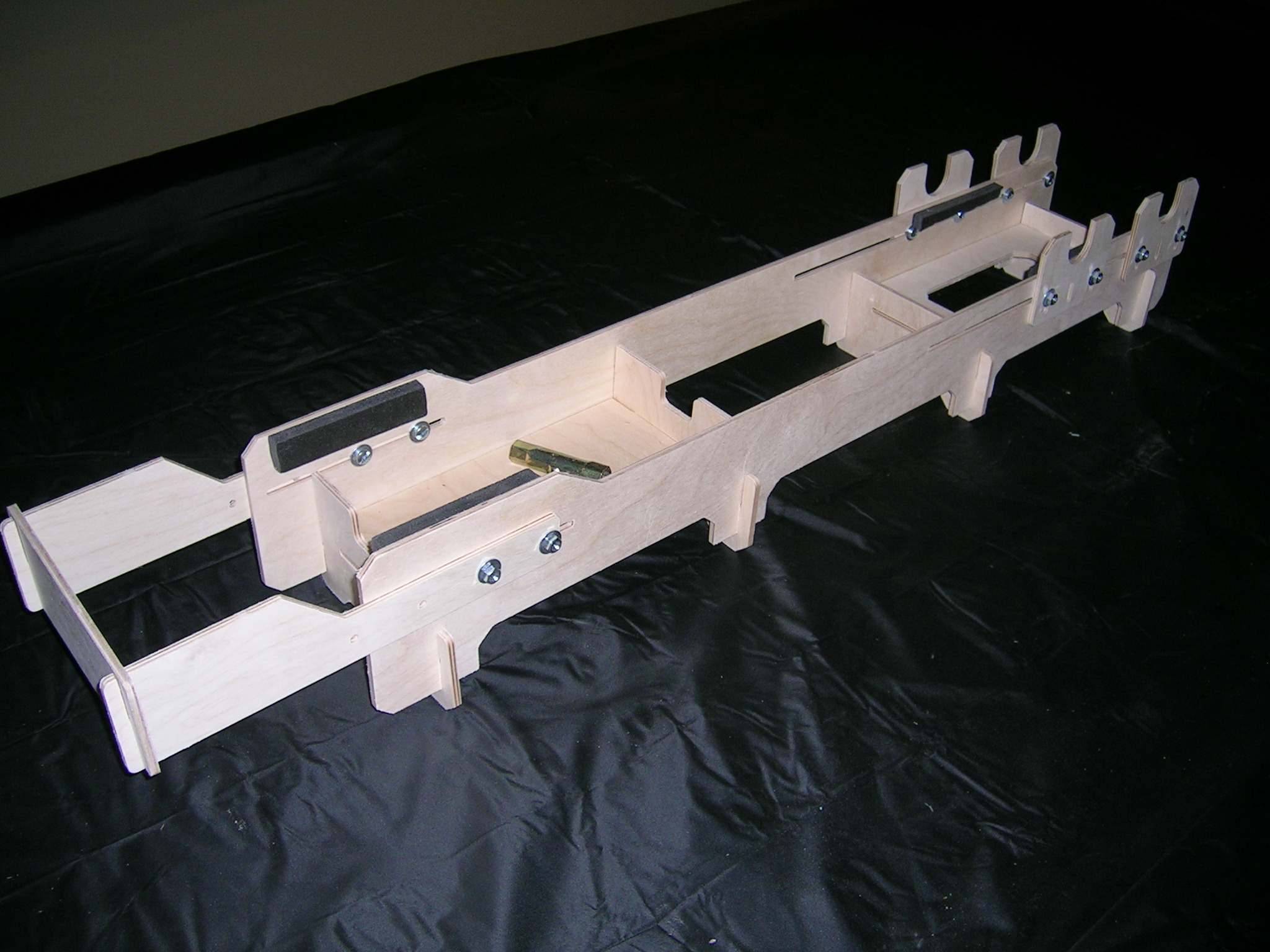

I was messing around with some ideas last night and came up with what I think to be an original concept in boat stands. This one pictured is for outriggers with tub width of 5.5" or less with NO rear outside sponsons. (inner spacing of stand is actually 6"). This covers a great range of outriggers on the market today!
Features:
    - all CNC cut quality birch plywood.

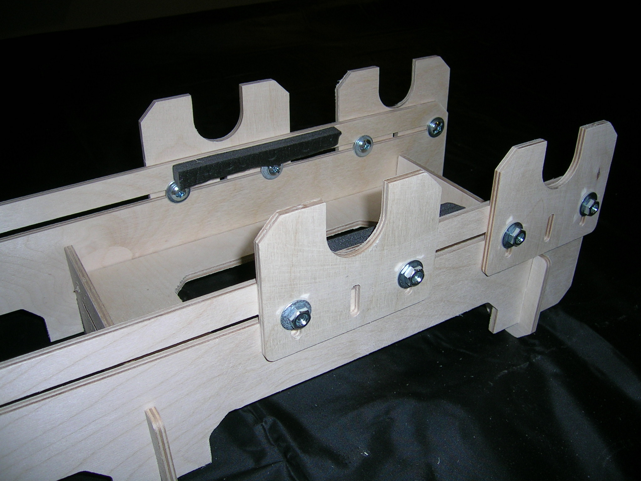

    - adjustable boom tube supports from 4.5" to 15.5" spread between booms
    - 16" of lateral movement possible for the boom supports on the stand itself
    - Boom tube supports can be adjusted up/down 5/8" also
    - adjustable/removable prop guard

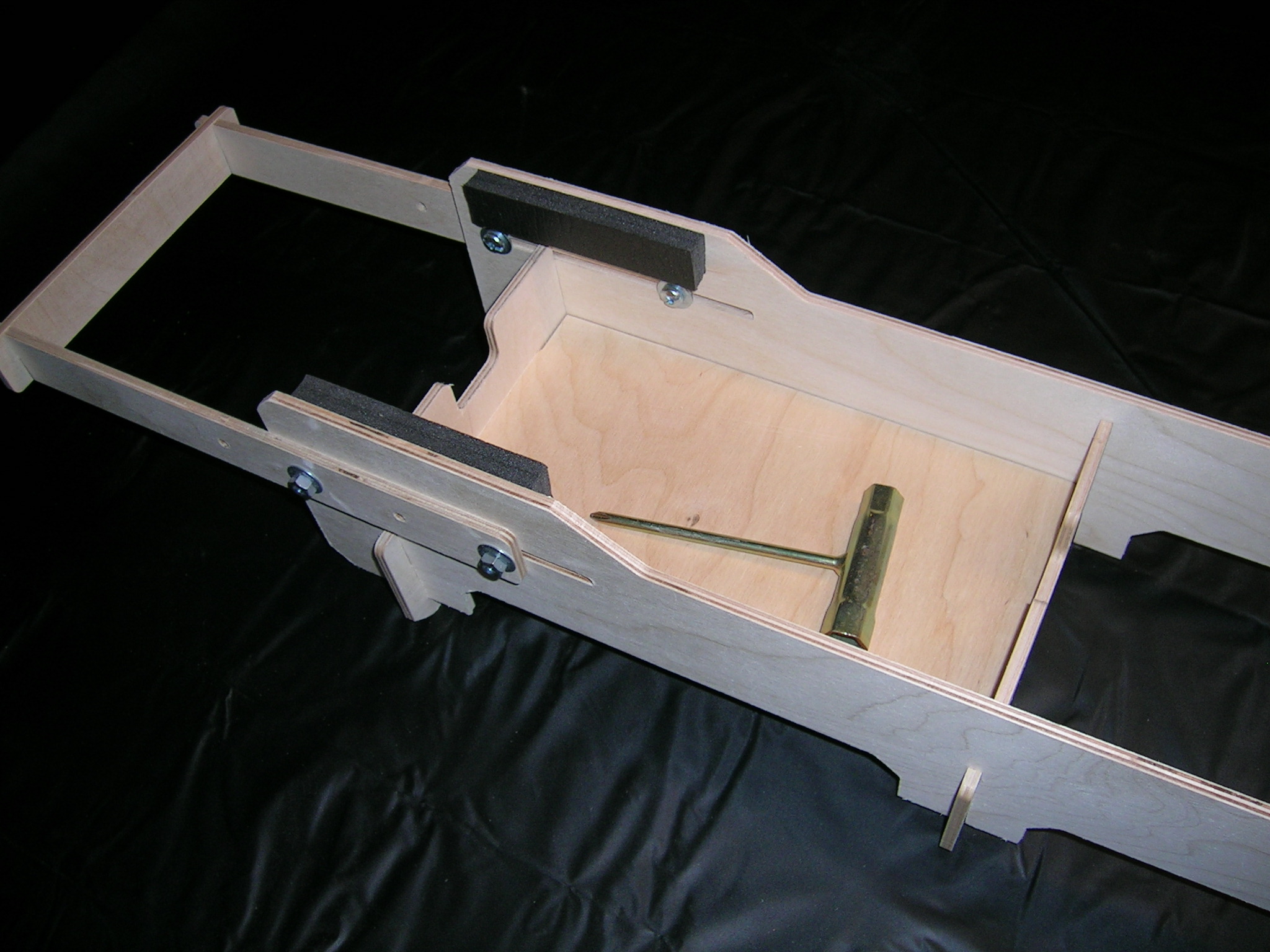

    - built-in storage compartment in rear of stand
    - max spacing from front tube to prop guard is 47"

Great concept you have there, tho think most single rigger tubs run 5" inside and 5 3/8" - 5 1/2" outside tub dimensions ?
Tho for your Warpath and some that fit a killer stand !!
** Would however make it so the prop end of stand has a more vertical panel as a PROP GUARD ;)

I should have specified, but the inside spacing of the stand is actually 6". With the 1/2" foams its perfect for 5" outside tubs... for slightly wider tubs, simply use thinner foams. :) So it should adapt well to most riggers.
I will make a higher prop guard plate for the rear... I noticed that also. Thanks for your constructive feedback...always appreciated!
