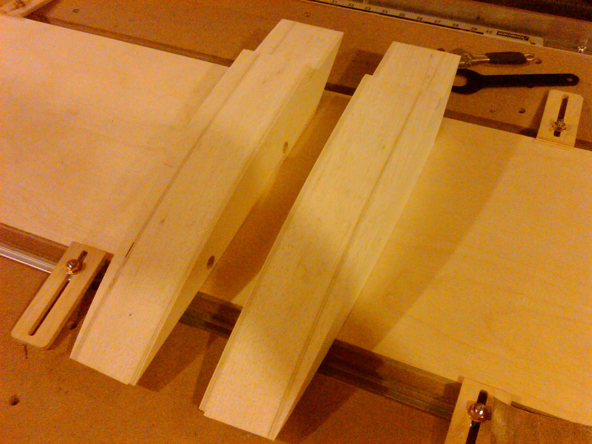

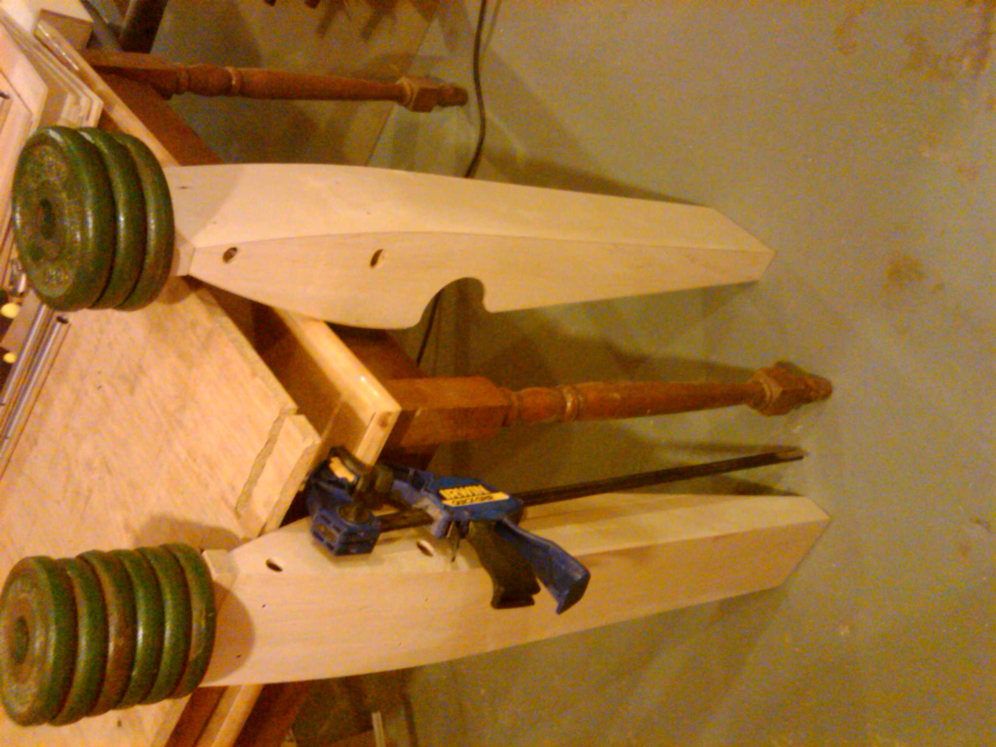

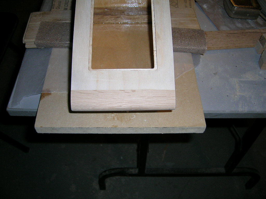

marc replied the topic: Re: Warpath for Andrew "Faster" Castan - Australia
Just got back from a weekend at the cottage. Got a little bit more done... Sorry about the color of the pics...shot with Blackberry.

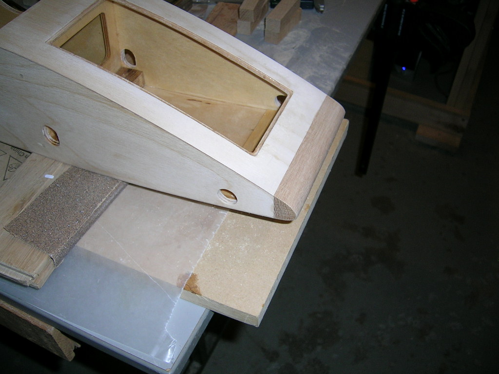

Pic1: Gluing the oak nosepiece on the tub.

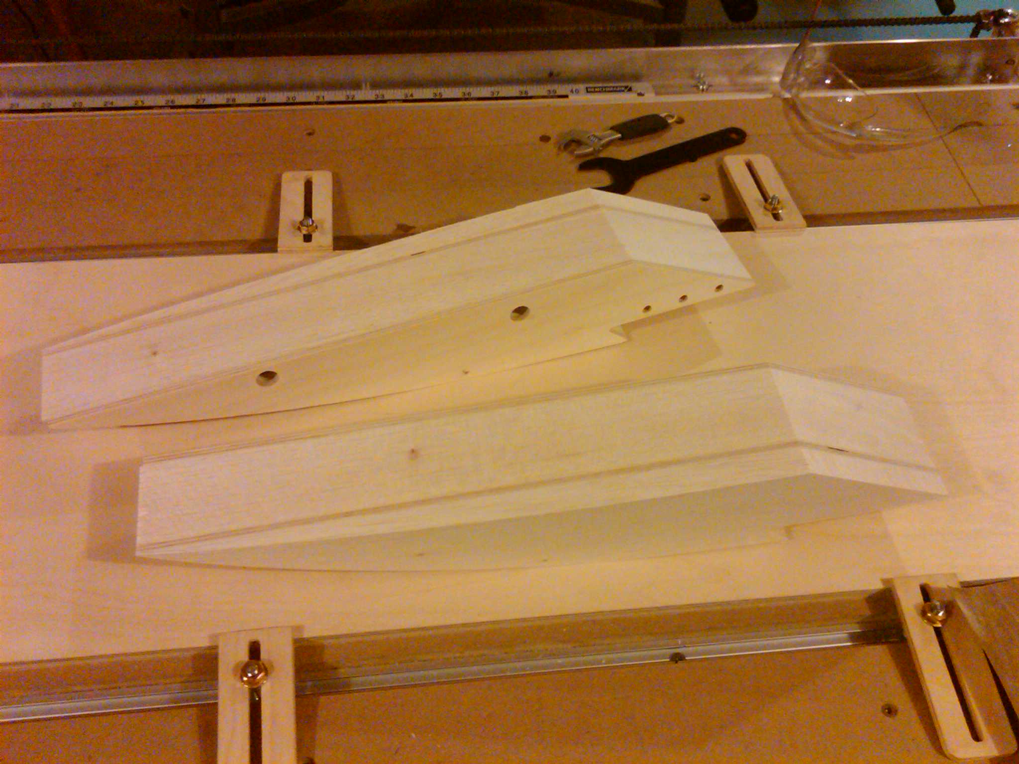

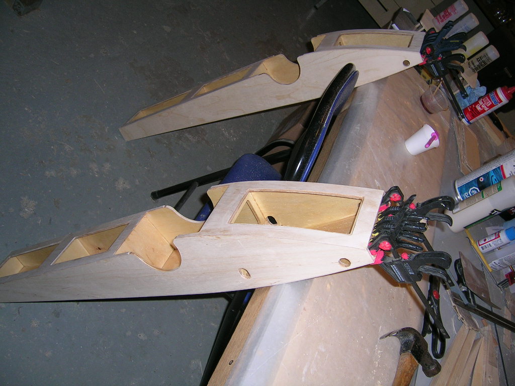

Pic2 and Pic3: All balsa done and sanded on sponsons...ready for sheeting.

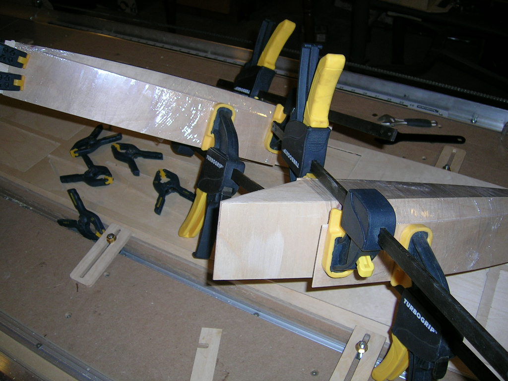

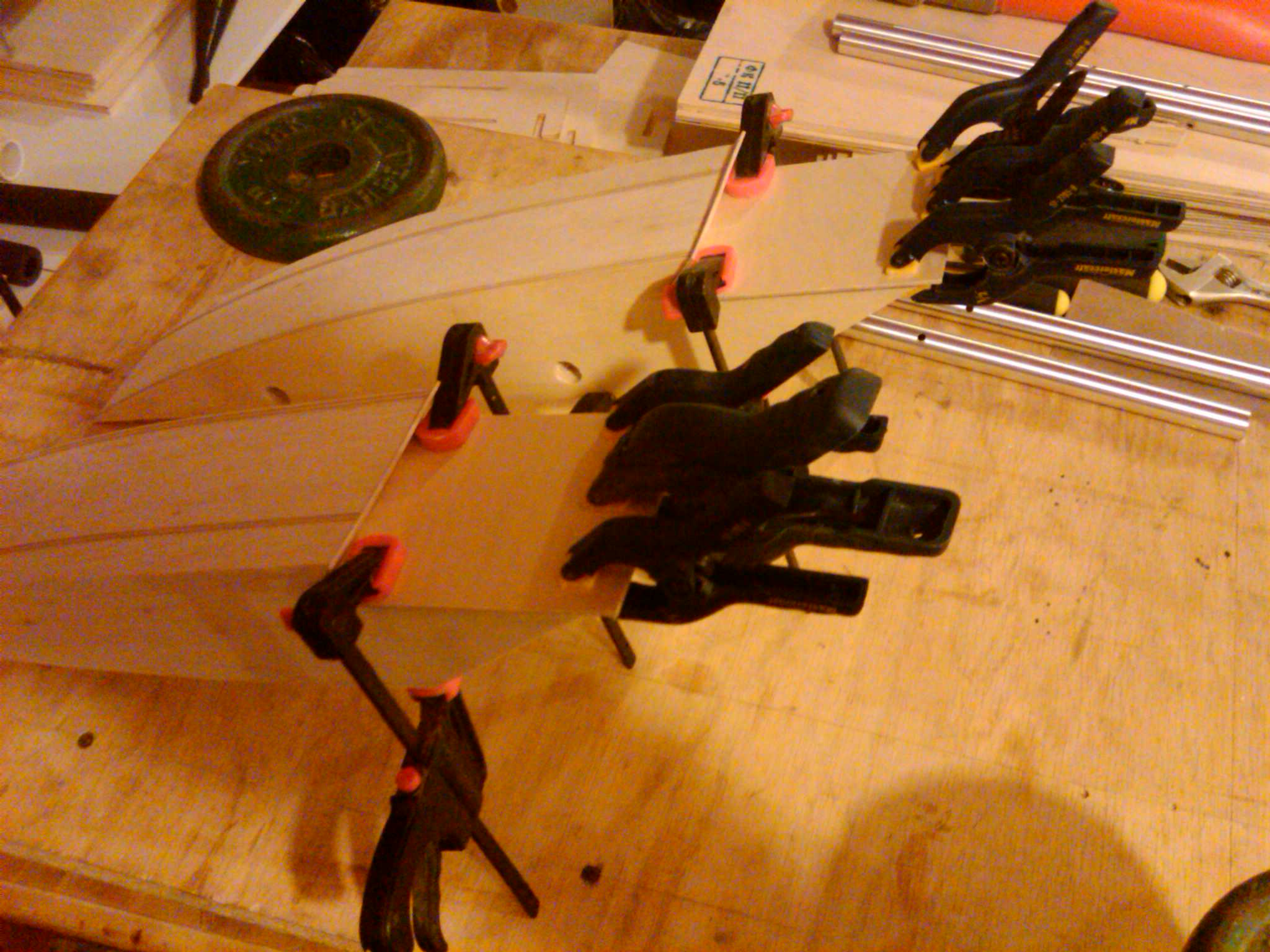

Starting the sheeting process.

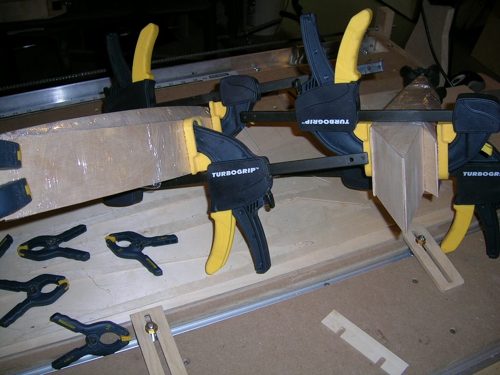

#17017

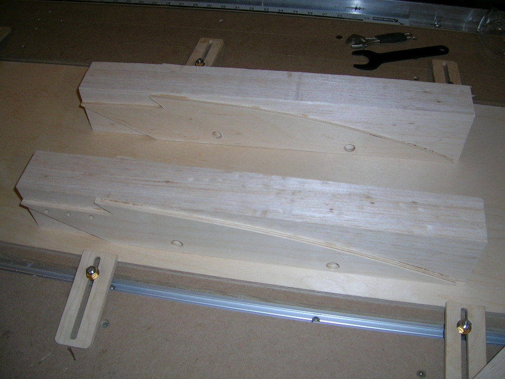

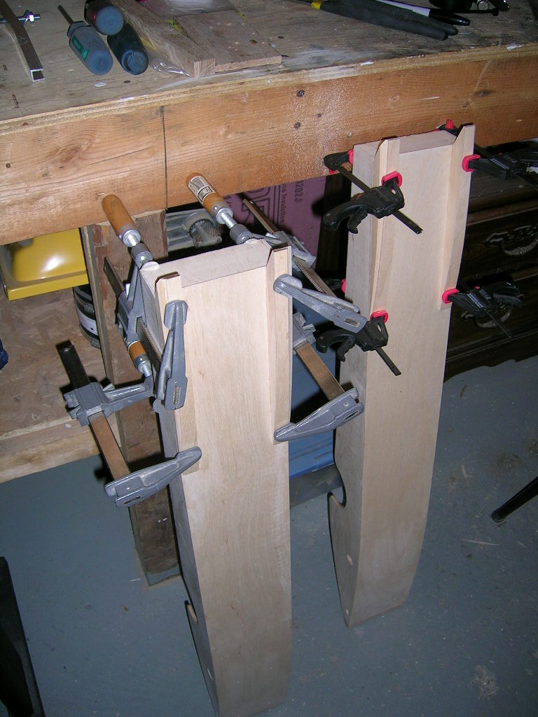

Some progress...
