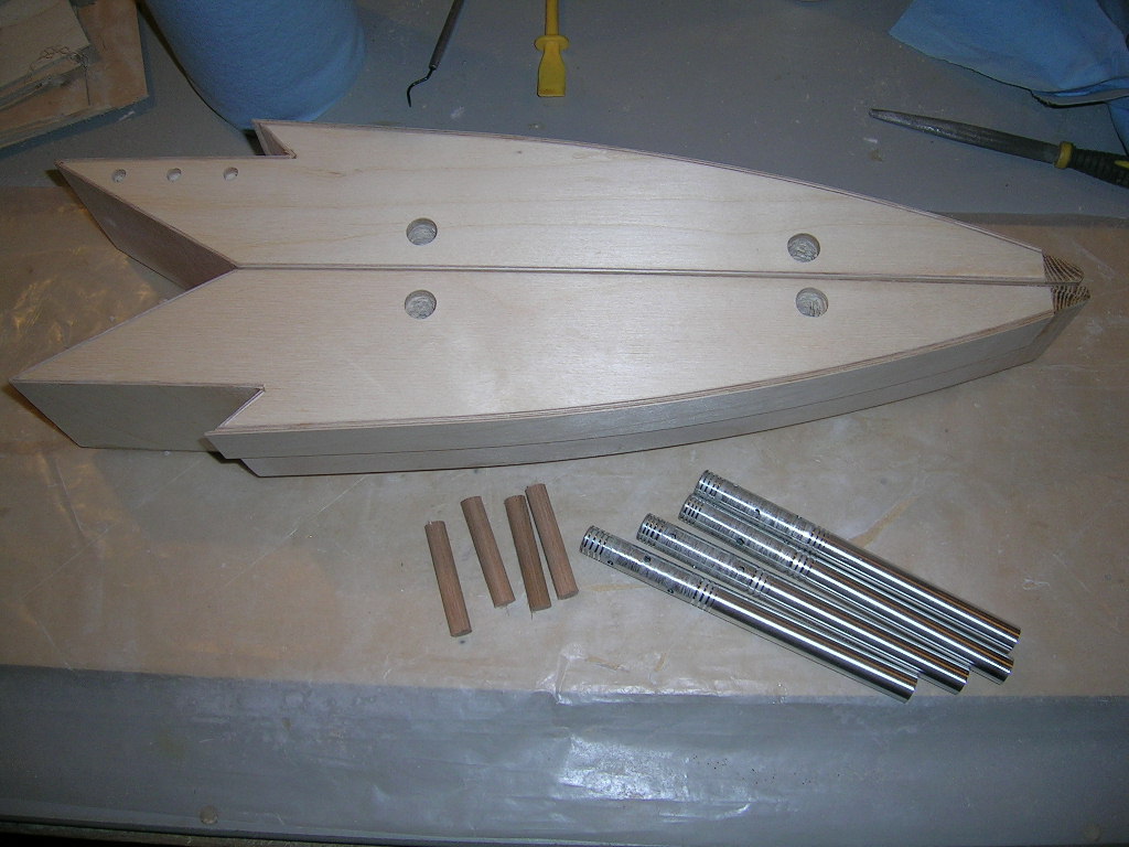

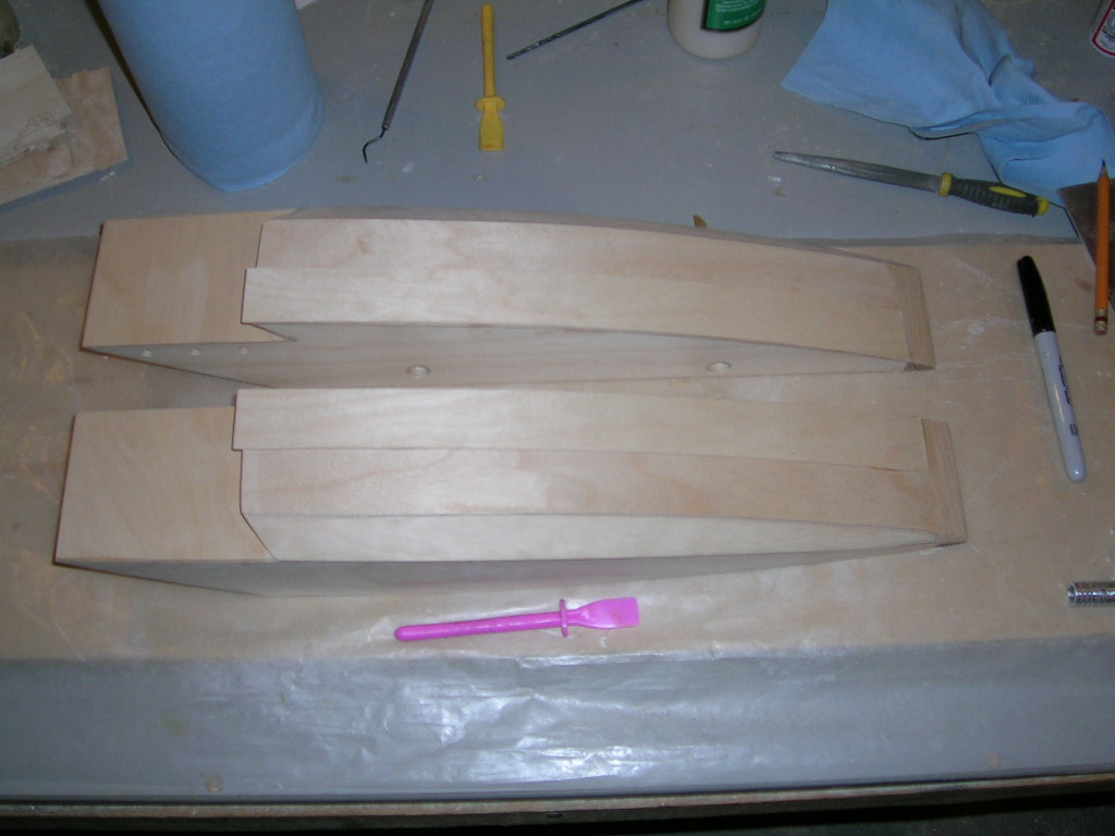

Going to put in the sponson pins in the first set of sponsons. Using West Systems epoxy and hardwood dowels to push it in and through the openings in the tubes inside the sponsons. Makes a very solid bond.
#17059
marc replied the topic: Re: Warpath for Andrew "Faster" Castan - Australia
Curing...
#17060

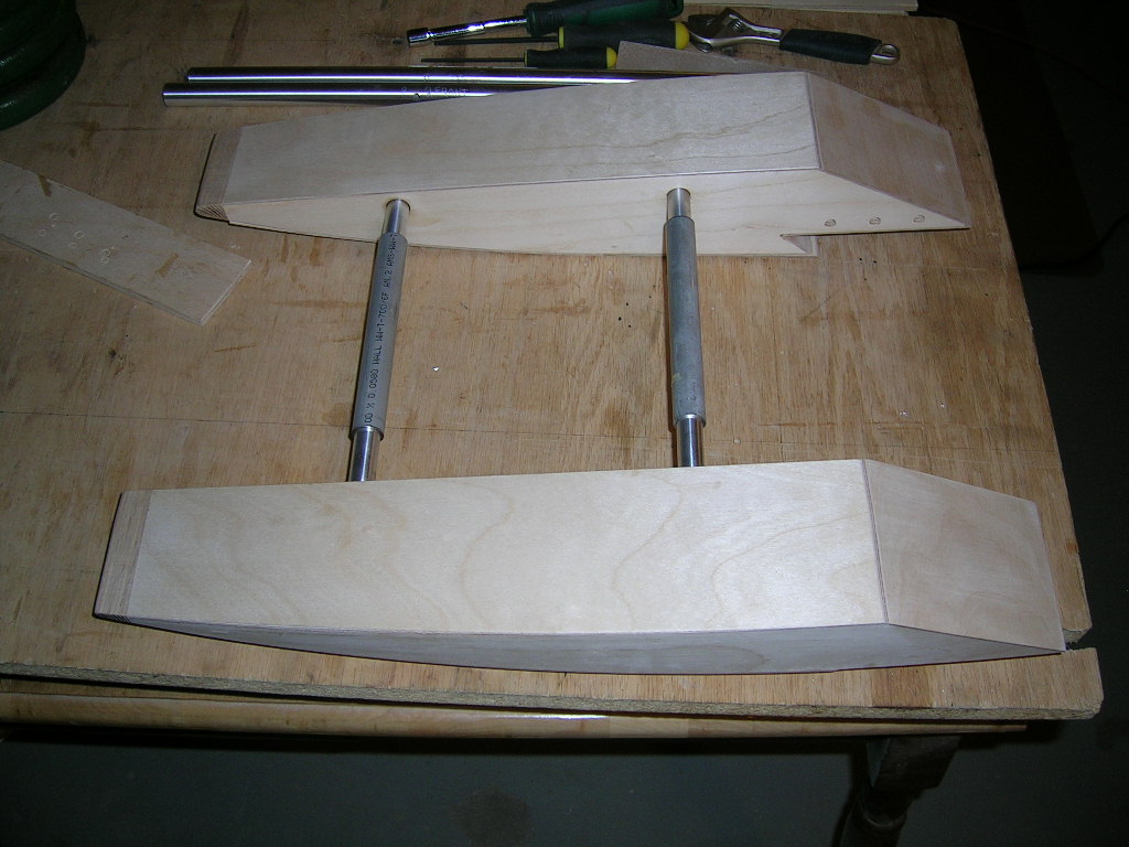

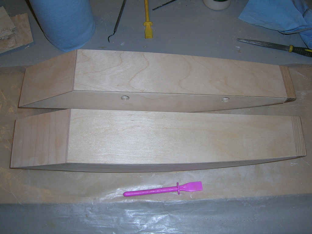

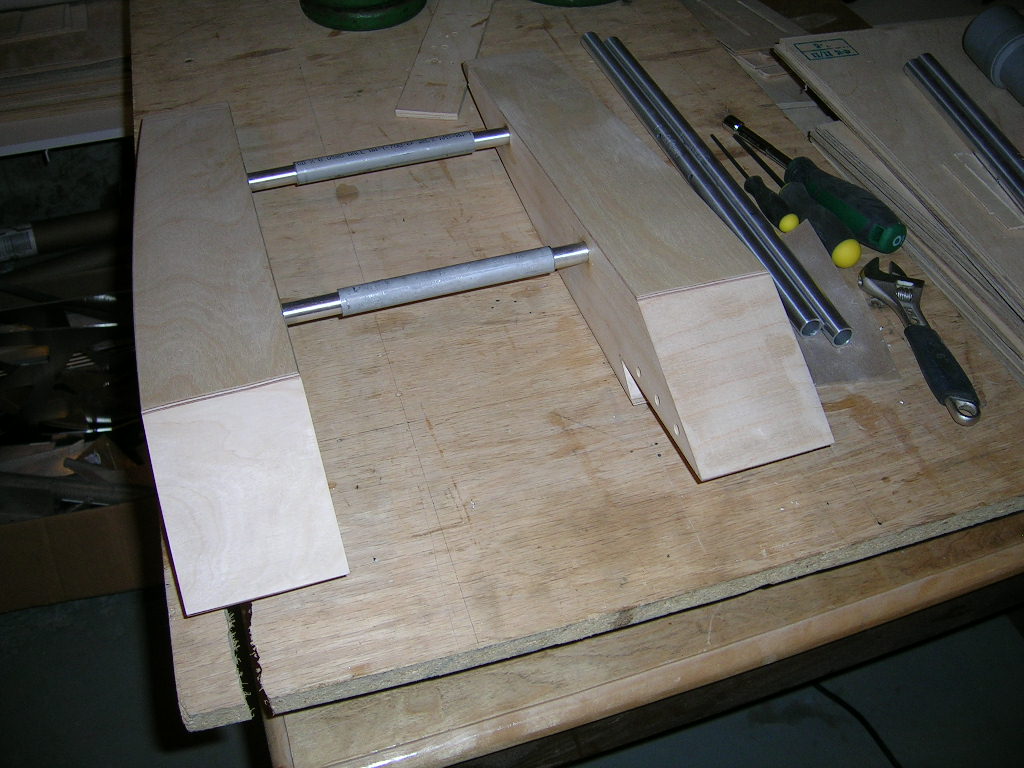

First set of sponsons done.
#17069
