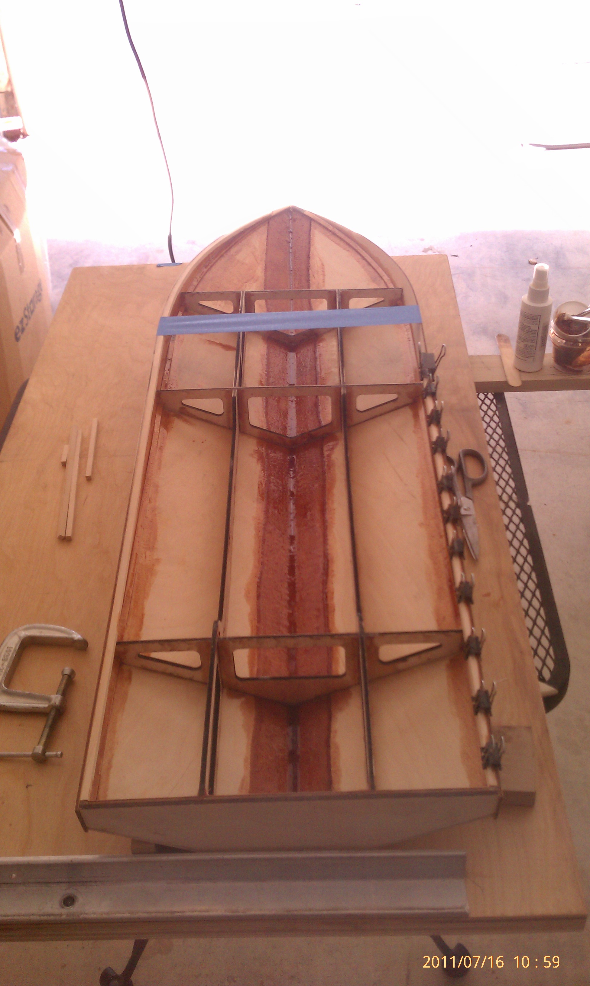

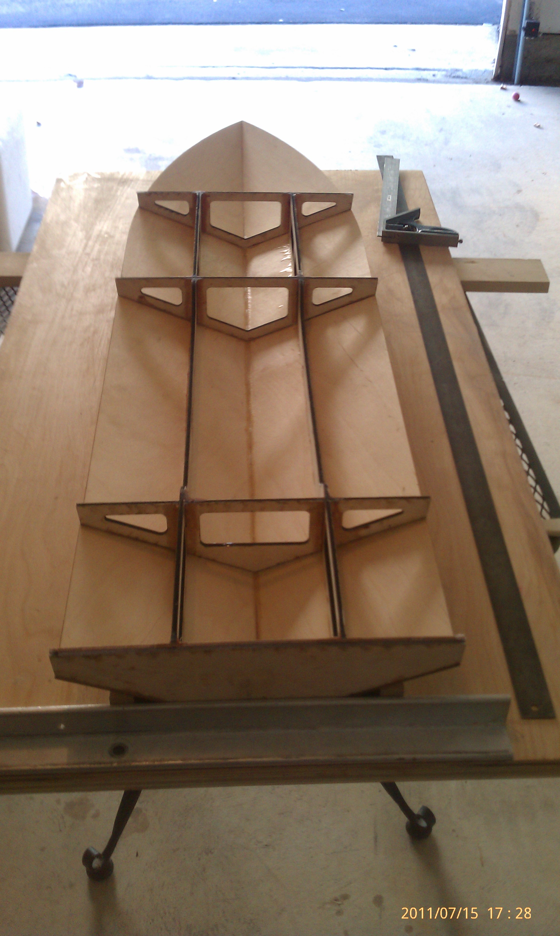

Hello everyone,
Here are some pics of my Prowler Mono. This is my first mono and my first gas boat. With that being said, I have no idea how high to set up the drive above the keel on a boat this size. 3/8", 1/2", 5/8"? Thanks for looking and any advice will go a long way.
Sean

marc replied the topic: Re: My first build on MGB
Nice build! :)
I like to make it so the prop centerline can be adjusted somewhere in the 3/8 to 1/2" range and tune it at the lake. I'm sure other guys will chime here too.

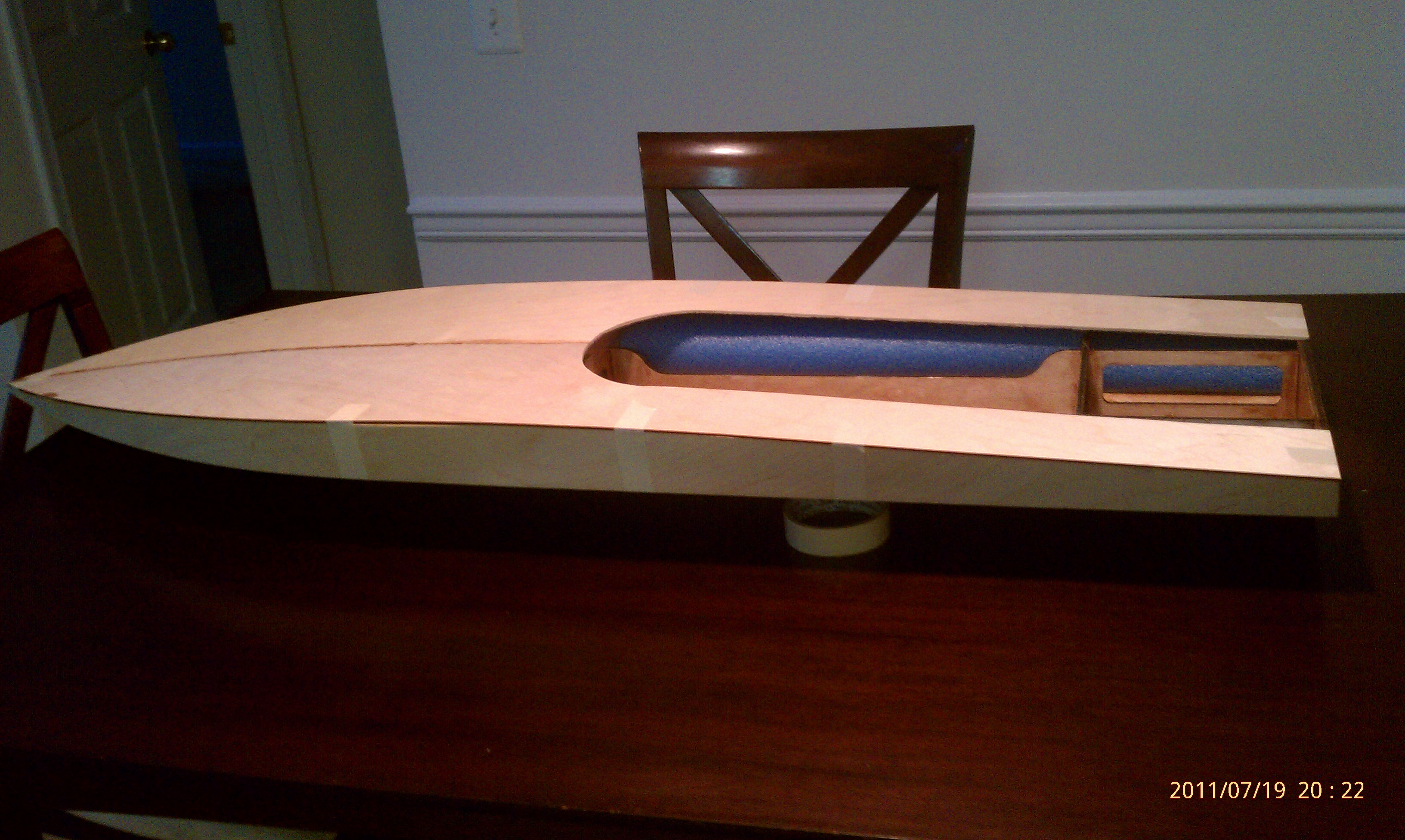

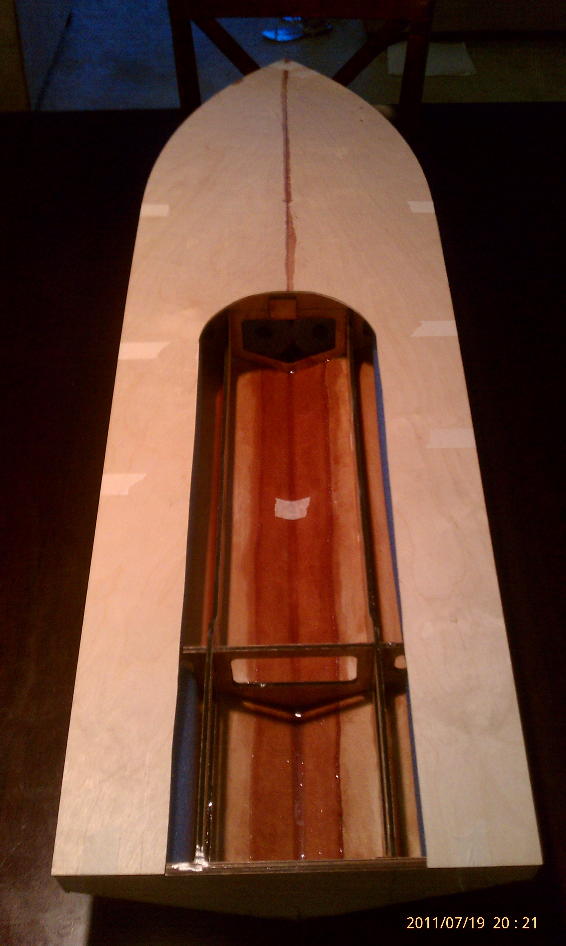

seanx450 replied the topic: Re: My first build on MGB
Thanks guys for the complements. I glued the deck on this afternoon. I'll be mounting the strut and rudder tonight. Marc I'll follow your suggestions for the stuffing tube.
