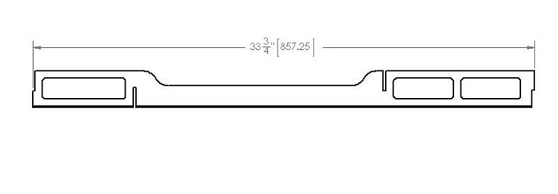

My interest is primarily the engine stringers. The contours
of the boat is determined primarily by having the stringers
(and frames) shaped correctly. The stringers on my templates
measure 853mm along the top edge and 851mm along the lower
edge (lower edge measured just above the 23 degree forward
bevel). Both of these measurements are very close to 33.5 in.
There is nothing wrong with cut and tape but having known
lengths to check against can be helpful. If Doug posts
stringer lengths that differ from my measurements then please
use his.

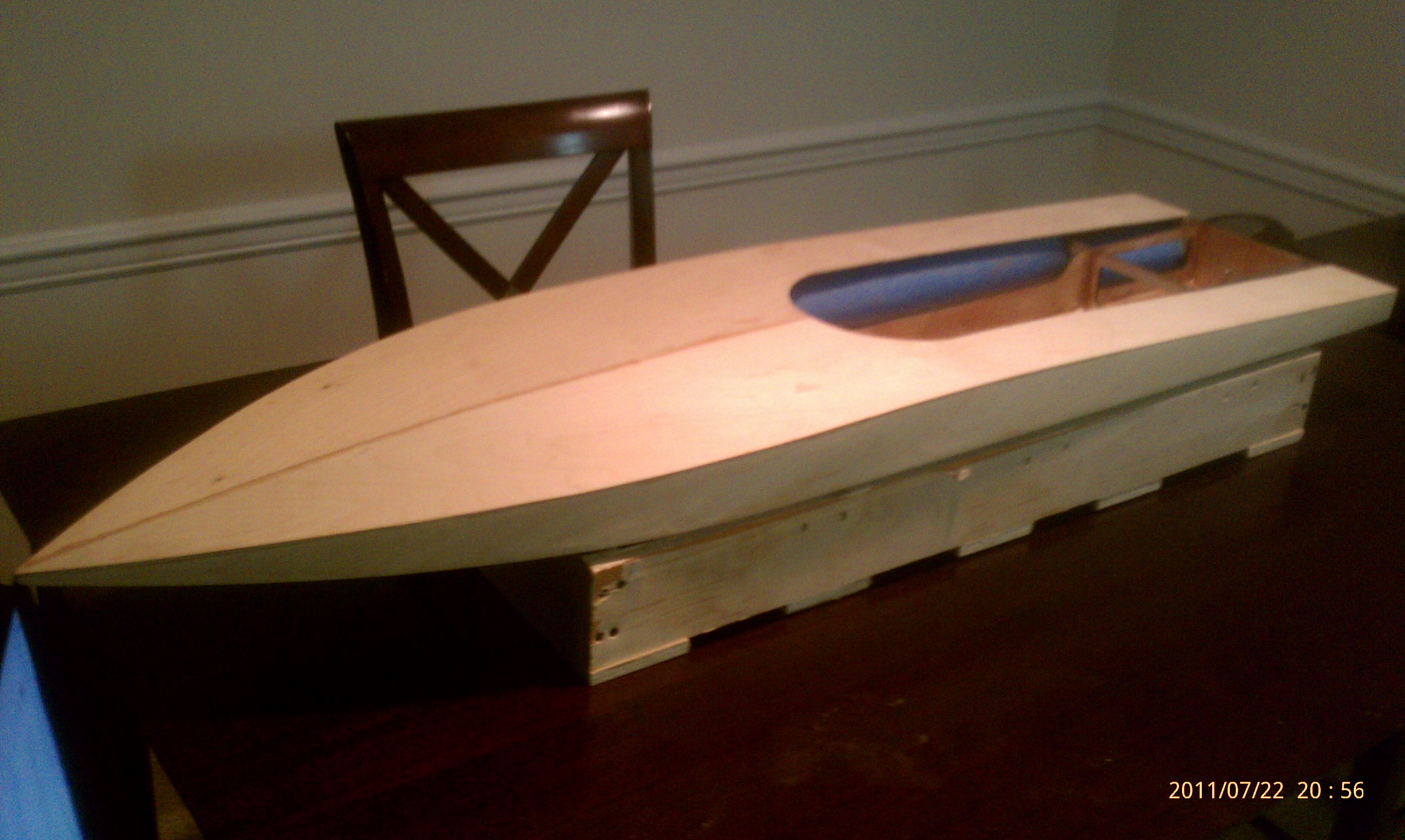

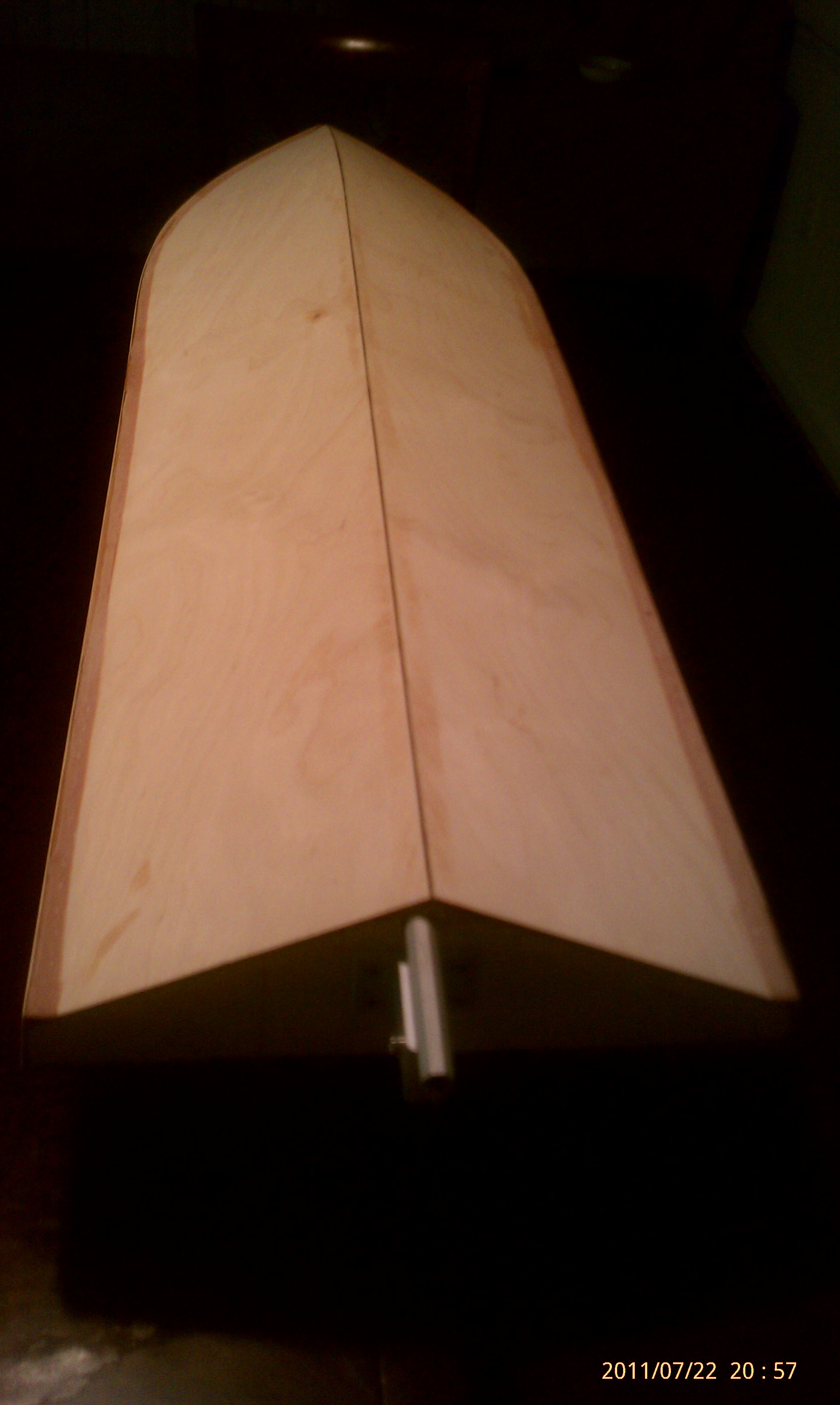

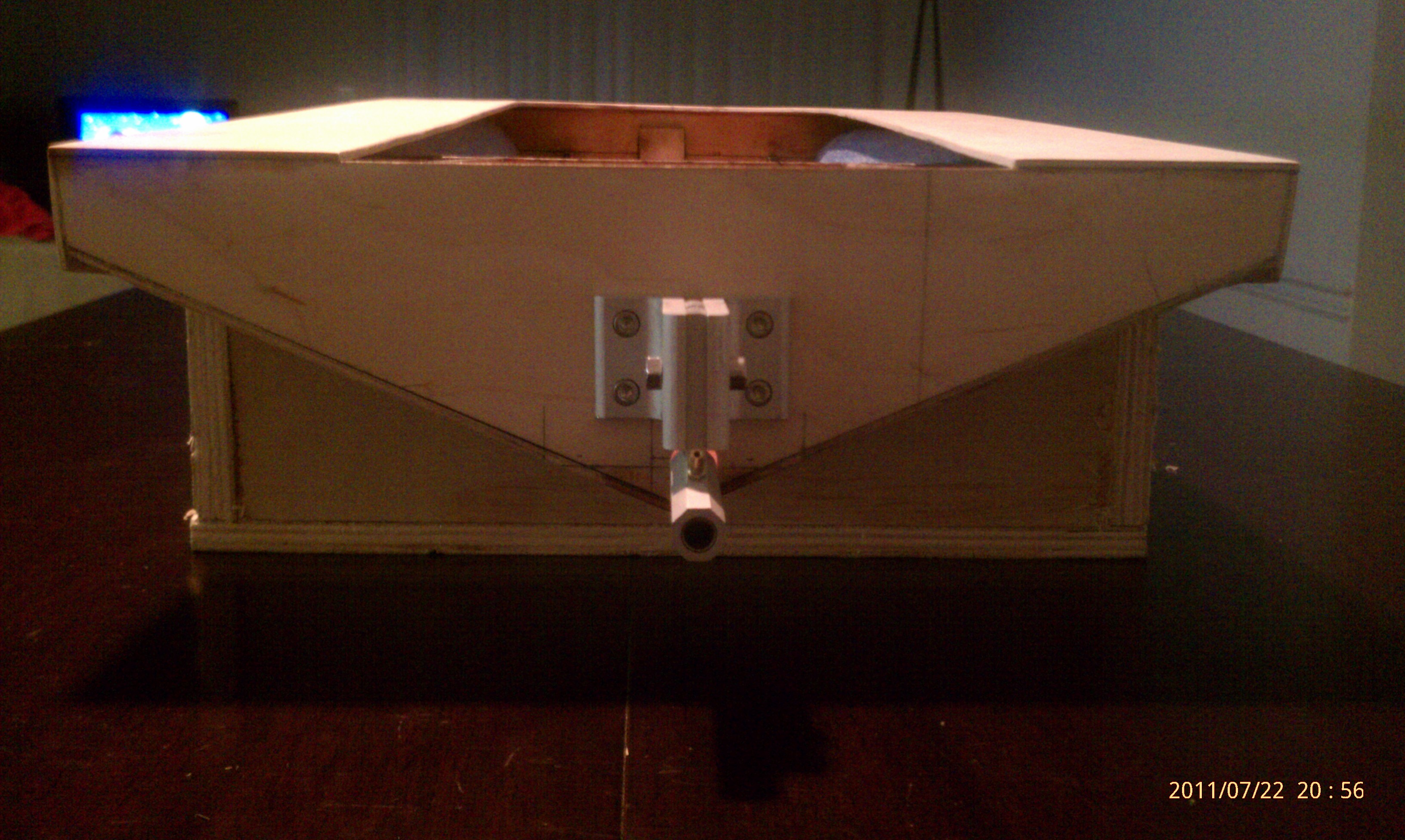

Well there's not much more to add at this time. I filled the spray rail with micro balloons and epoxy. It came out a lot better than expected. Trimmed the over hang from the deck to match the sides,installed the strut, also gave the entire hull a good sanding. Tomorrow morning I'll apply some epoxy to seal the hull. Just waiting for my trim tabs and turn fin to arrive.
