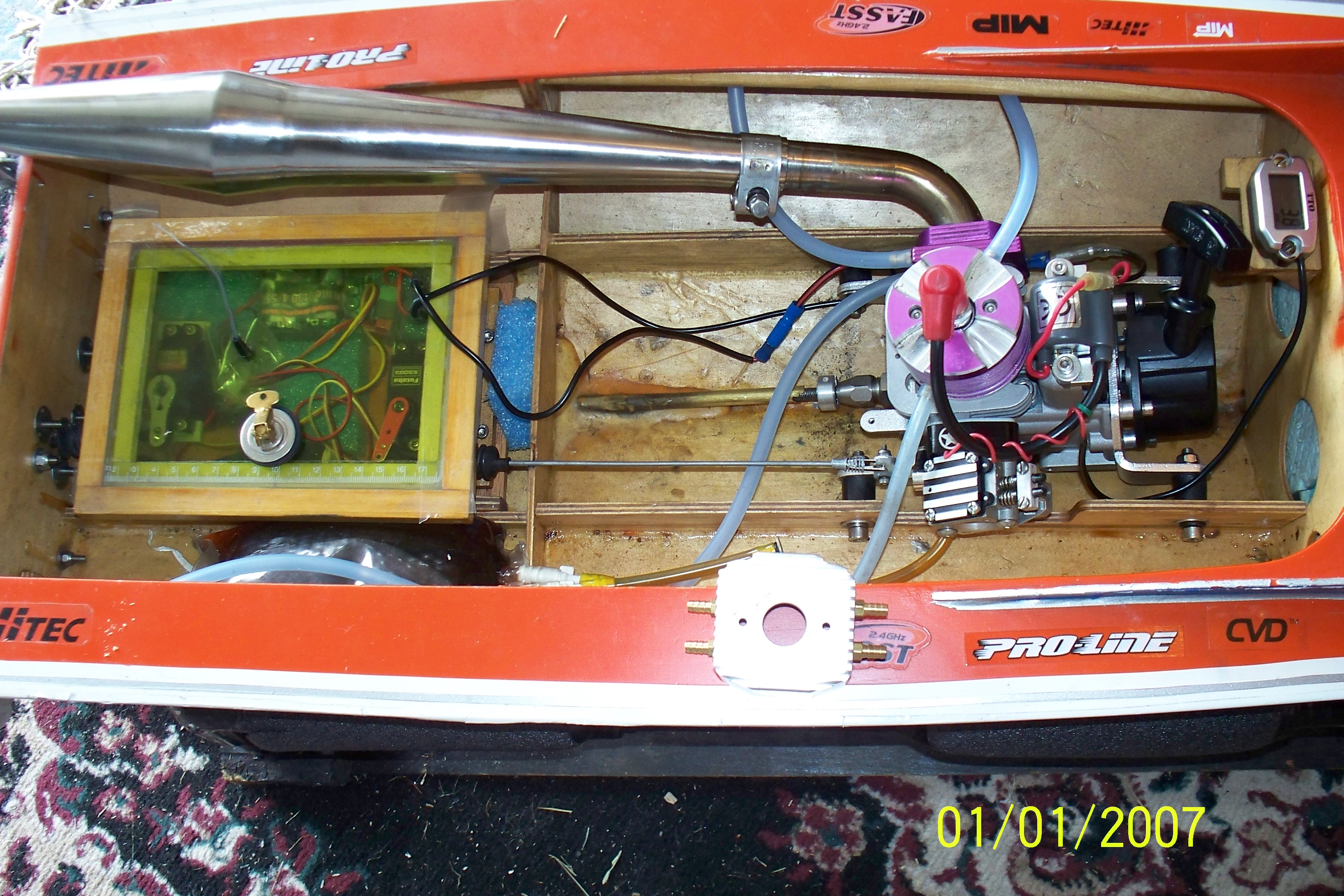

315neil1007 replied the topic: Re: What boat to build?
You did say build so here's a good one to build $59.00 I won District 1 gas Mono champion with one this year. And the build is what it said Easy to build. zippkits.com/~zippkits
