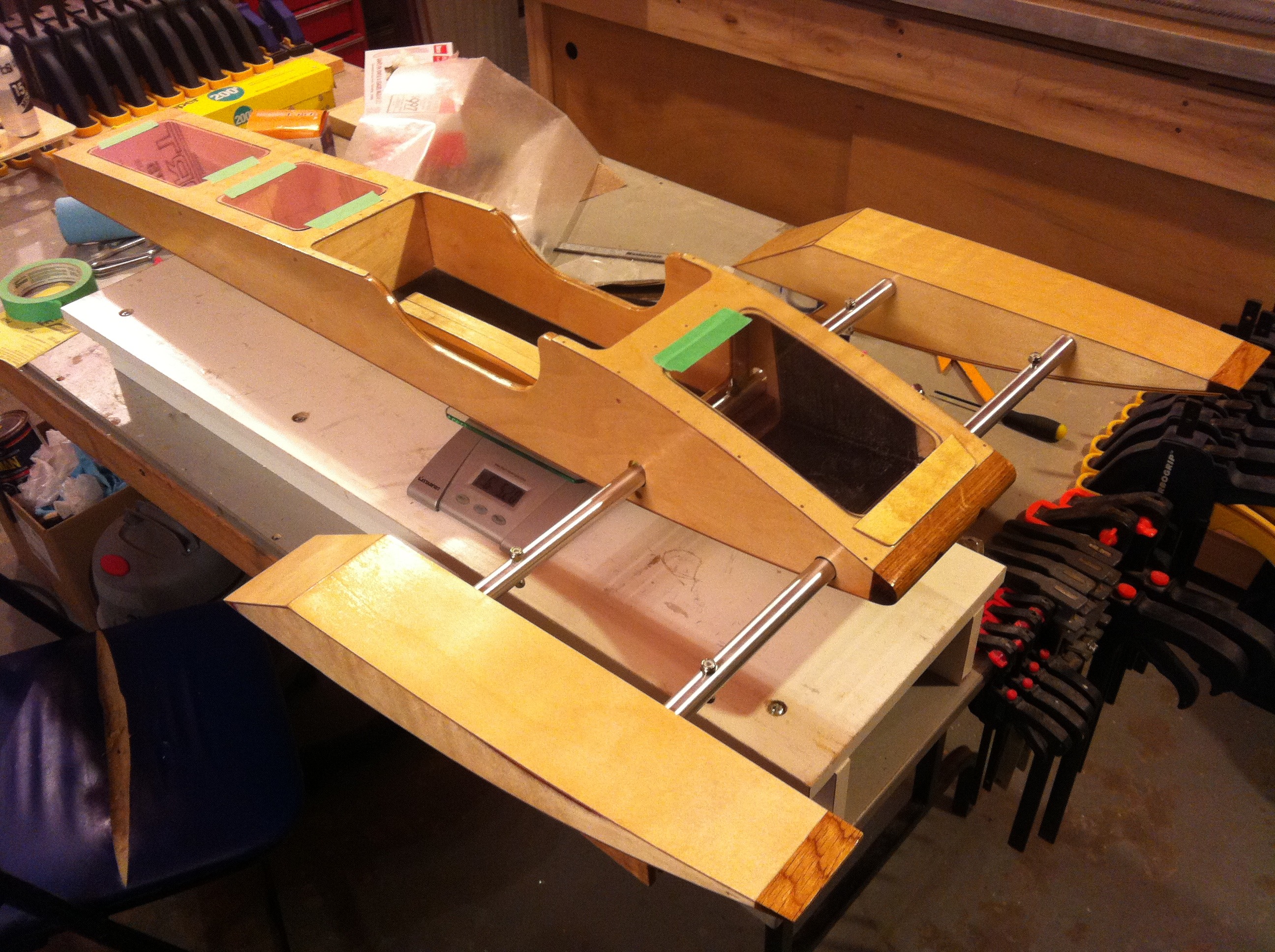

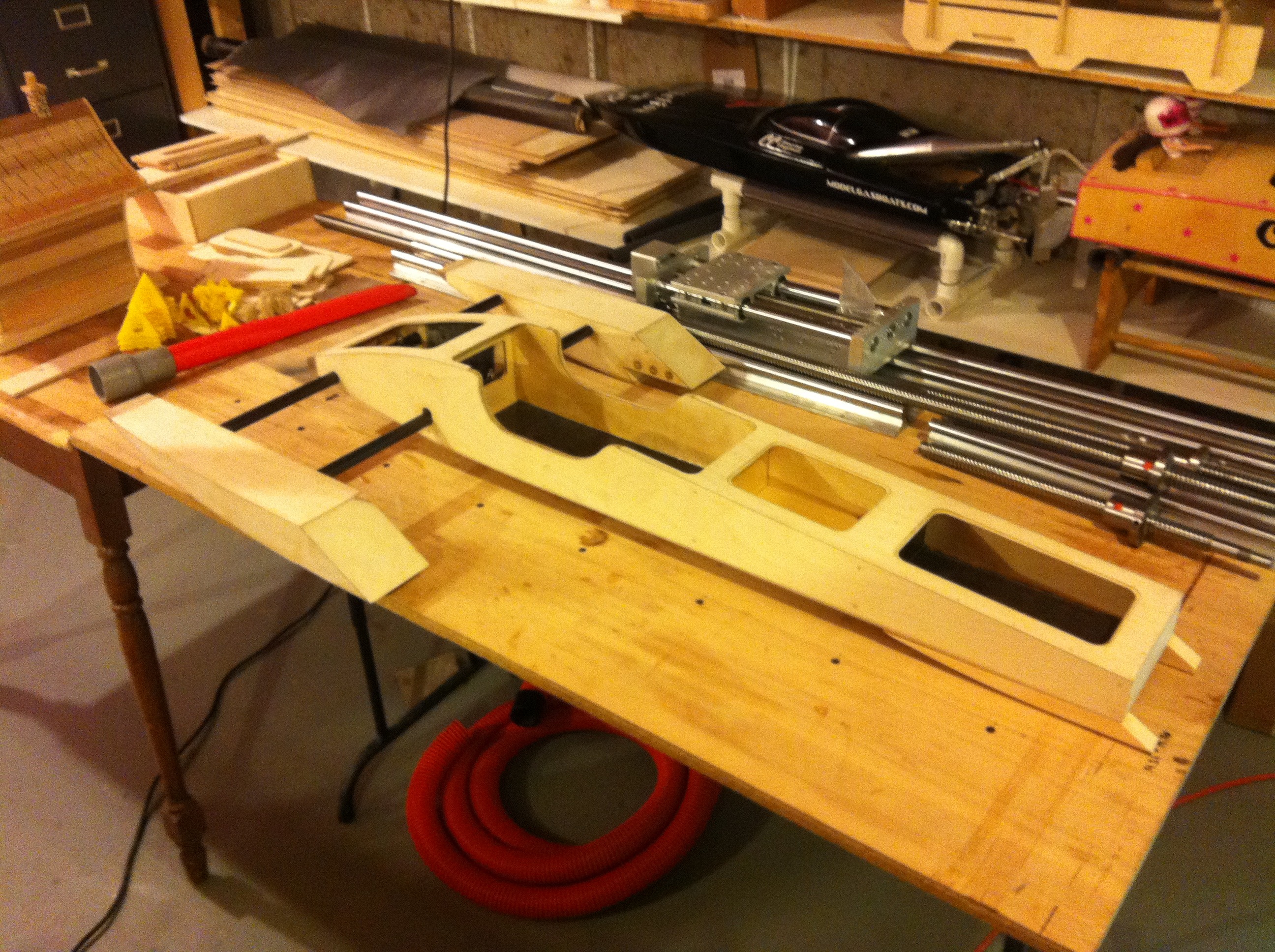

marc replied the topic: Antron Brown's Twin Inline Warpath Rigger in the building...
A few pics of the boat finished.

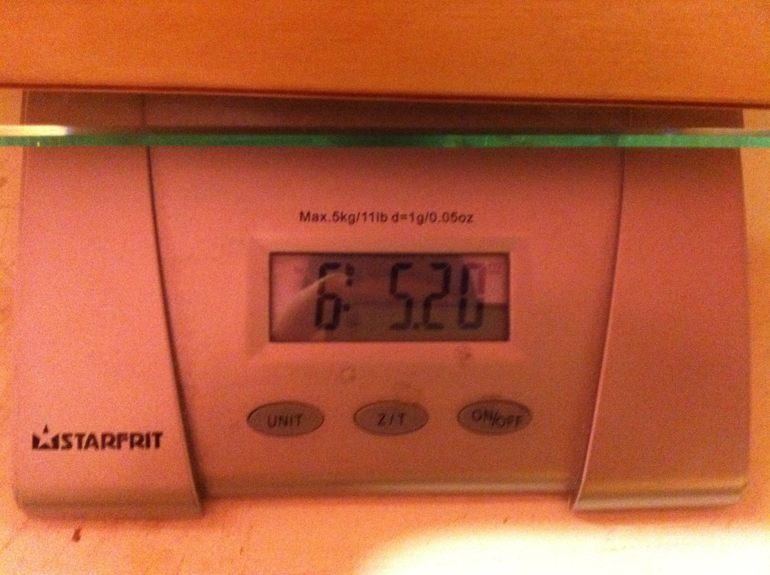

mtchbnntt replied the topic: Re: Antron Brown's Twin Inline Warpath Rigger in the building...
Nice job Marc! Can't wait to see AB running this one, Really light! And u kno its going to get a nice paint job to match his others. Good job, see ya.
Thanks I'm looking forward to seeing it when it's all done up and running!
It did turn out pretty light, but let me say I built it very strong nonetheless. Been learning stuff as I build more and more of these riggers. The carbon for example makes the tub so stiff it's amazing. Ties in the side to the bottom too. The entire top sheeting is pinned. The transom is pinned and CF reinforced. Every single glue joint on the boat is West System Epoxy or T-88 structural epoxy. Takes a lot longer to build but in the end it makes for better boats.
