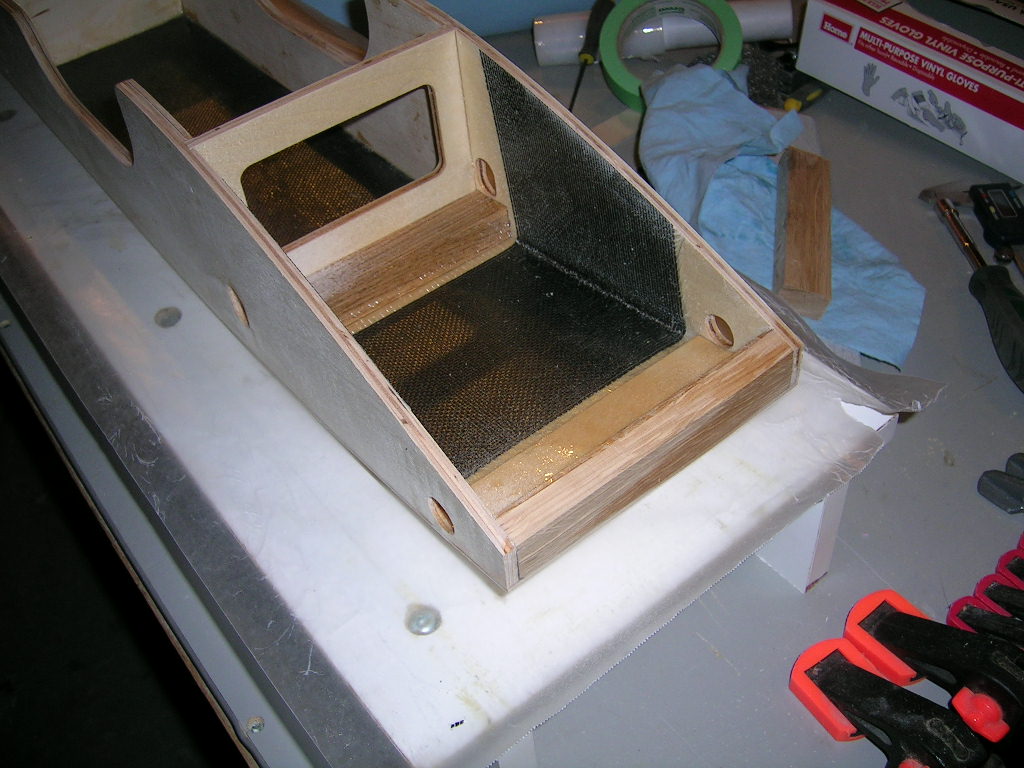

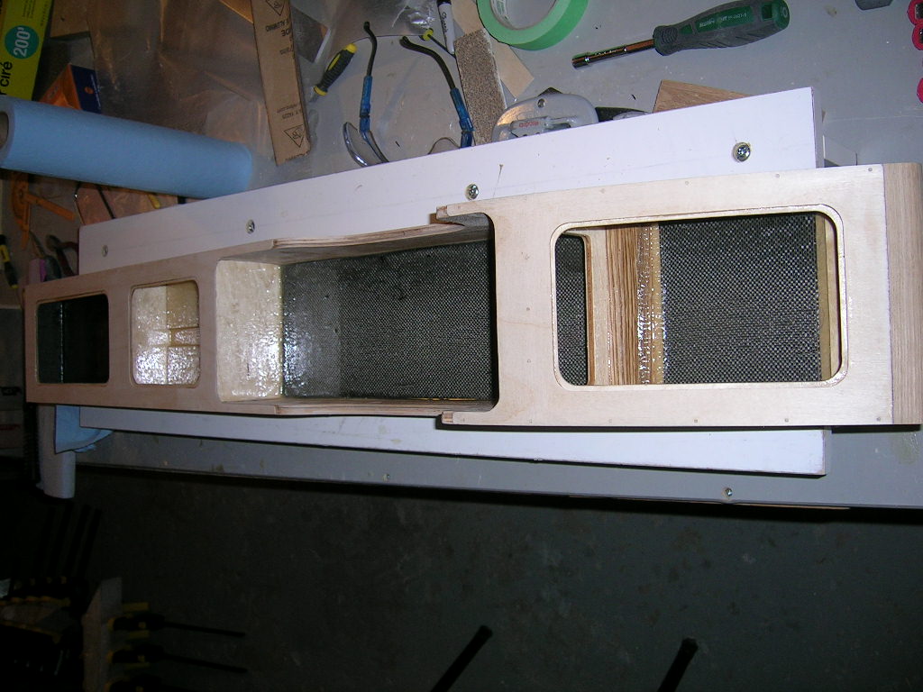

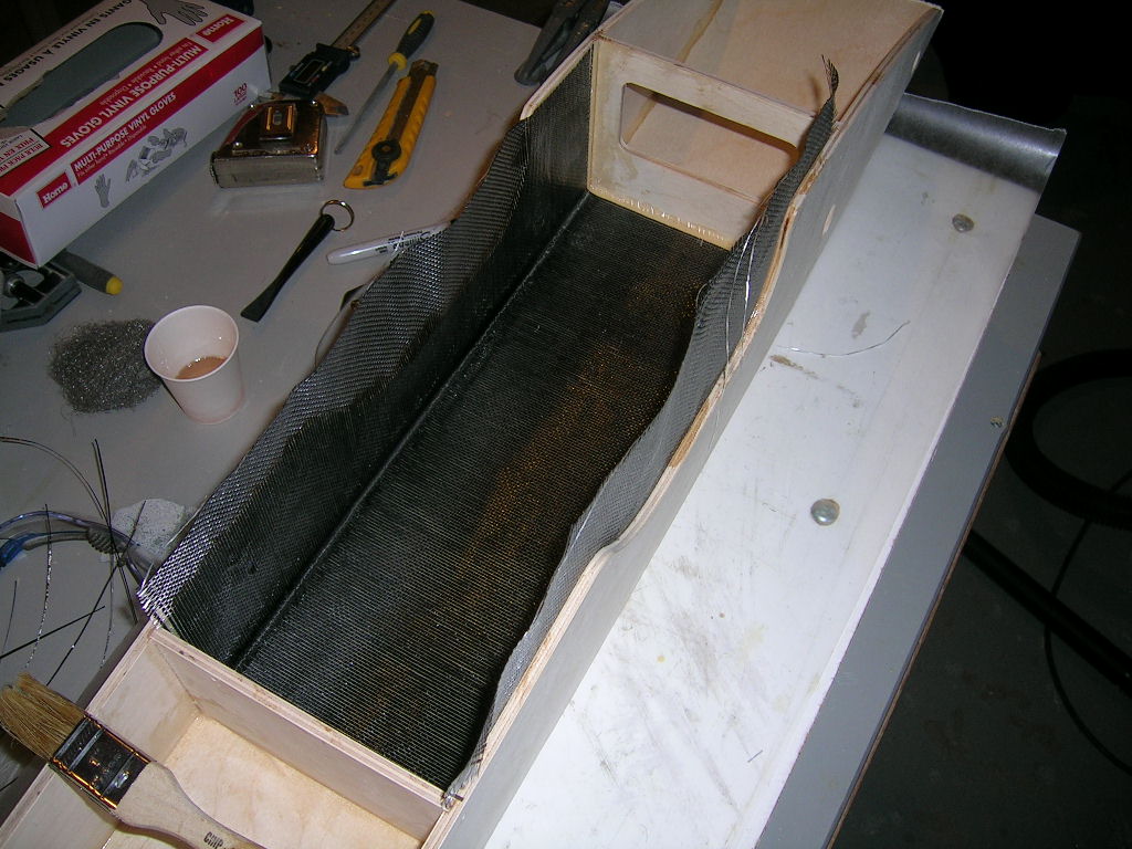

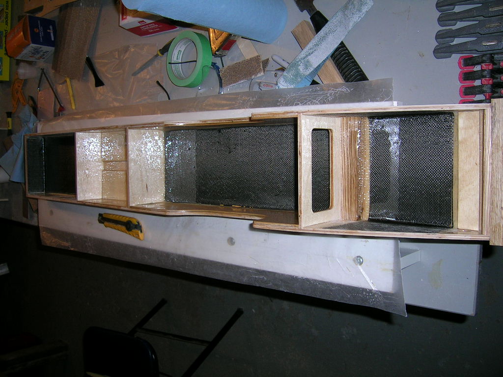

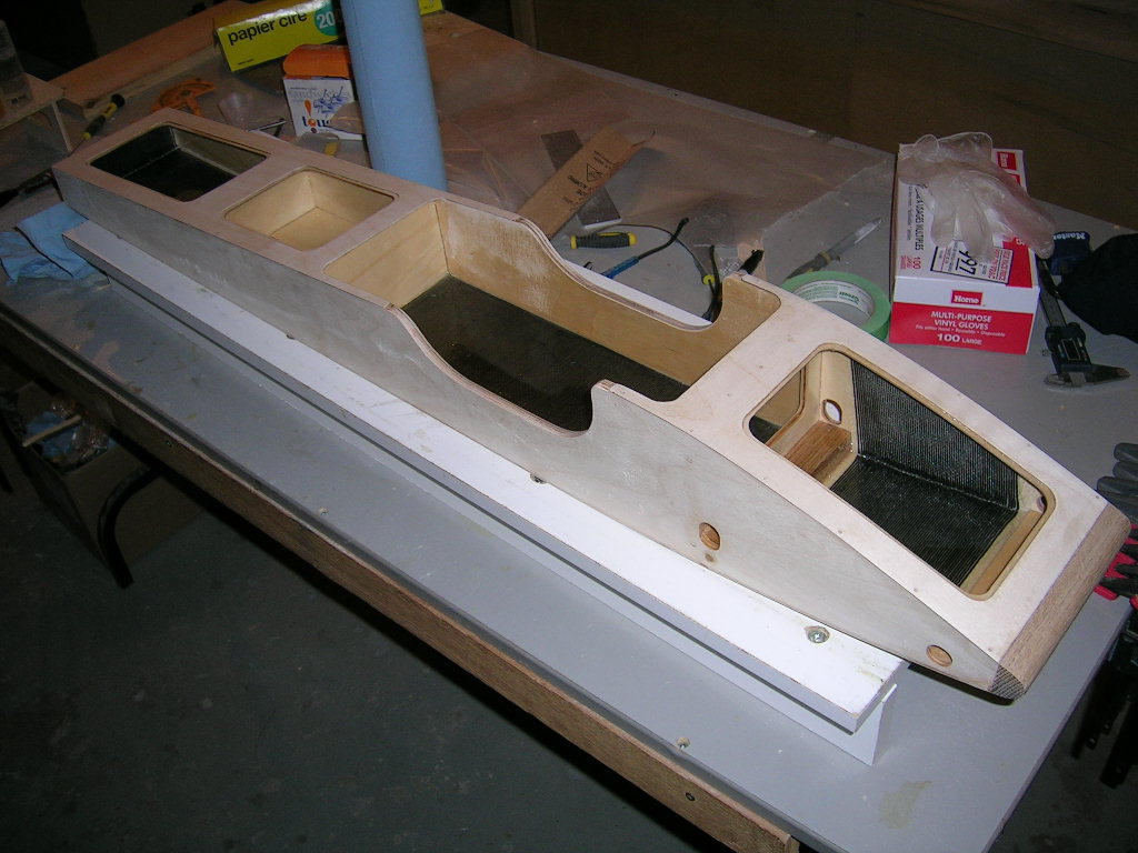

This one is being built for Antron Brown... its is a Warpath on steroids! :) It will be powered by a CC modified twin inline Zenoah with billet bottom end and some goodies!

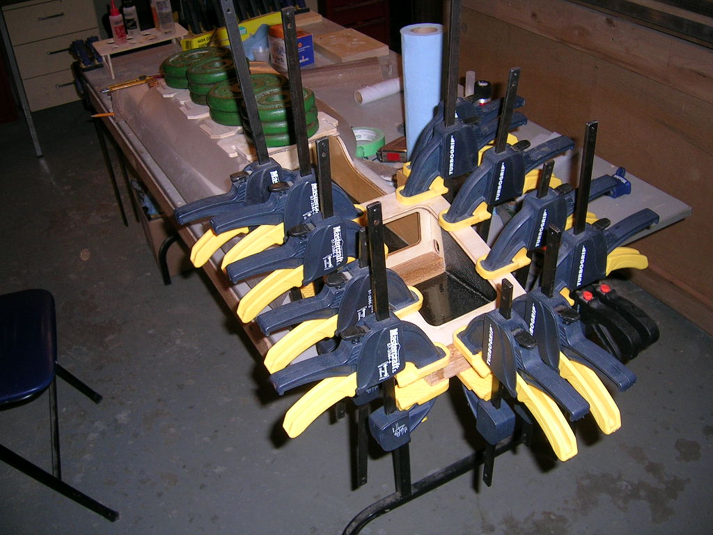

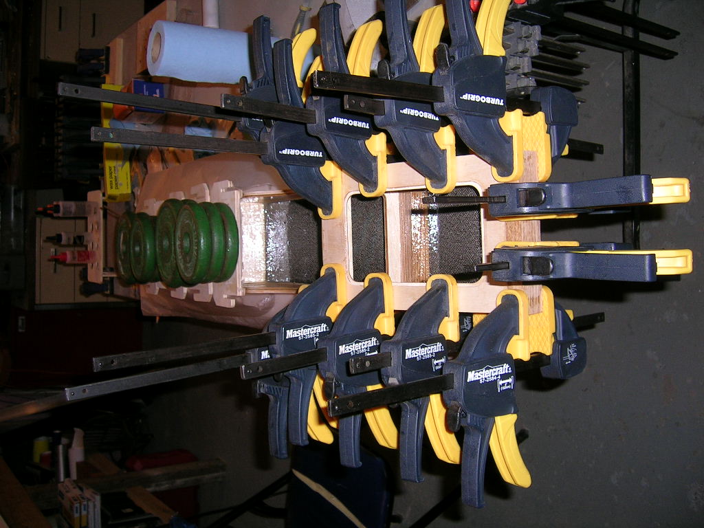

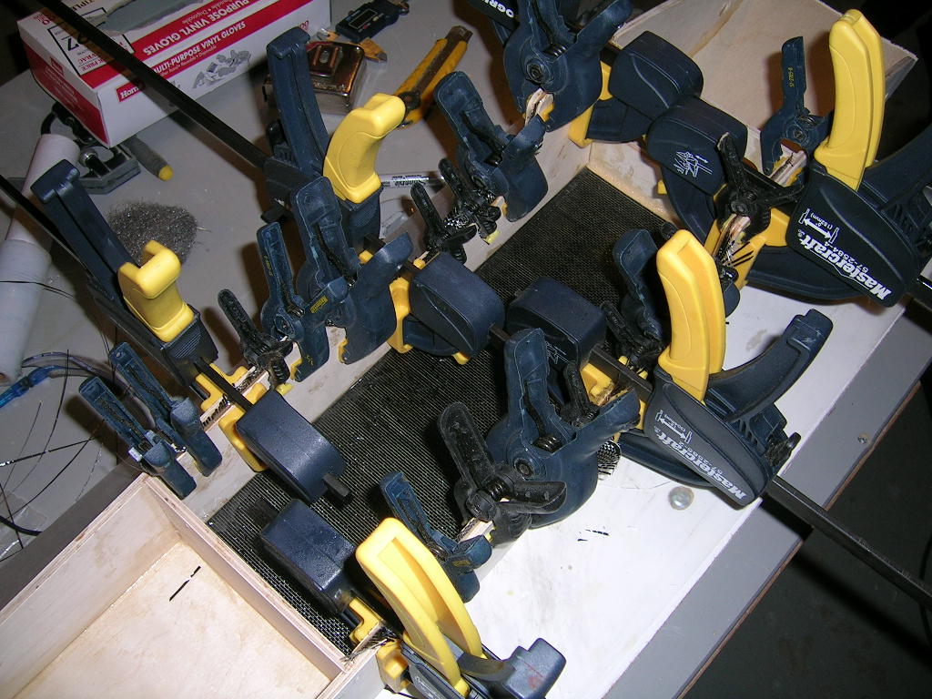

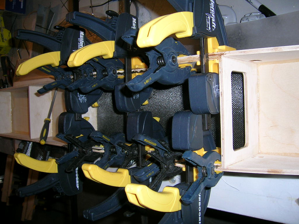

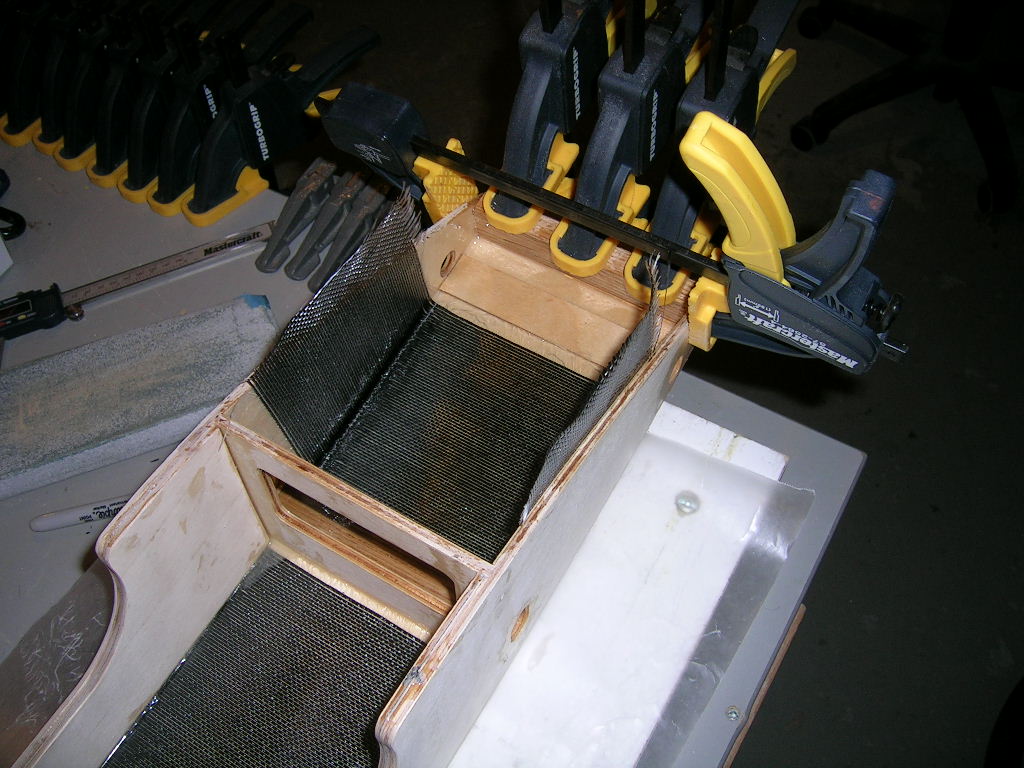

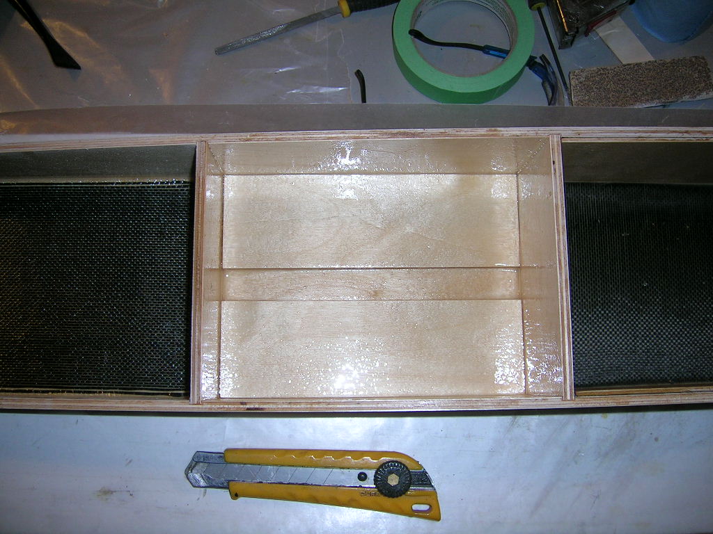

The tub is longer and slightly wider than the single version and reinforced with unidirectional carbon fiber cloth. The engine bay has added 1/8" doublers, making the sides 3/8" thick with the carbon going up the sides sandwiched between the plywoods. Inner width in the engine bay is 5". The bottom sheeting is 1/8" instead of 1/16". The bulkheads and top sheeting are all dowel pinned as is the oak support block for the rear boom tube. The tub is VERY stiff and true.

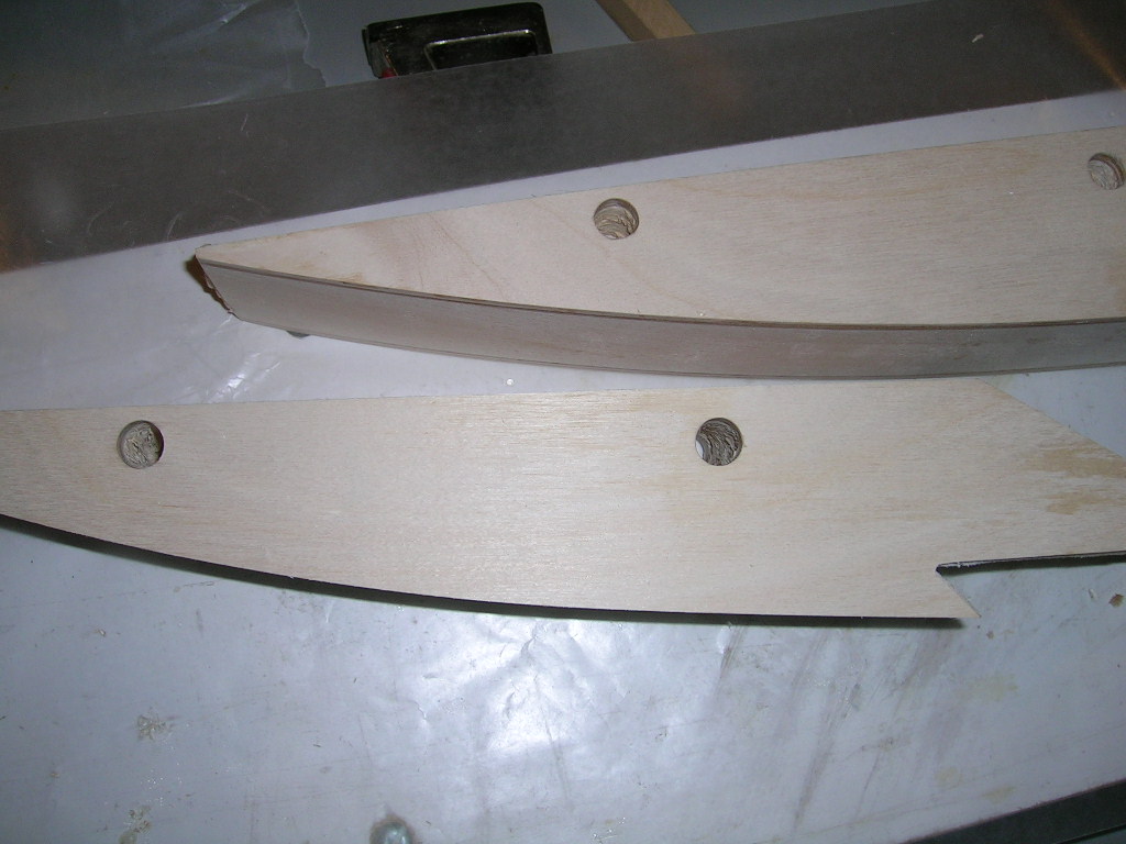

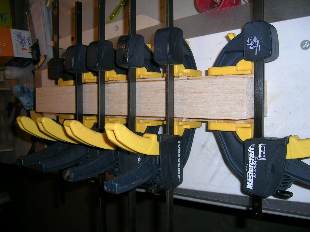

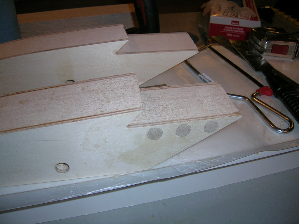

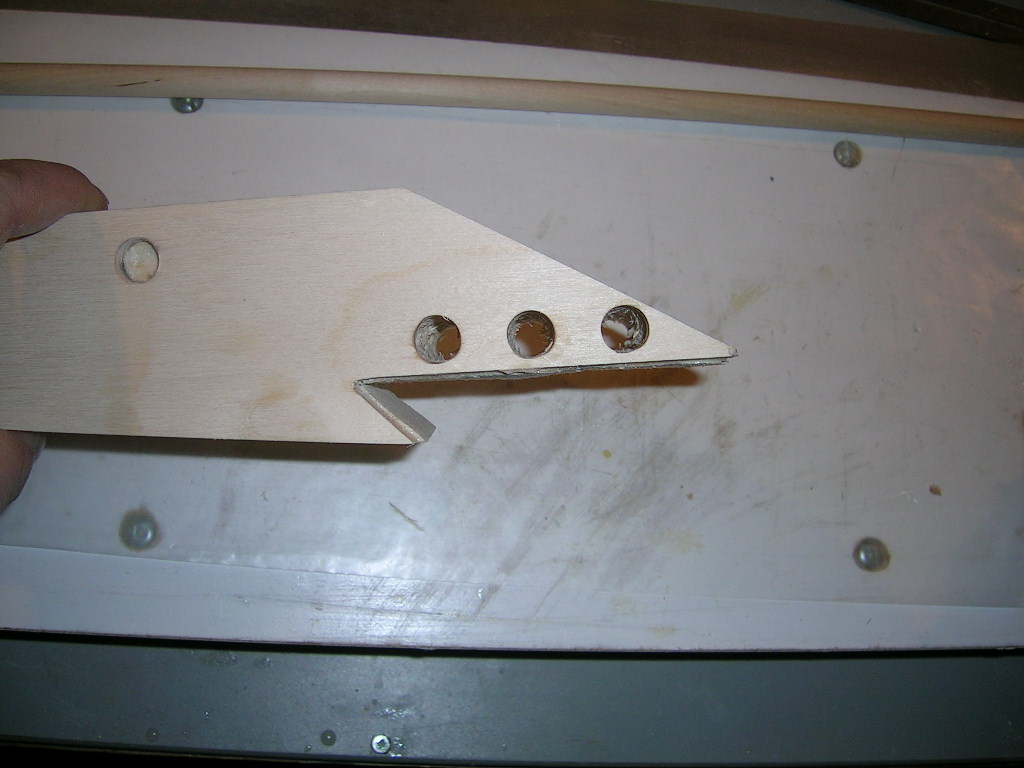

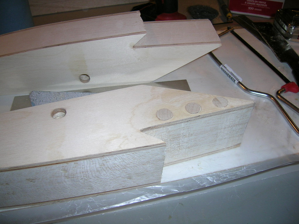

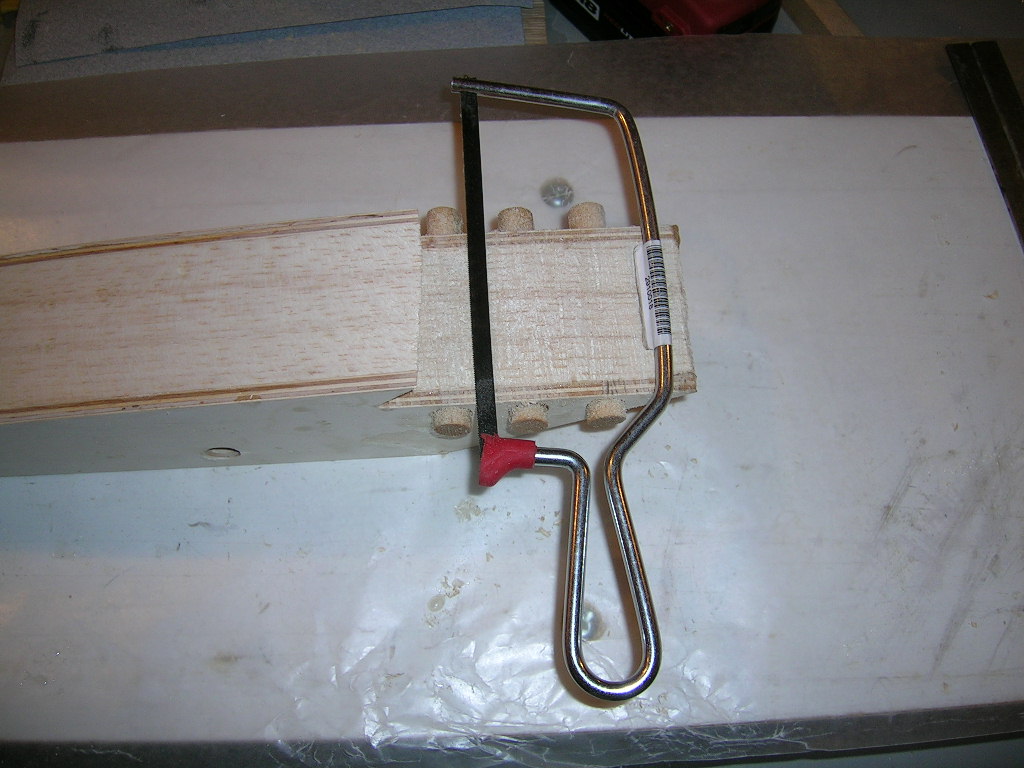

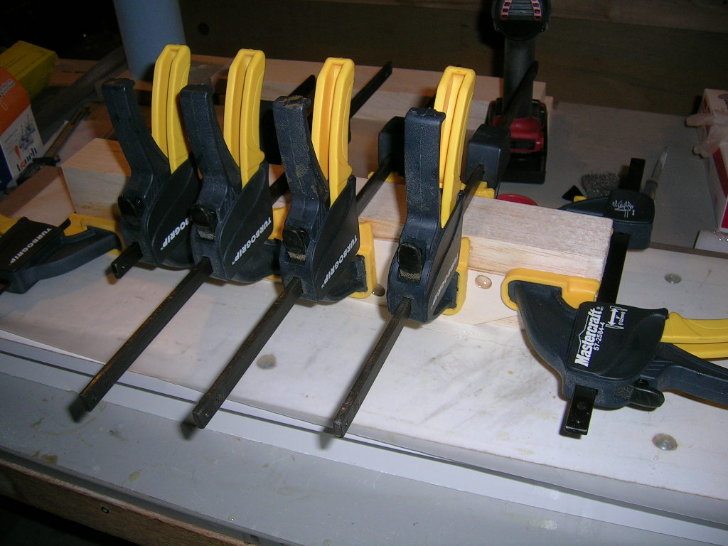

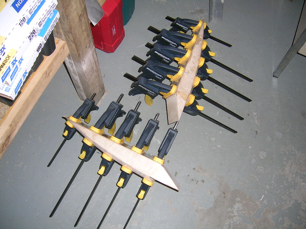

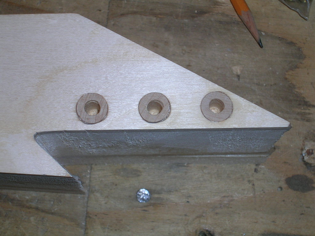

The sponsons are solid balsa core with new mods done to the turn fin sponson. The threaded inserts for the turn fin now go inside large hardwood dowels that span the two 1/4" sponson formers making them very strong. This mod will be done to future Warpath kits also. The build is nearing completion...I will post more pics as I progress. :)
