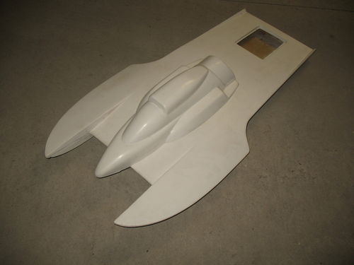

Hi guys
going to begin this project does any one has special instrucions????
Regards
David
#19692
Mercury94 replied the topic: Re: Insane Hydro 2
On Insane hulls I would make sure that the sponson ride surfaces are straight and sharp. Any rounded edges or trailing surfaces will cause parasitic drag. I also put a straight edge on the inside of the starboard sponson and make sure the turn fin runs true.
