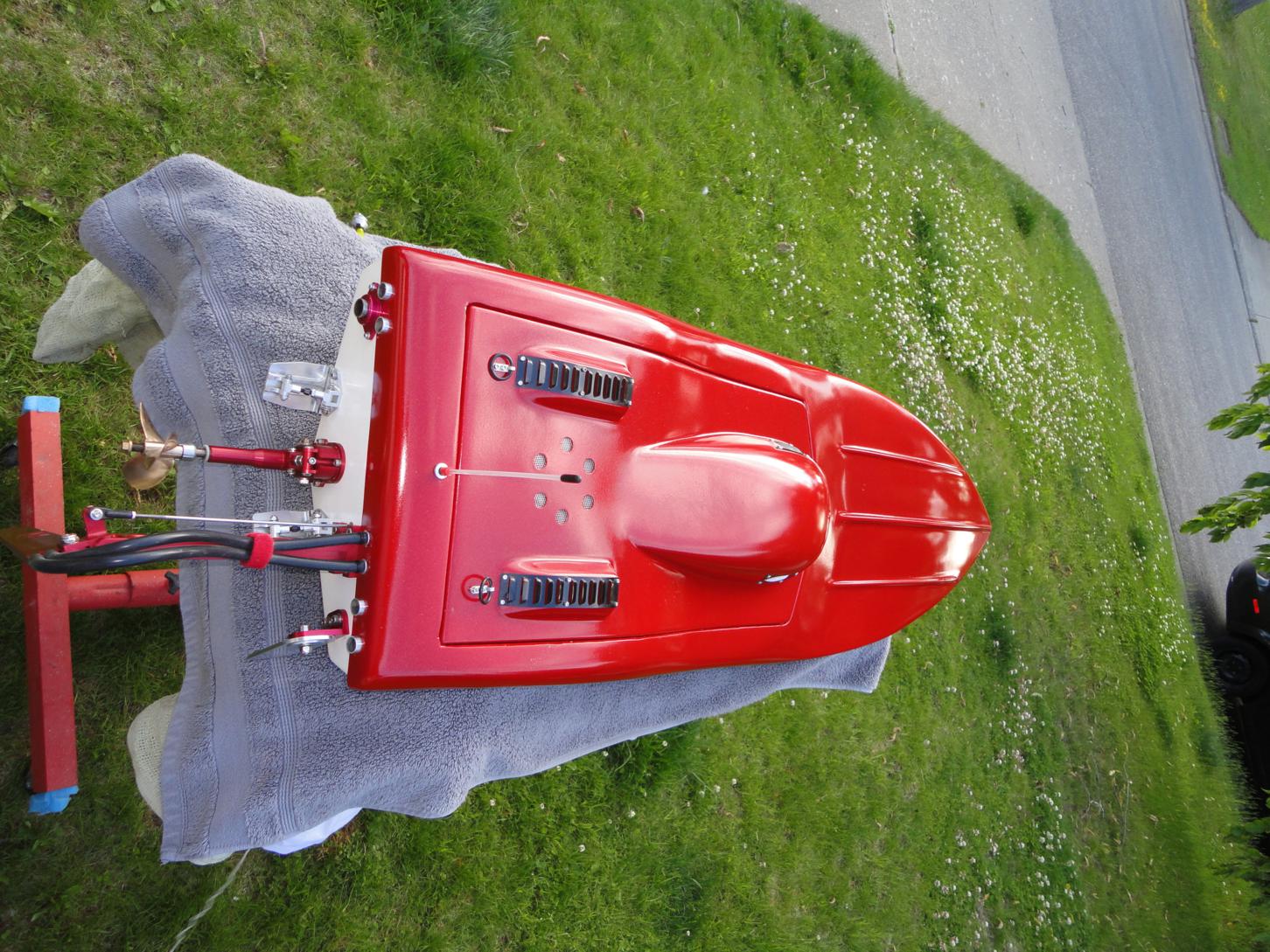

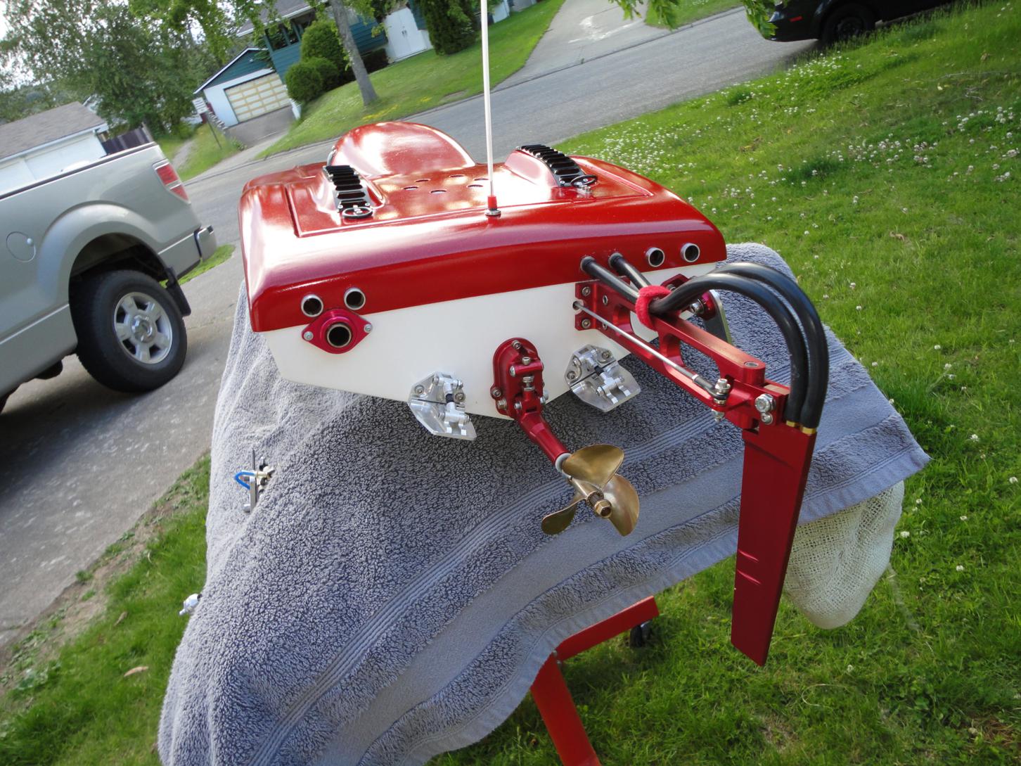

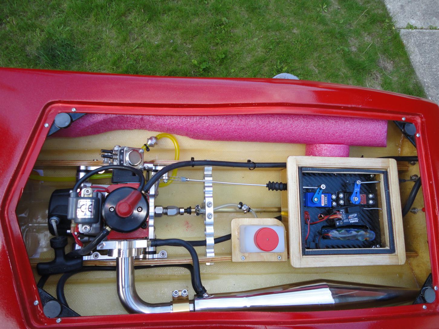

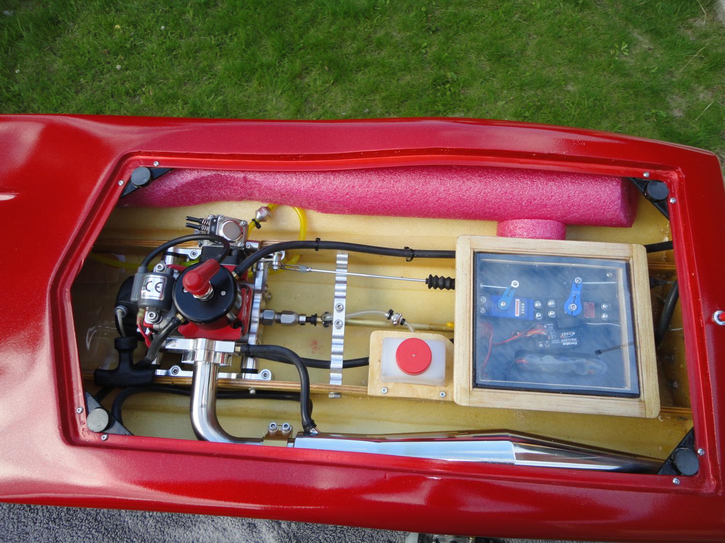

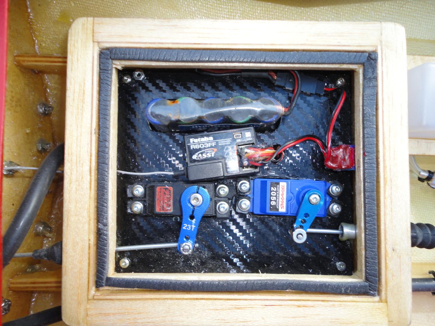

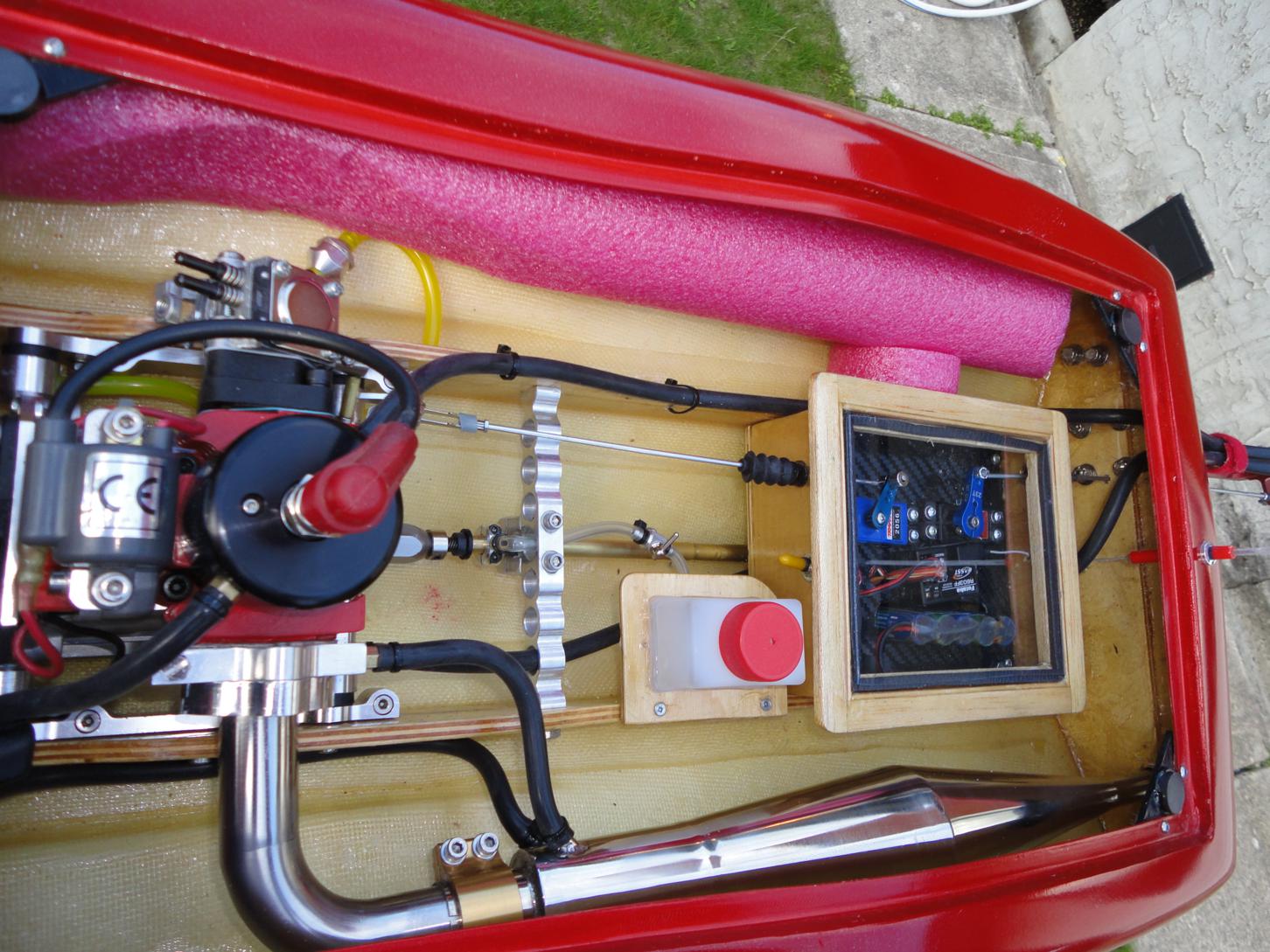

I was bored - my buddy wanted to play with us --- so
- Rico Off shore 48" (Thanks Curt)
- Candy Apple Red / Caddy WHite - metallic clear coat --- no decals

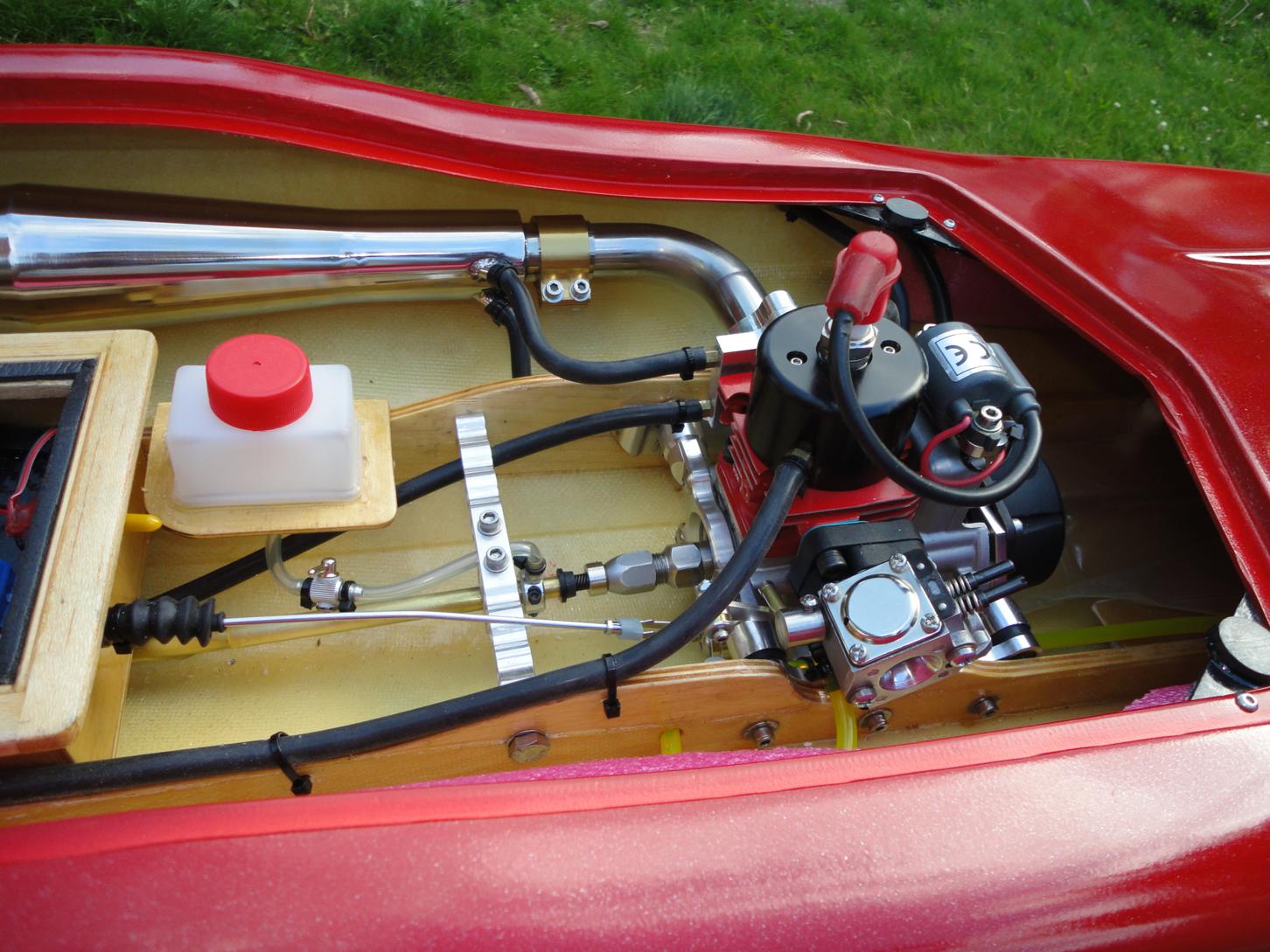

- Zen 26 - ONB top - Lt Wt Piston - turbo crank - cleaned case - 3rd bearing -
- Mild 992 - cleanup some - (thanks Hendo) or - WY from UK w/HOR intake - old Arrow Shark SS pipe to test with

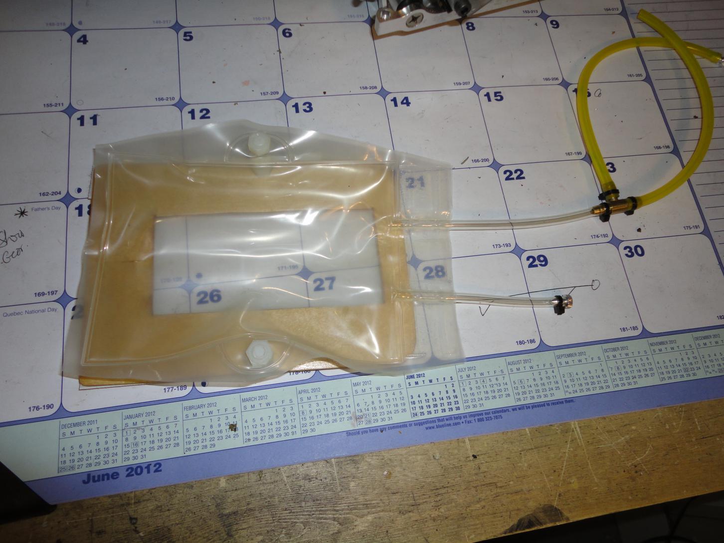

- Mod 'T' bar - Oiler and Tank / Valve
- Speed Master - Rudder 6" - Gas BBl Drive - Billet trim tabs
- Made servo box & wp switch - simple tape on lid

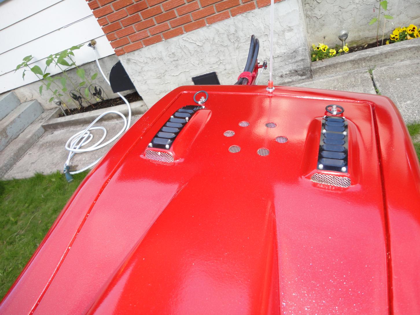

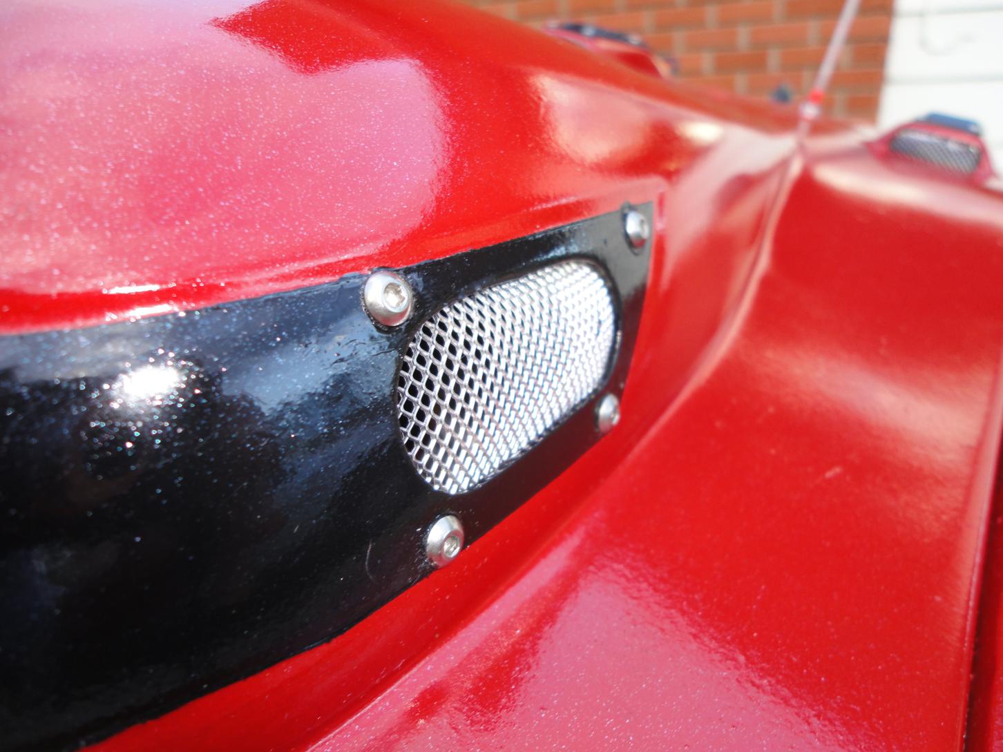

- Couple vents - and magnetic top
STill need to fit cable, add CF rod over steering rod and few things - then - zoom zoom (test maybe ??)
Later - thanks for looking

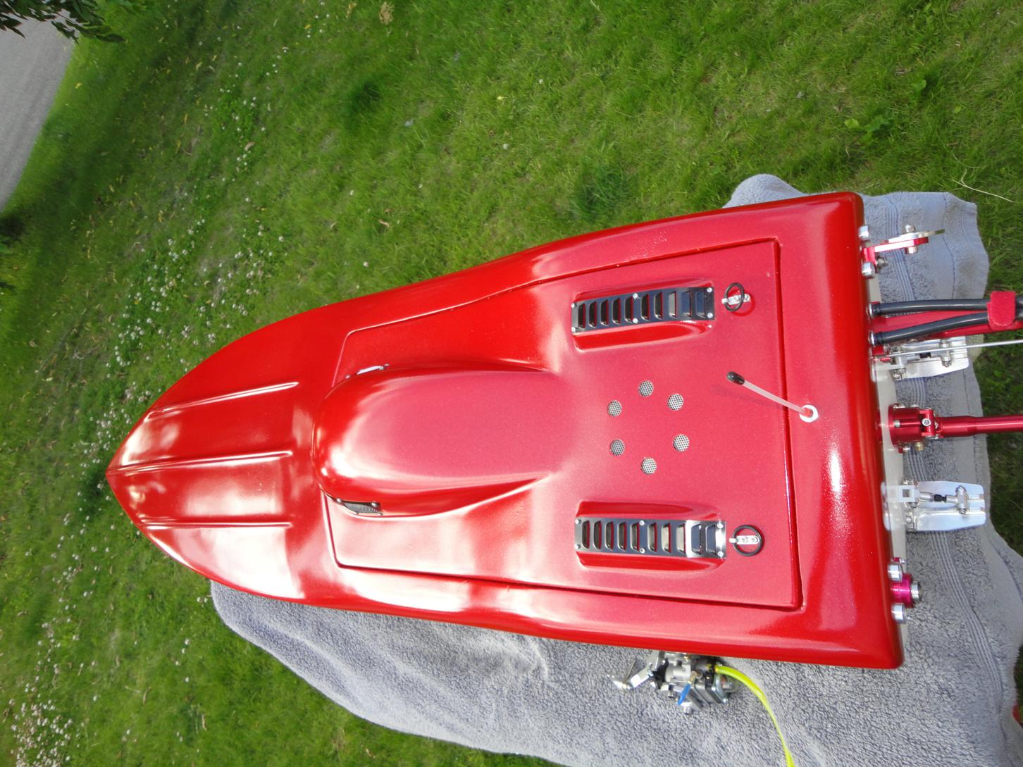

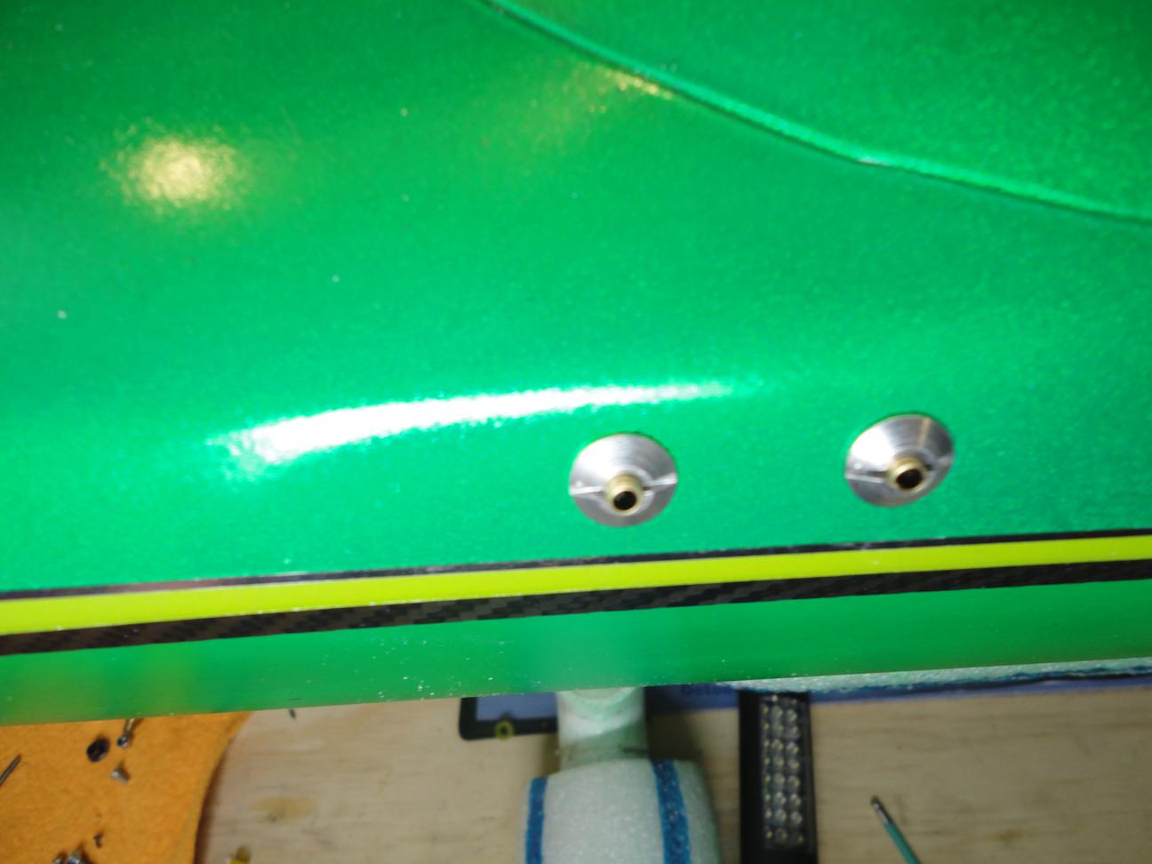

Canadian Hot Rod RC Boats replied the topic: Re: Simple Rico

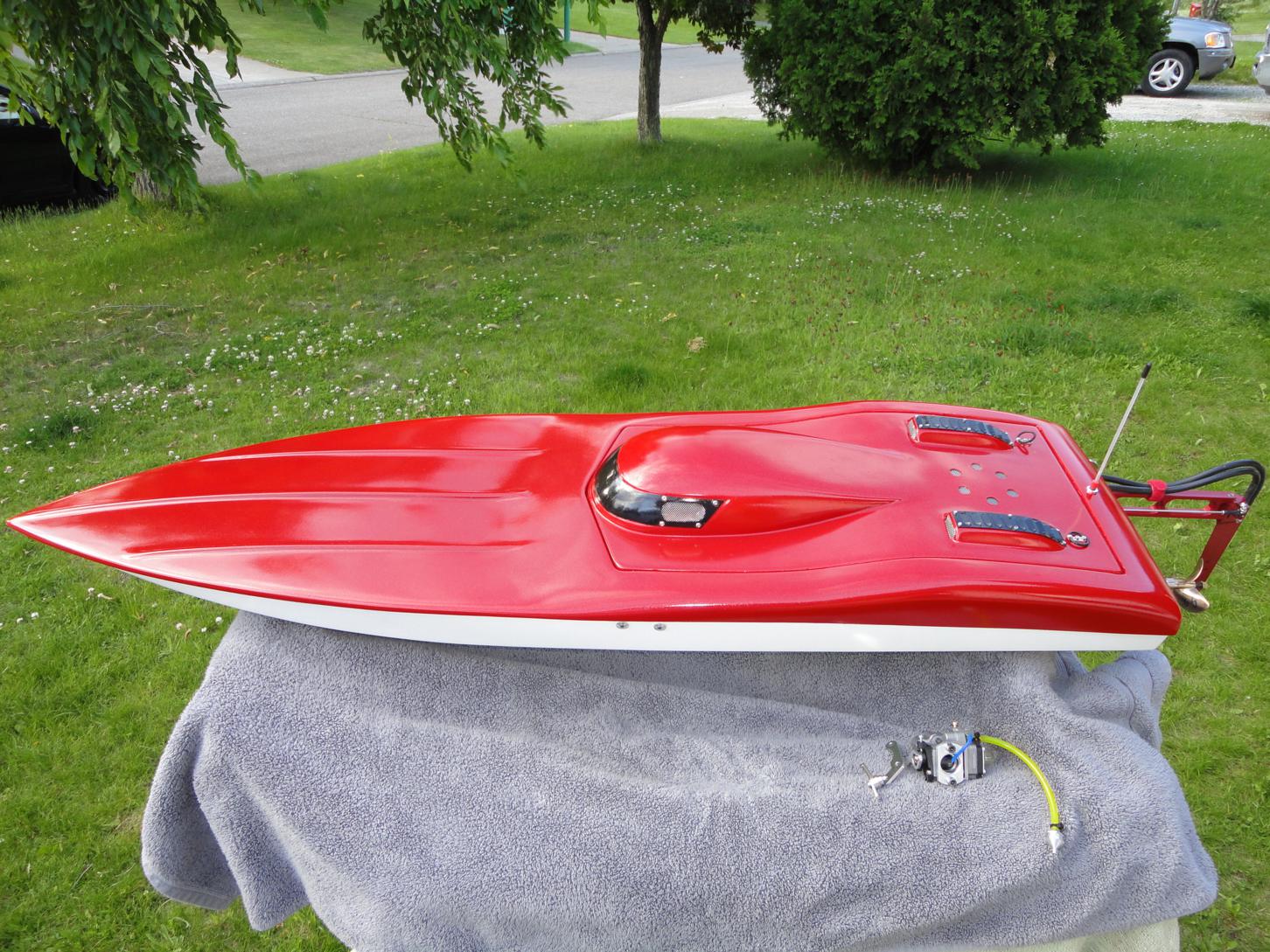

Took me a while but looks ok
Cloudy Day or it would shine better
