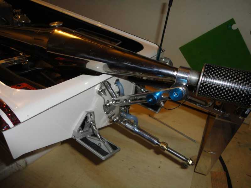

Talked with Andy for a while about a new project and picked this up today -- awesome work -- AC very cool very high quality

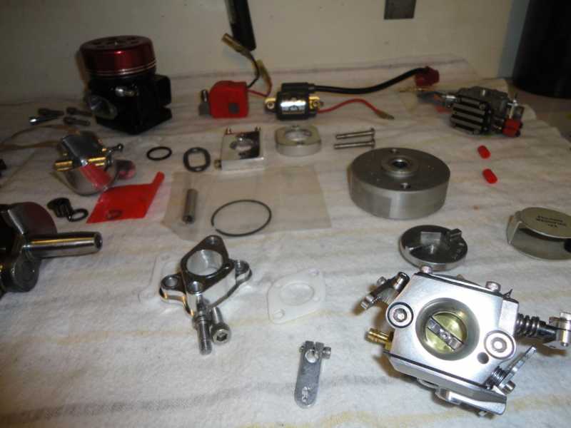

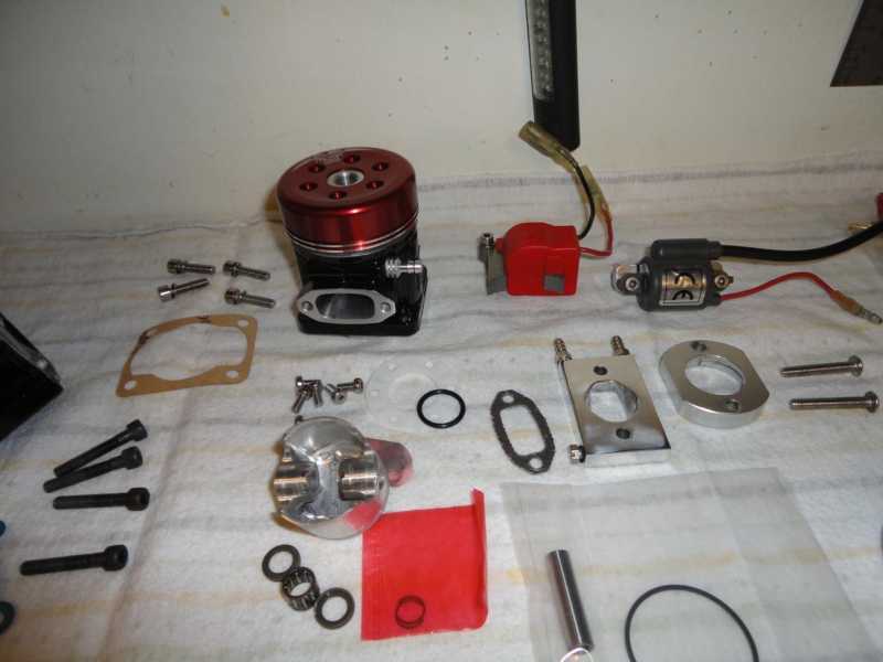

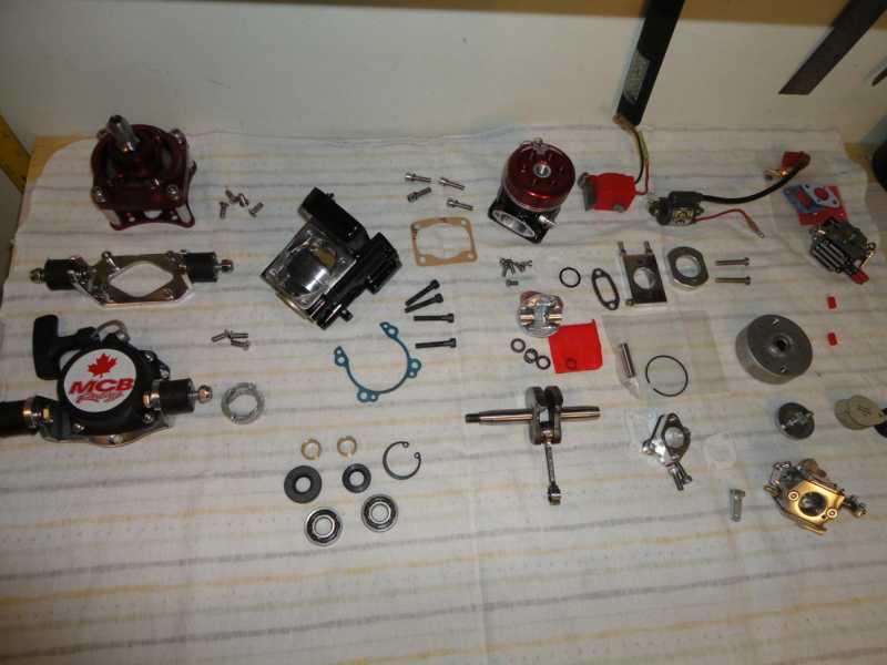

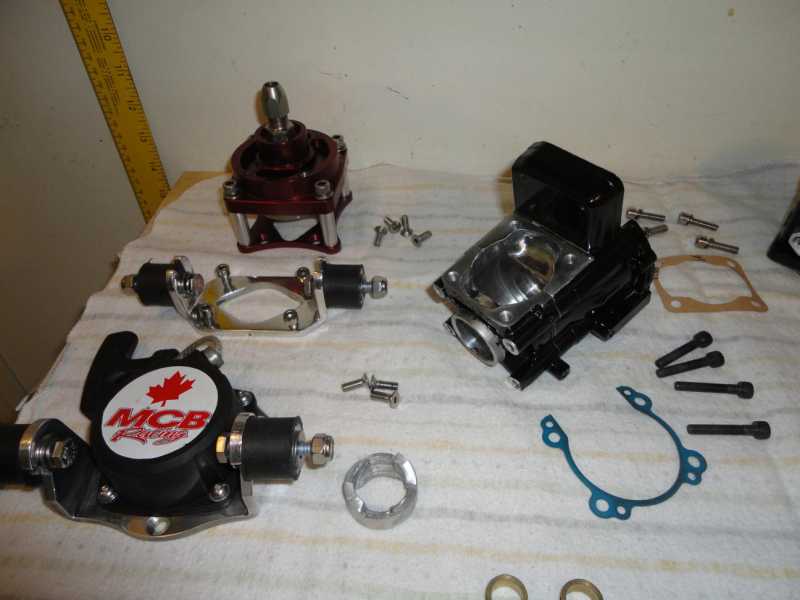

Canadian Hot Rod RC Boats replied the topic: AC S 45 Rat Finks little Brother

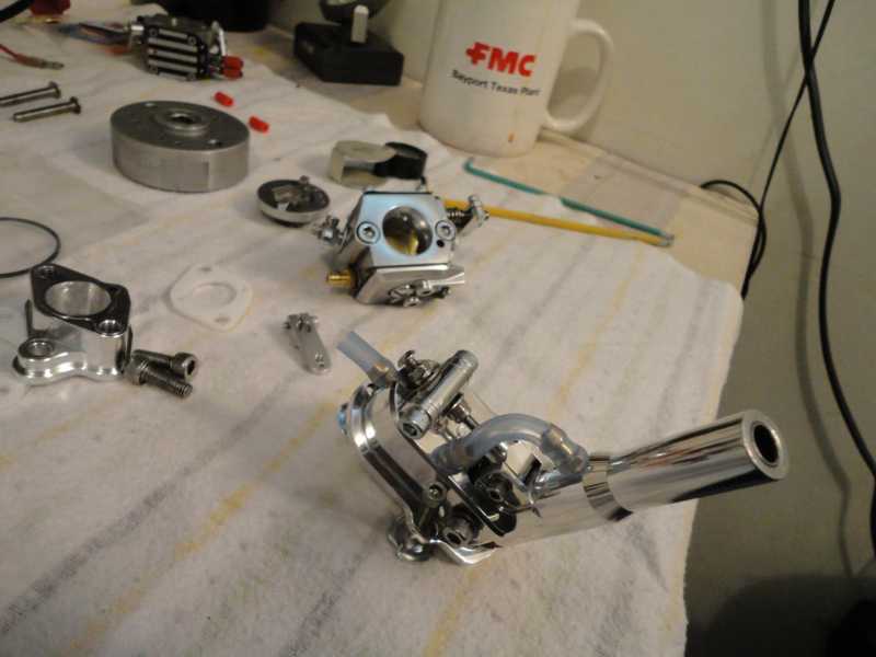

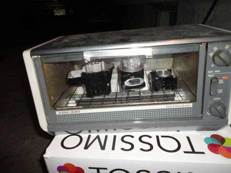

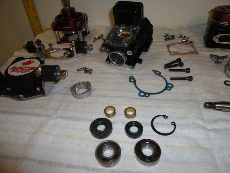

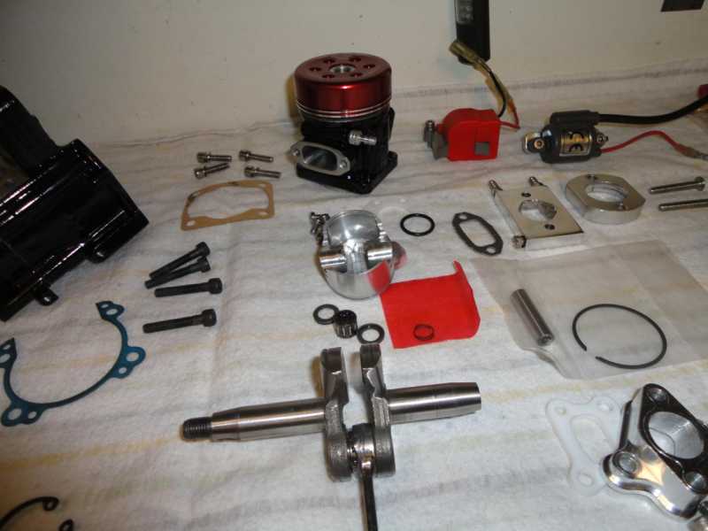

Well managed to squeeze enough together for a 'starter' motor for the S45
Zen Case - K30 (cleaned up ) - mod crank / 36mm piston - matched case - CC bearings / seals / zero drags - My 771 w/ SS batwing - Zen ignition
Maston mounts - carb arm - needle clamp case and cylinder are calipher paint - baked on
It's a start

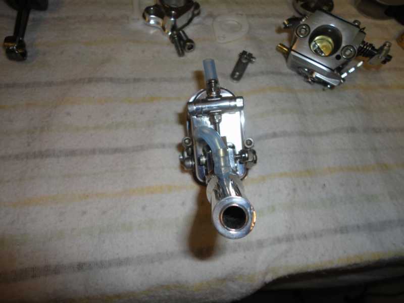

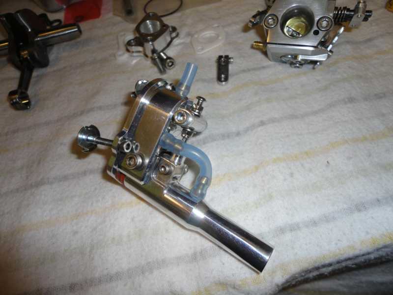

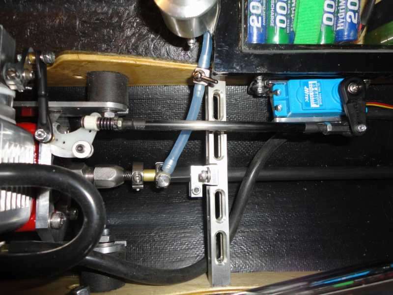

Had a little time so cleaned up my drive too
I use the "hollow" as small tank for ' *oil' trick I learned from a "Old AC guy" only he uses just a hose
Changed to press in oilite bushings

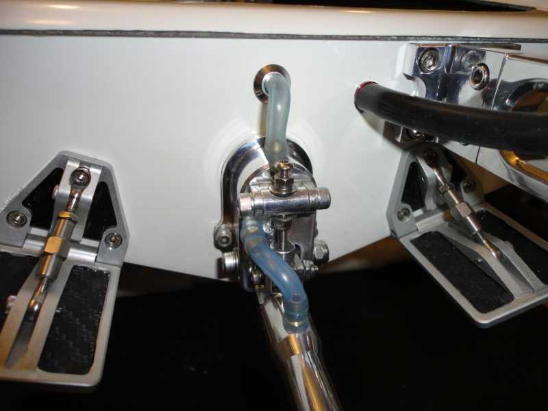

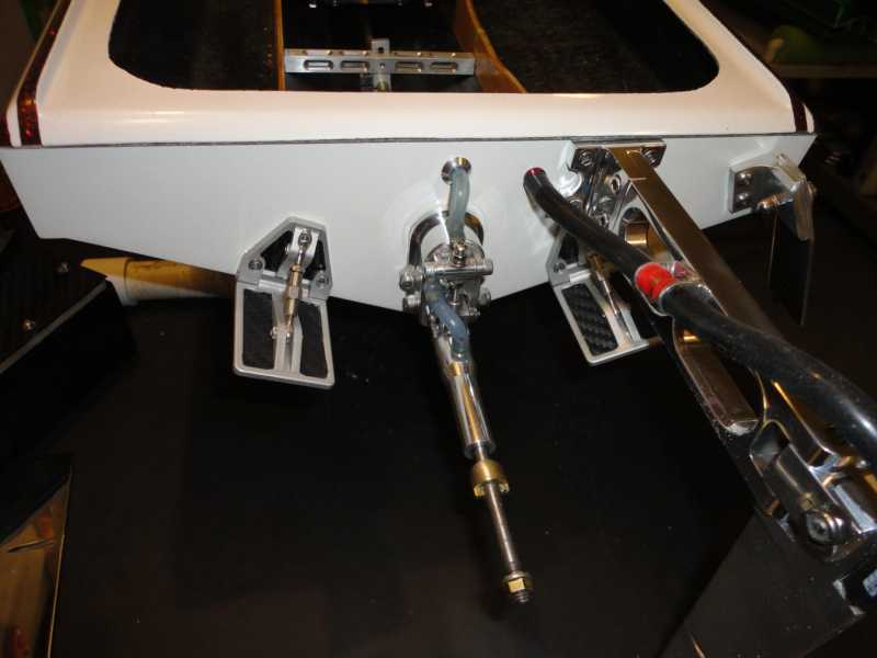

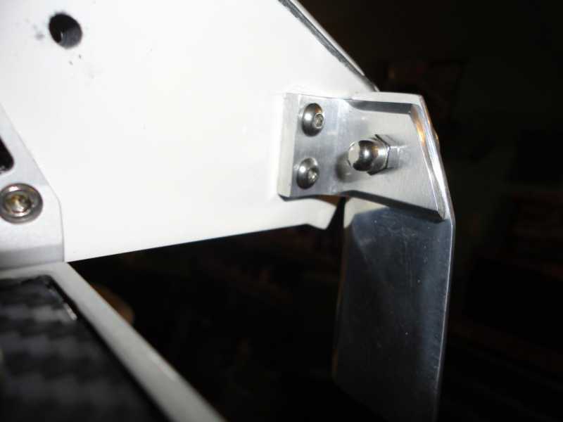

Managed to mount some hardware ;) :side:
#20732
marc replied the topic: AC S 45 Rat Finks little Brother
Very nice! I like the tabs!!!

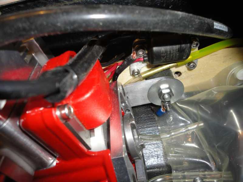

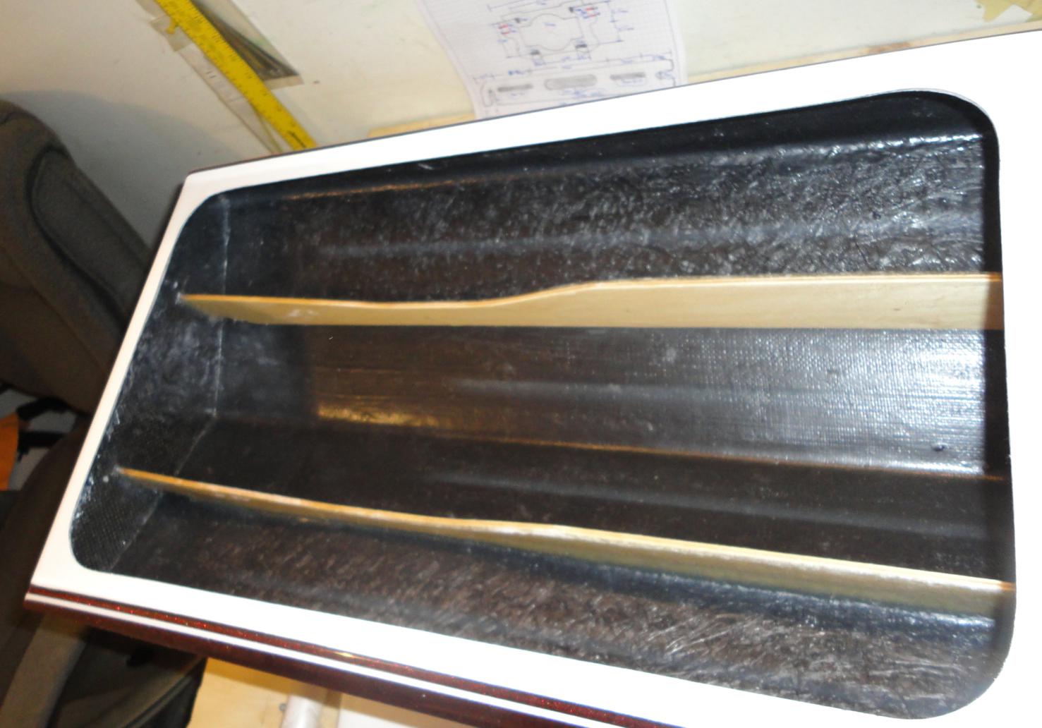

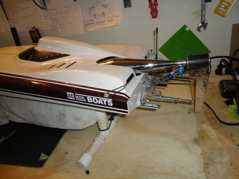

Couple more pictures

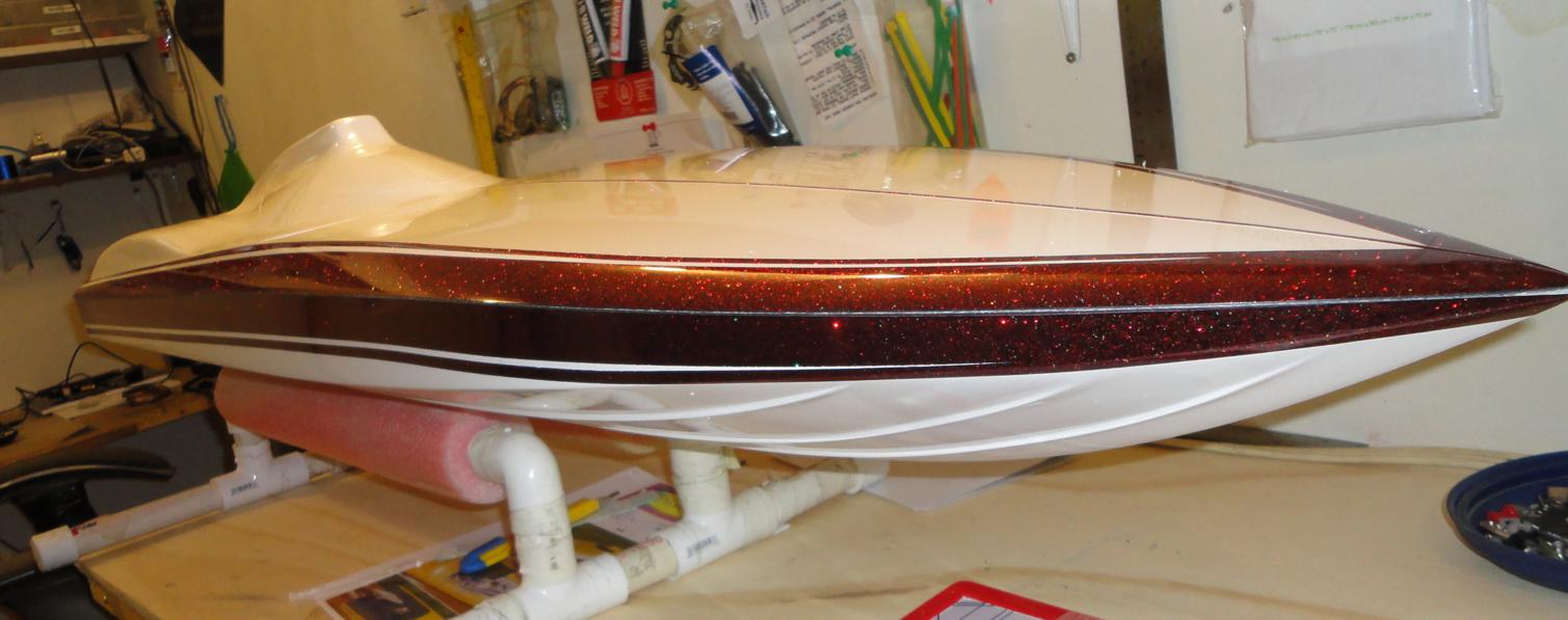

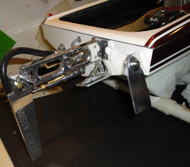

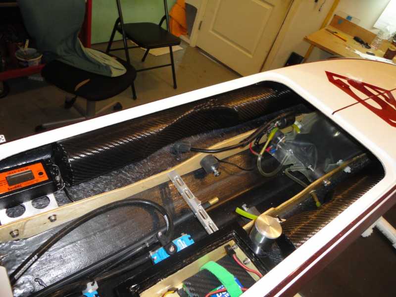

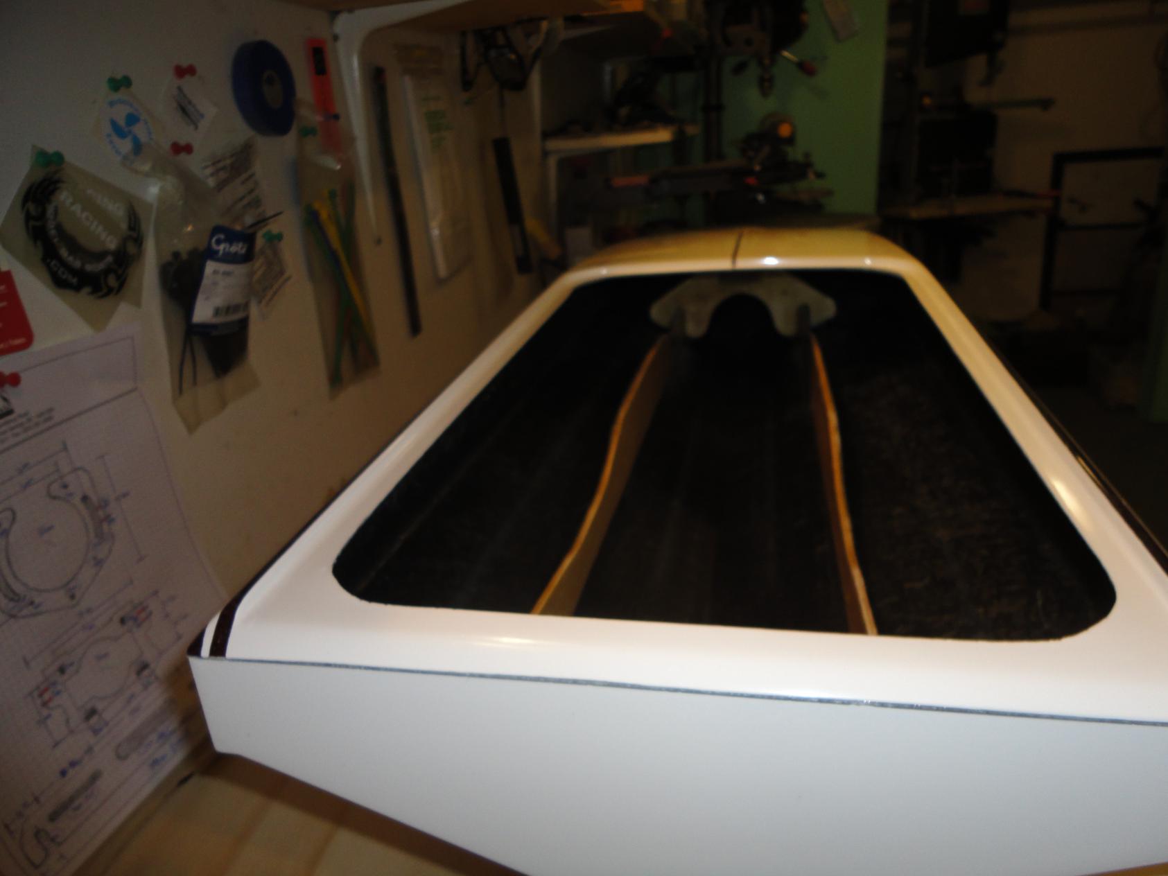

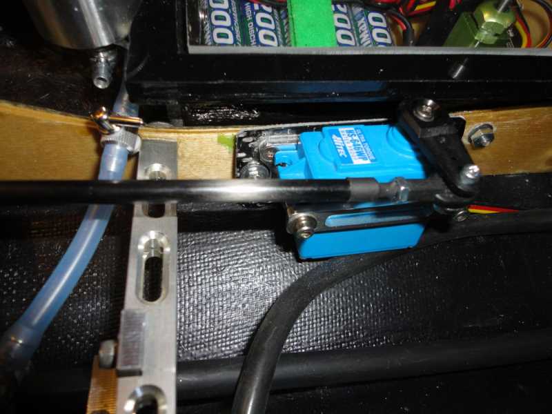

I did a little creative noodle covering
Couldn't stand to look at pink in the boat .....lol
I still have to heat the 3M with heat gun and work some wrinkles out
#20872

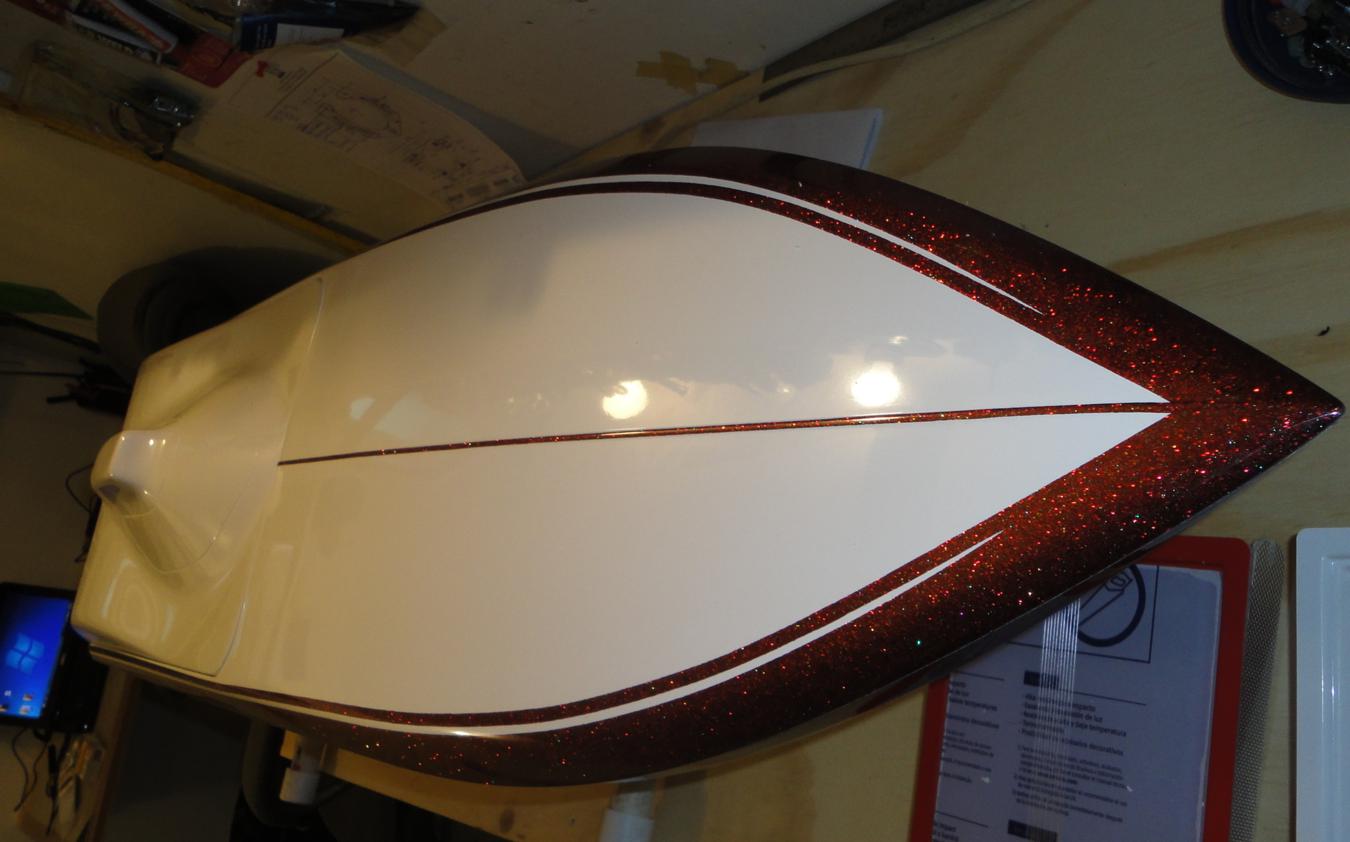

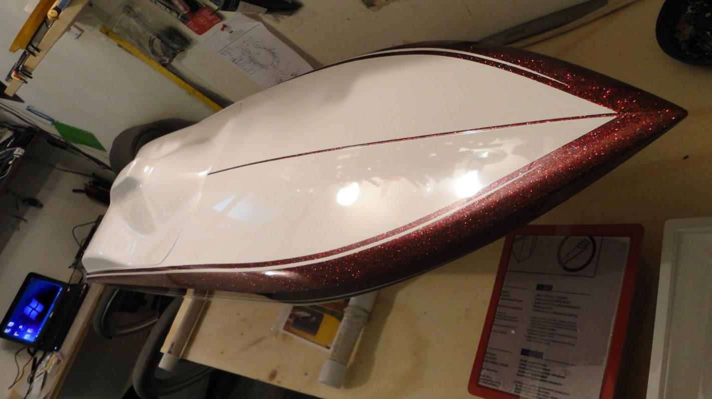

finished
